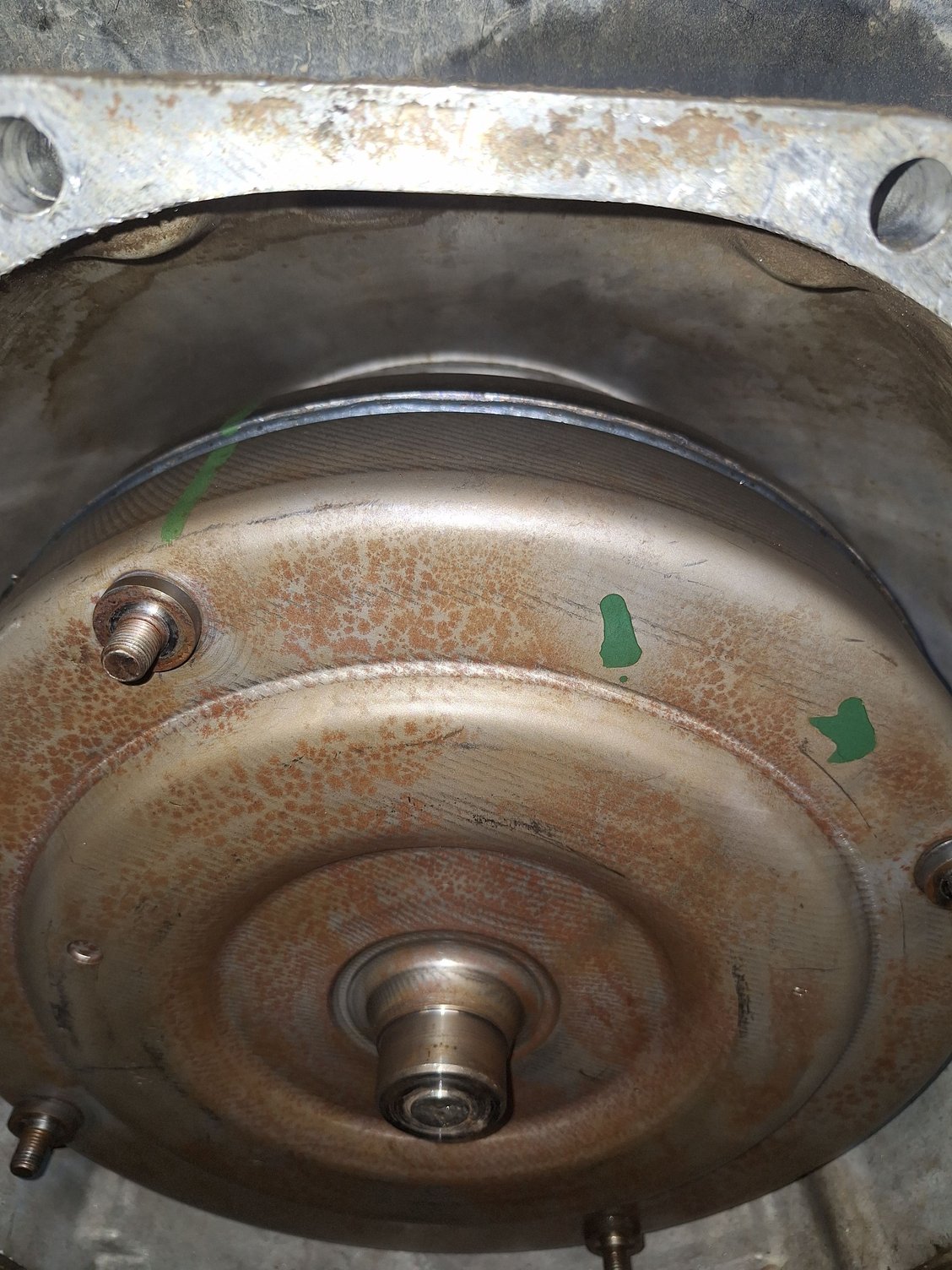

I took the TC back out and the splines inside it don't seem to be damaged, when I try to reinstall it it seems to sit into the bell housing about the same as before. I'm not sure if I don't have it aligned or seated properly or if I damaged the shaft when I tried to bolt everything together. It does have some play up and down and left and right, not sure how much/if any its supposed to have? Any advice or help is appreciated
This is as far in as I have it at the moment, but I think it needs to go farther in

With a lot more wiggling and turning I got it to sit into the pump gear, it sits farther in than in the picture and I have more clearance from the front of the bell housing, it spins fine and I'm not feeling any spots where it binds up or feel like there's any damage
