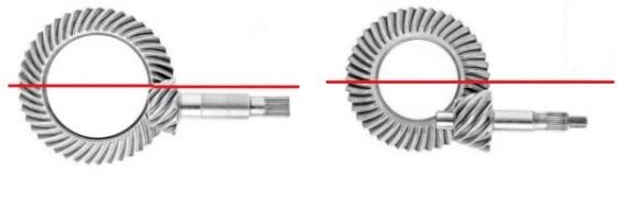

To my understanding of hypoid, there are no hypoids in the NP435 or NP205. Your Dana axles do have hypoid ring & pinions, just as the 9" does. The 9" has more of a hypoid distance, so it's more critical to use a hypoid oil in it.

Pictures/illustraions of hypoid gear engagement. Shear strength in the oil is a factor. Note the Dana 60 and Ford 9 inch are both hypoid.

Actually, "Hypoid" doesn't mean the gears are curved and beveled. Curved beveled gears are a necessity of, not the reason for, the name hypoid. A hypoid setup is simply when the axis of one gear, does not intersect the axis of it's partner gear. Below is an example of that. Dana 60 and Ford 9"
