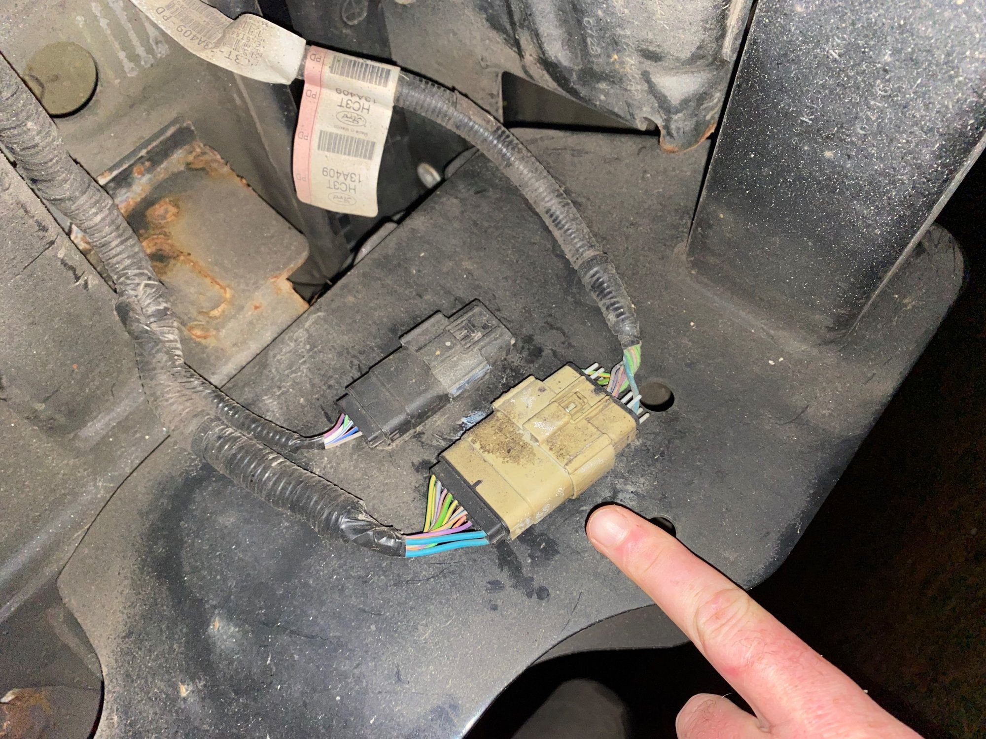

Very common. There is a plug up near the spare tire. Known for water intrusion and the many gremlins that you note. I had this happen with a 2017 that was only a few months old. Caused problems with driver side window, HVAC controls, radio controls and trailer indicator warnings among other things I've forgotten by now. Dealer replaced under warranty and problems all went away.
You mentioned aft wiring harness but I'm not sure which you mean. Some people think it's at the trailer plug connection.
Find the plug, dry it out and it there isn't too much corrosion put it back together with dielectric grease. If it's badly corroded it will probably need replacing.

Old Mar 3, 2024 | 11:31 AM
Poncho450's Avatar
Poncho450
Joined: Oct 2014
Posts: 5,945
Likes: 1,359
From: NY/Canada border
Originally Posted by morehouse7
You post that same pic every time. And it's always helpful. Especially since I don't have any pics on hand to show other folks and I don't feel like crawling under the truck to get one!

Yeah already pulled it apart. Cleaned it and resealed it. Still having issues
