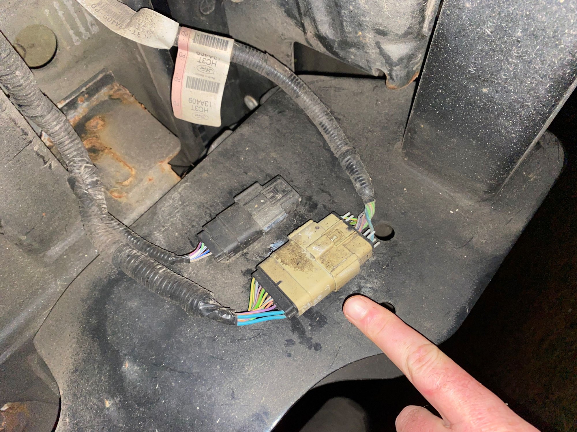

This is going to sound stupid, but this particular issue caused me all kind of bizarre things with the radio, window controls, climate control and several other things.
Check the plug under the rear of the truck near the spare tire. Water intrusion & corrosion in that thing causes all kinds of weirdness. Mine was replaced under warranty on a new 2017 that I had. Problems all disappeared.

That plug seemed just fine, no corrosion, the black insert was a little pulled out but nothing that seemed to be an issue. Other than that or spending money on 2 brand new batteries and hoping.. I'm lost. I have a 13 hour drive from Michigan to VA on Monday and I would like it to at least be out of 4WD lol.
What are the odds of a bad BCM? My mechanic friend didnt seem to think it went that far. Said there were signs of electrical issues (DPF showed a number of like 59,000-60,000) but after a forced regen we had the percentage down to 10 percent. Scanner also showed lots of communication issues everywhere which points to maybe water getting into something somewhere. Maybe i need to get under the main fuse box?
