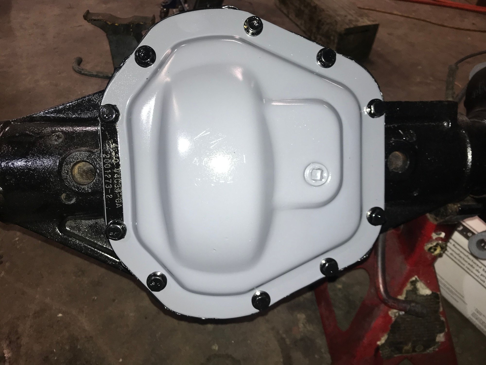

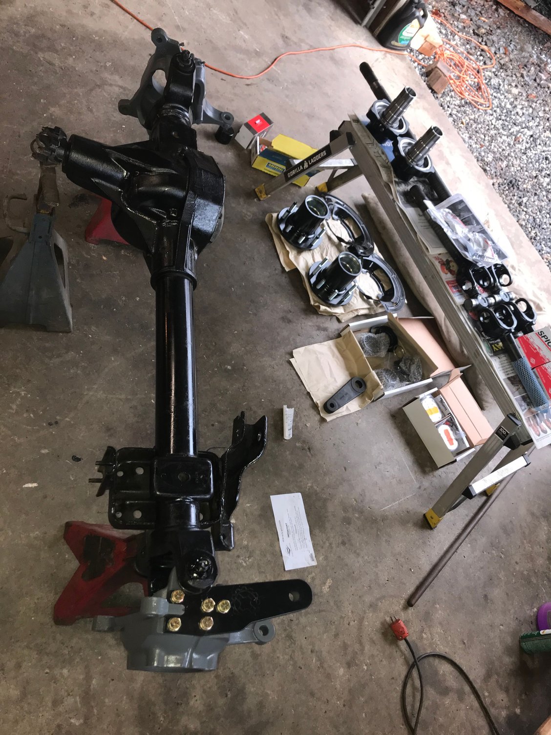

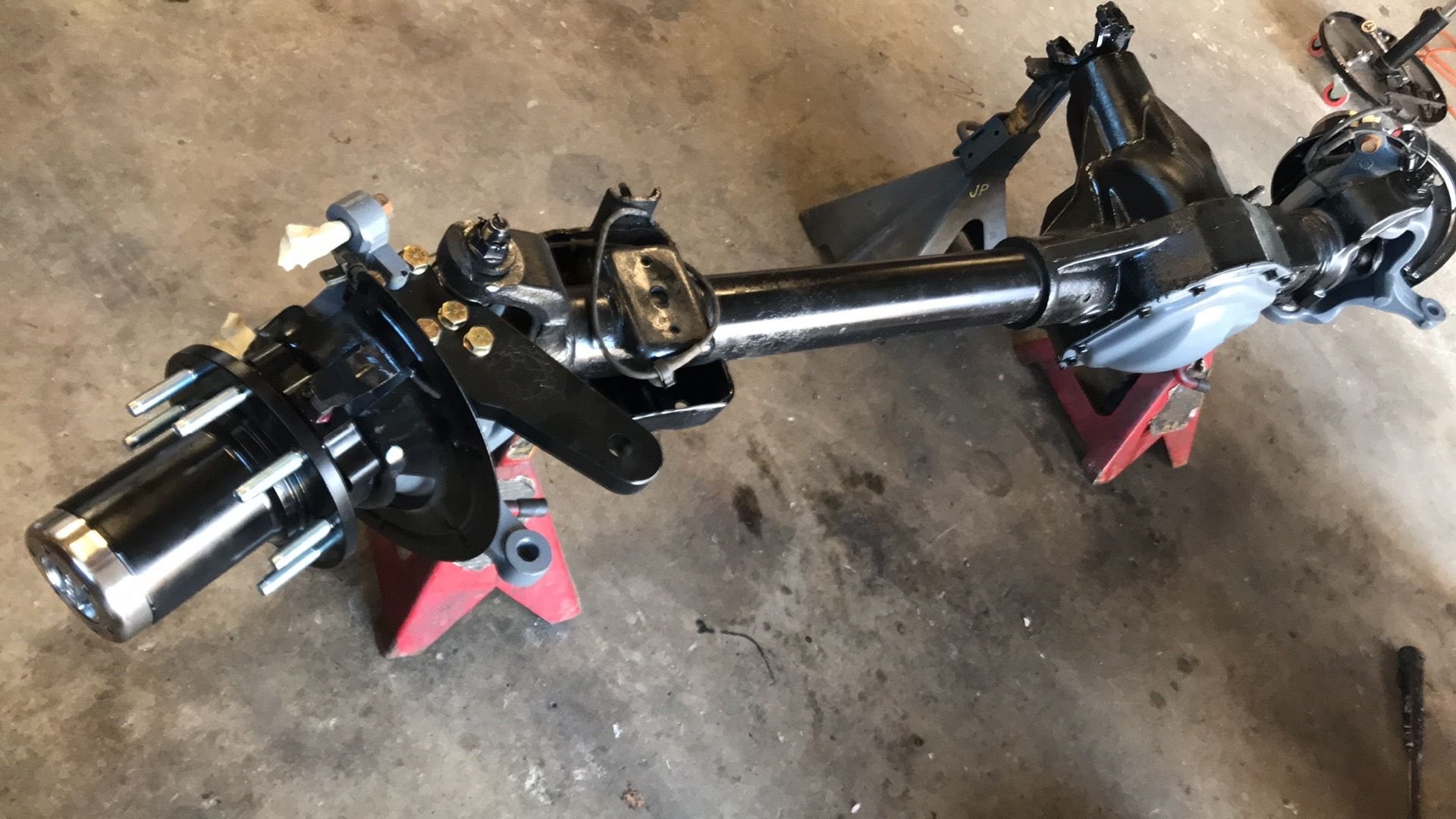

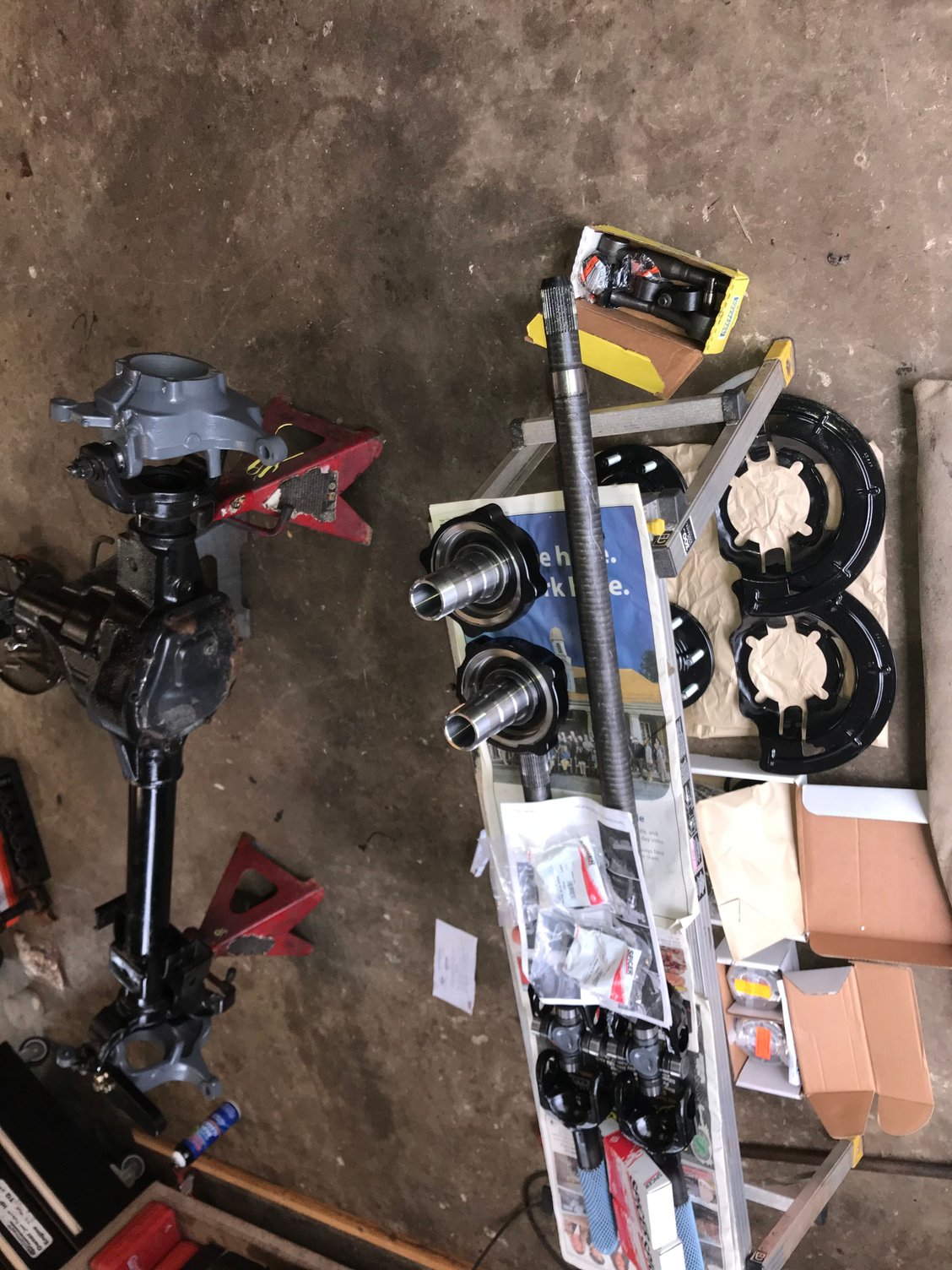

The ‘vacuum seal’ is actually what supports the axle shaft in the center of the knuckle and should be replaced if doing this level of maintenance. It is ‘bad’ if you can move the axle shafts/u-joints up and down inside the ‘C’ of the axle/knuckle - but, replace them anyway ‘while you’re in there’. When these are bad, they allow the axles to droop and bind in the roller bearings at the center of the unit bearings. This will damage the stub shafts where the bearings ride, requiring their replacement. This tool was about $65 last time I looked and could easily be justified weighing the cost against $100+/hr shop labor. (Apparently, some people have installed this seal with a 7.3 oil filter ) You’ll also need the ‘dust seals’ for the inner axle shafts. Definitely get Spicer seals.
If the axles have ‘dropped’, the thrust washers can also be damaged.
You can ‘rent’ the ball joint press and 4wd adapter kit from the autoparts stores. You will need a torque wrench. I currently like Spicer non-greaseable ball joints.
If changing u-joints, I also use Spicer non-greaseable parts here.
I use Ventures Truck Parts for the Spicer parts. Usually from their eBay store.
Fill your unit bearings with grease through the ABS sensor hole.
Remove the nipples and install plugs in the vacuum ports on the knuckles if you no longer use auto hubs.
I’ve been using XRF steering parts for several years now with no failures yet. Coat the adjusters with anti seize prior to assembly so you’ll struggle less to do an alignment in the future.
Some people can do this kind of job without cleaning and painting. They’re wrong.
This job included SpynTec unit bearing eliminator, but everything else is the same as a normal front end rebuild.
on edit:
The only alignment adjustment is toe-in. You can set this yourself with a helper and a tape measure. You’ll measure from the center of the tire front and back at the center of the tread. You’re looking for 1/8-1/4” toed in. If the steering is sketchy or the tires are ‘feathered’, you didn’t get it right. I send customers’ trucks to the alignment shop, but they always tell me I did a good job.
