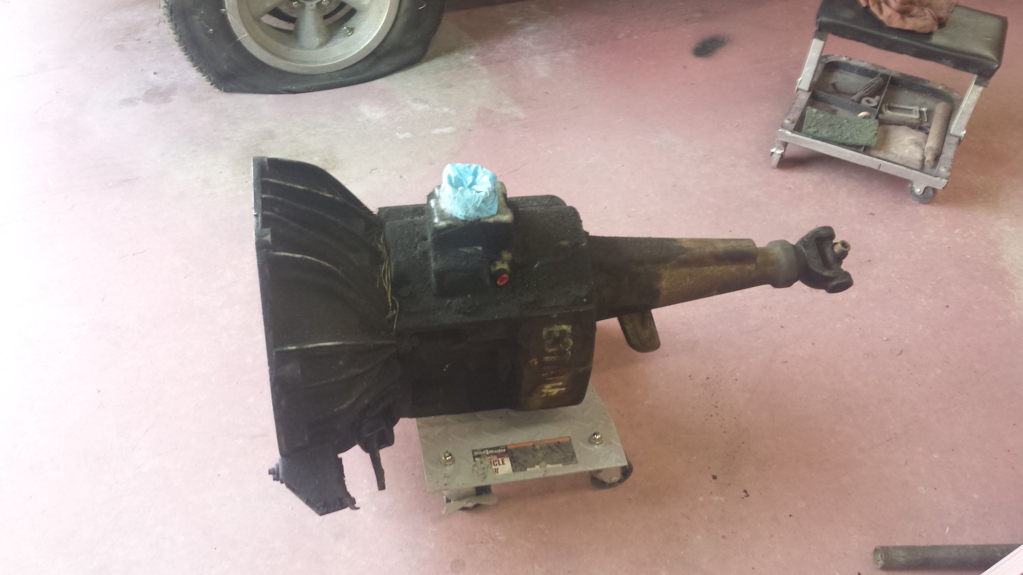

Yes the switch is at the top. It is the red thing in this picture of my NP435 but the T18 is in the same place.
I think Karl spelled it out the best on how to get to the switch to replace it as I dont think you can get a socket on it from below as the tower is up into the hump but maybe?
My truck came with the T18 and the plug on the wire was bad, did not make connection inside the rubber but after the plug was good.
I have A weather master electrical kit like GM plugs use. I cut the plug off and I put a 2 pin weather plug on the wire and pushed it into the switch.
It worked with the T18 and then the NP435 in the truck now and it has been over 4 years on the road now.
It dose not use the part of the switch to hold the plug in. I think the rubber seals is what holds it in.
