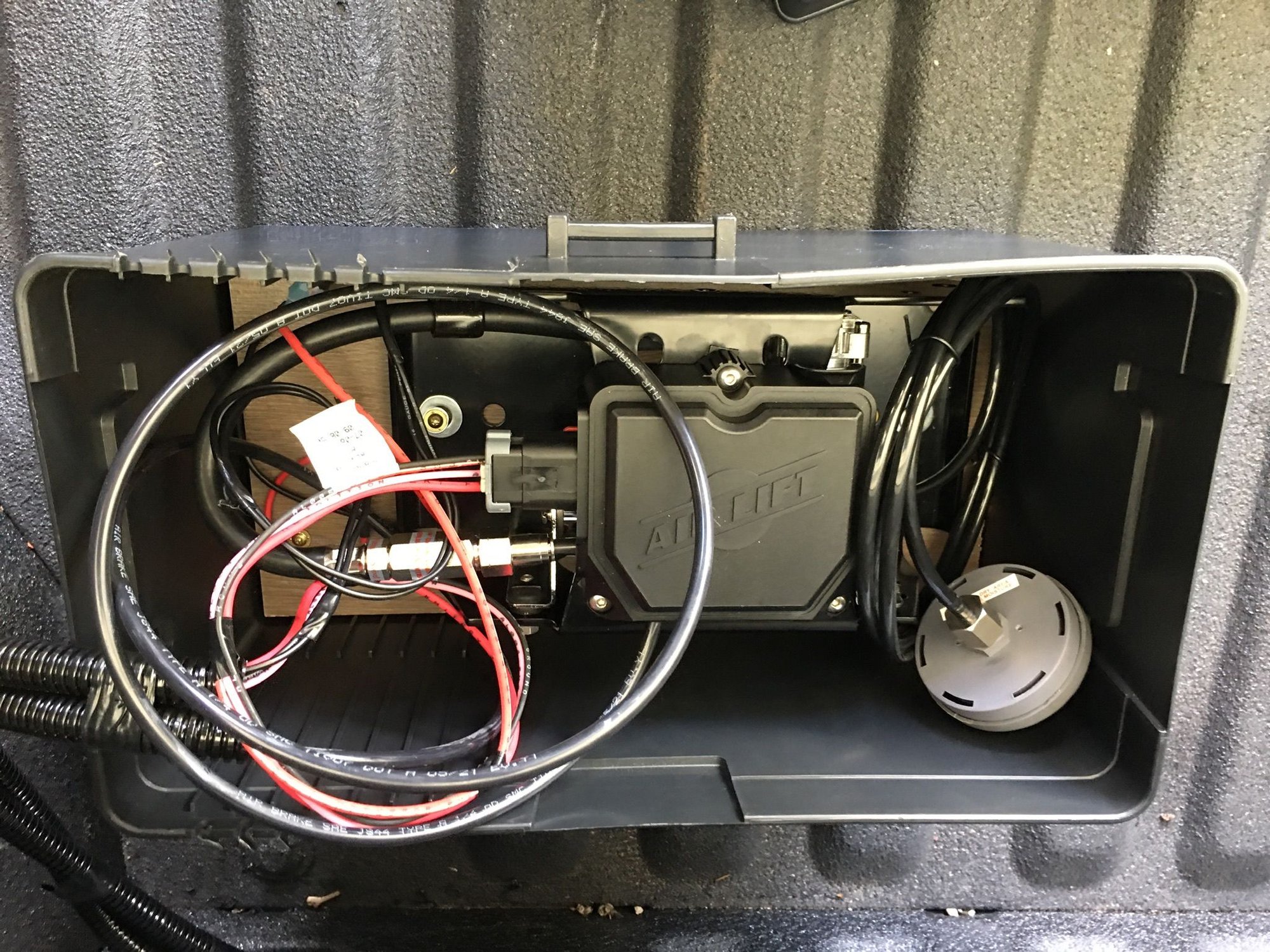

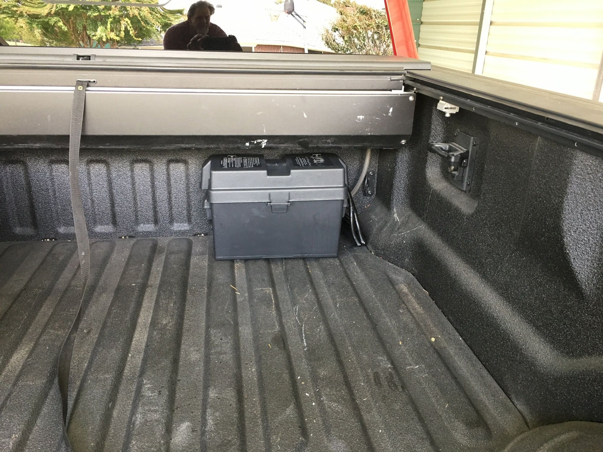

When I installed my Firestone 7500 on my 2020 F450 I came with two air valves so you could air up individually each bag . I have since bought a air compressor with a remote control or you can use your phone to check air pressure or fill/ air down . I mounted it in a large plastic battery box that sits under my RollNLock canister in the truck bed . Works good when hauling my 5thwheel. If we go to a slide in camper I’ll just relocate it underneath truck.

I have an almost identical setup on my F250. Several trucks with air bags in the past but the first that I added the compressor and phone app. Love the setup, especially when hooking and unhooking trailers with different loads regularly.

Easy to do and sure saves the compressor from moisture damage.
