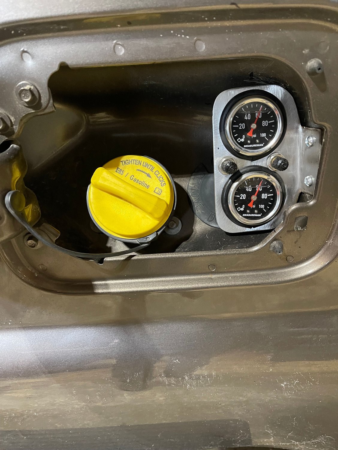

Old Dec 28, 2023 | 10:07 AM
Bugzilla46310's Avatar
Bugzilla46310
Posts: 1,678
Likes: 680
From: DeMotte, IN
Put mine in the gas door compartment.
Old Dec 28, 2023 | 12:03 PM
bigwin56f100's Avatar
bigwin56f100
Joined: Jul 2003
Posts: 9,373
Likes: 1,733
From: AKRON ohio
That's genius!
