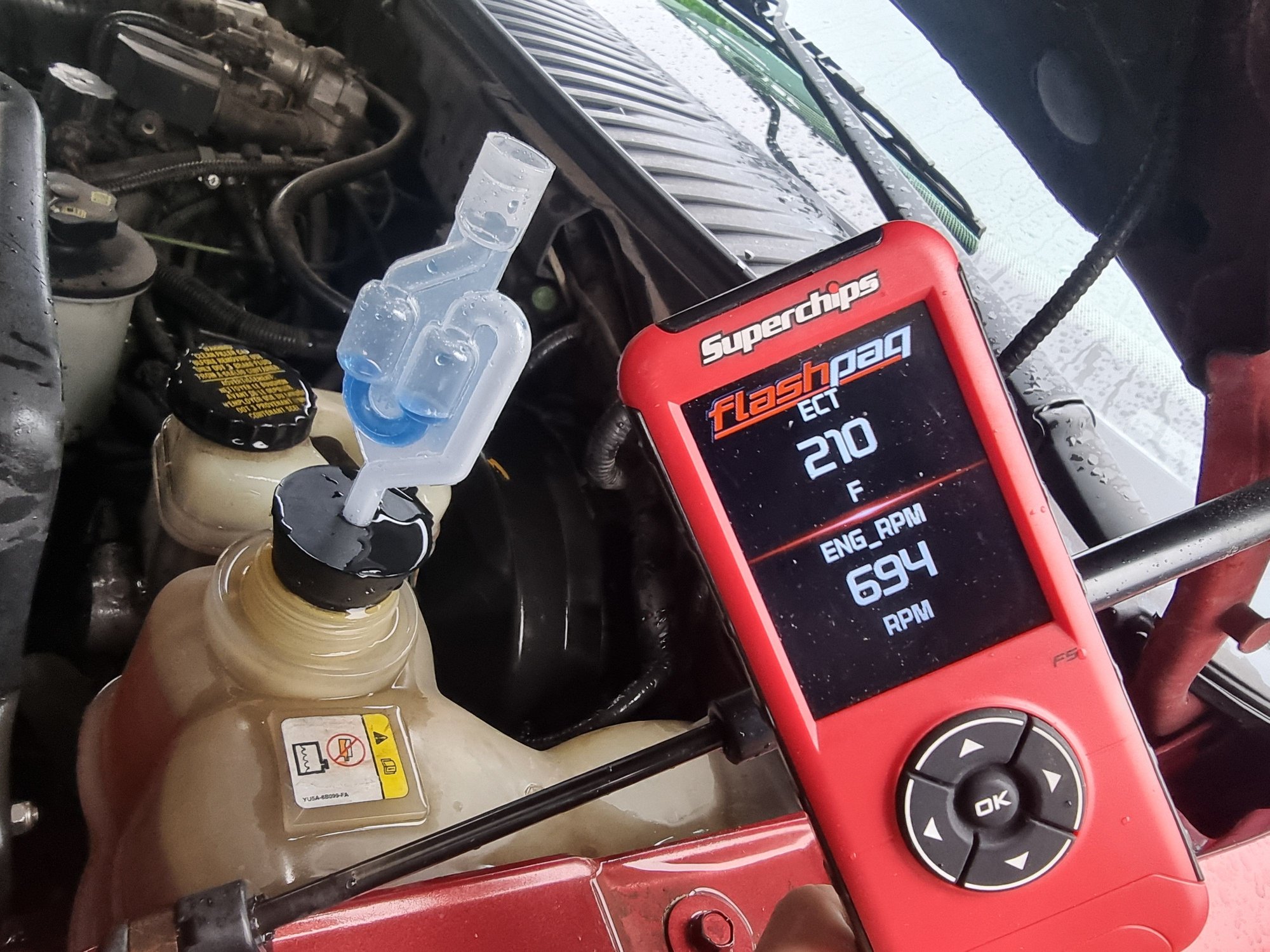

I checed exhaust gas blowing from a damaged engine head gasket.
On warm engine I put pipe with control fluid to radiator tank :
started engine wait few minutes. I rose RPM to 3000 and wait few minutes.
Tester is still blue, if fluid change colour to yellow I have exhaust gases in coolant, green means a small exhaust leak. Test showed that the problem was not in the system containing air from exhaust gases.
Time to replace water pump.

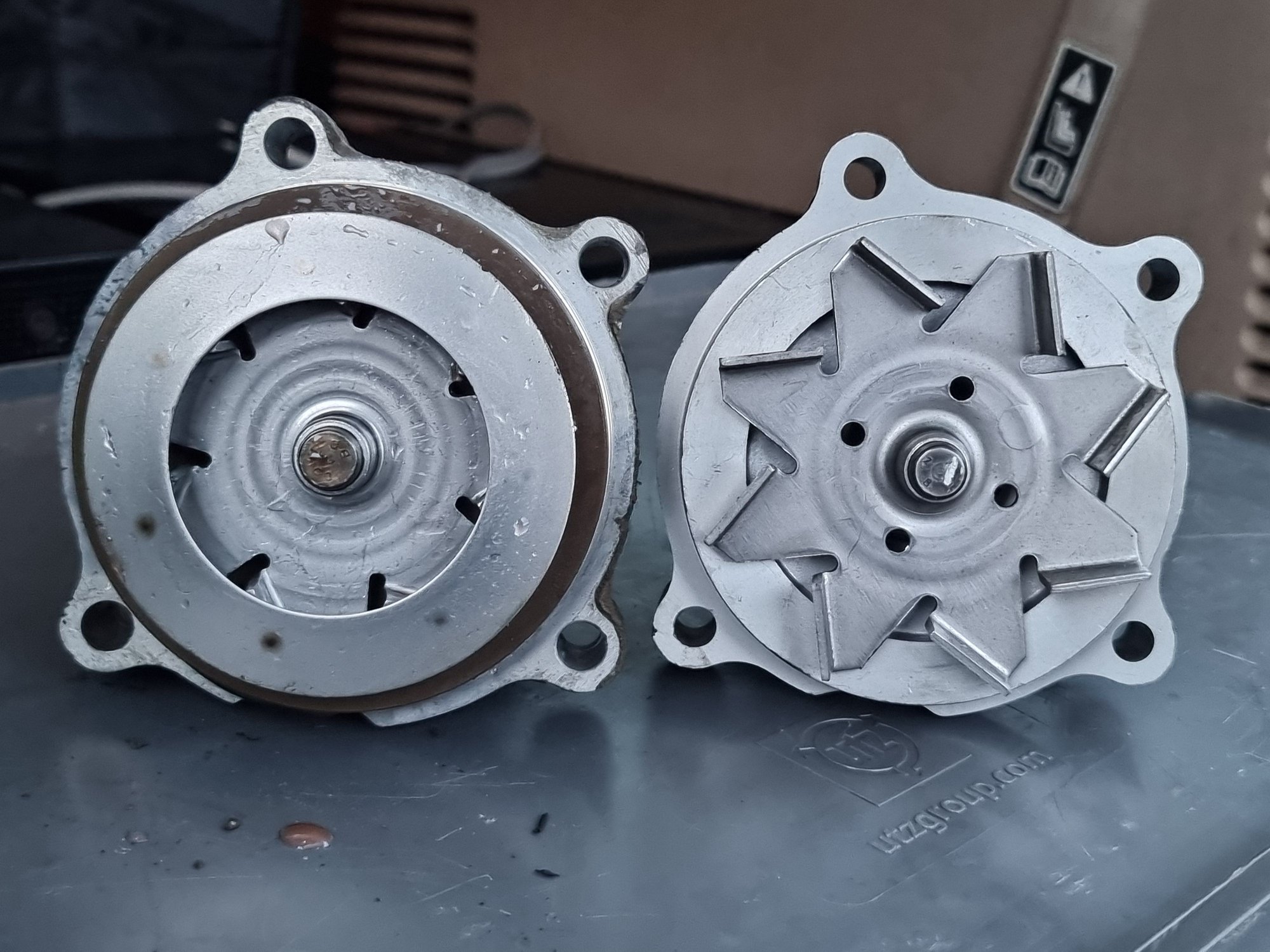

I removed old water pump and looks good. It's looks like from my friend Mustang engine but i have aluminium romero and maybe it is the reason.
Old pump on left, new on right:
I changed it and its better, I think that wider pump blades take more coolant. I checked system and is better. Still have warm, and hot air from blower and if I drive I have about 192 - 196 F ( thermostat schould be opened at 190 F). Problem is when I stop or drive really slow, engine temp rise to 235 F and goes down when I go higher with RPM. I checked viscous fan clutch too. Maybe here is problem. On cold engine fan can be rotete by hand, on hot engine nothing change. The same easy to rotate. Maybe it is reason why need higher RPM for cooling ??

Dang. That looks pretty clean. I guess it could be the fan clutch. I suspect a coolant flush won't help, but you're probably due to do one.

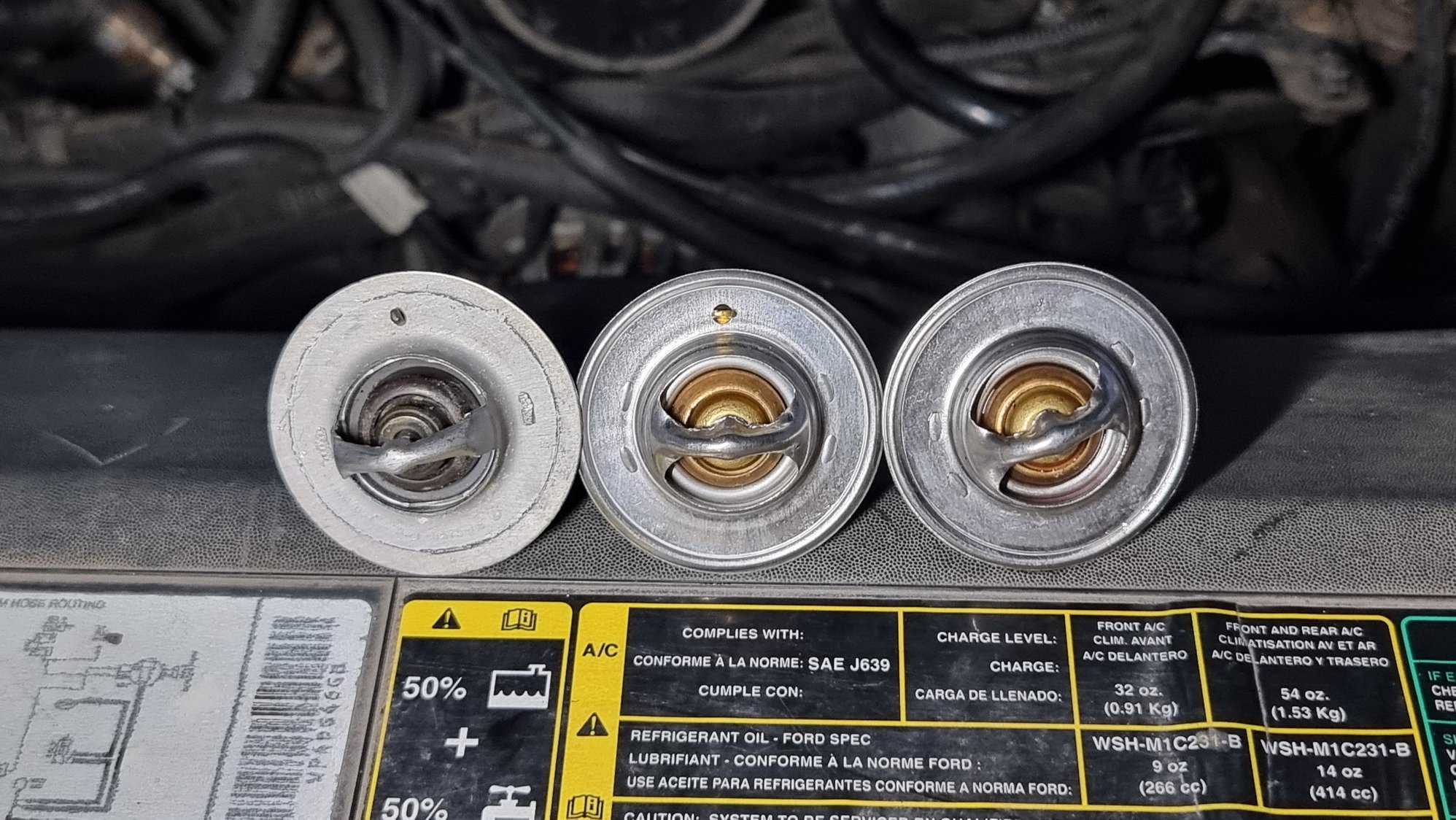

Today I picked up another one thermostat. I thought it was Delphi but... it is Gates I chose this time 180F, not because overheating but I have impression that on warm summer days and when traveling around southern Europe, my car has less power than on colder days. Second thing, I most often use the "Performance" program from Superchips and the fuel has much higher octane than in the USA.
I removed termostat, and I solved the overheating mystery...
On left Motorcraft, on middle Gates, on right Motorad:
First I had ( I think from new ) Motorcraft : it was stuck open and the car wouldn't heat, and once it was closed, it couldn't open and the engine overheated.
Second I put Motorad : the engine warmed up, then overheated and started working normally until it cooled down completely. Then the situation started all over again.
Now is Gates : engin at first start warm up and worked without problems. After cooled down I refill coolant and works like should.
One difference is that on Motorad 190F engine works ( after first overheating ) about 205 - 220F on Gates 180F oscilating about 188 - 196F
Where was problem with overheating on Motorad thermostat ?? On photo you can see on upper side of Motorcraft and Gates little hole. Motorad is without it. Air that accumulated in cooling system during operation of the open thermostat passes through this hole and coolant can fully fill thermostat. In Motorad in Motorad, the air bubbles surrounding the thermostat did not allow it to reach temperature, which resulted in overheating.
And one more thing... on Gates thermostat visco fan clutch started to work.

Interesting find. So maybe the Motorad would work correctly with a small hole drilled in it.

I've had issues with Motorad not holding the correct temperature, so I don't use them anymore.

AFAIK This hole is for letting air out, must be pointed up
