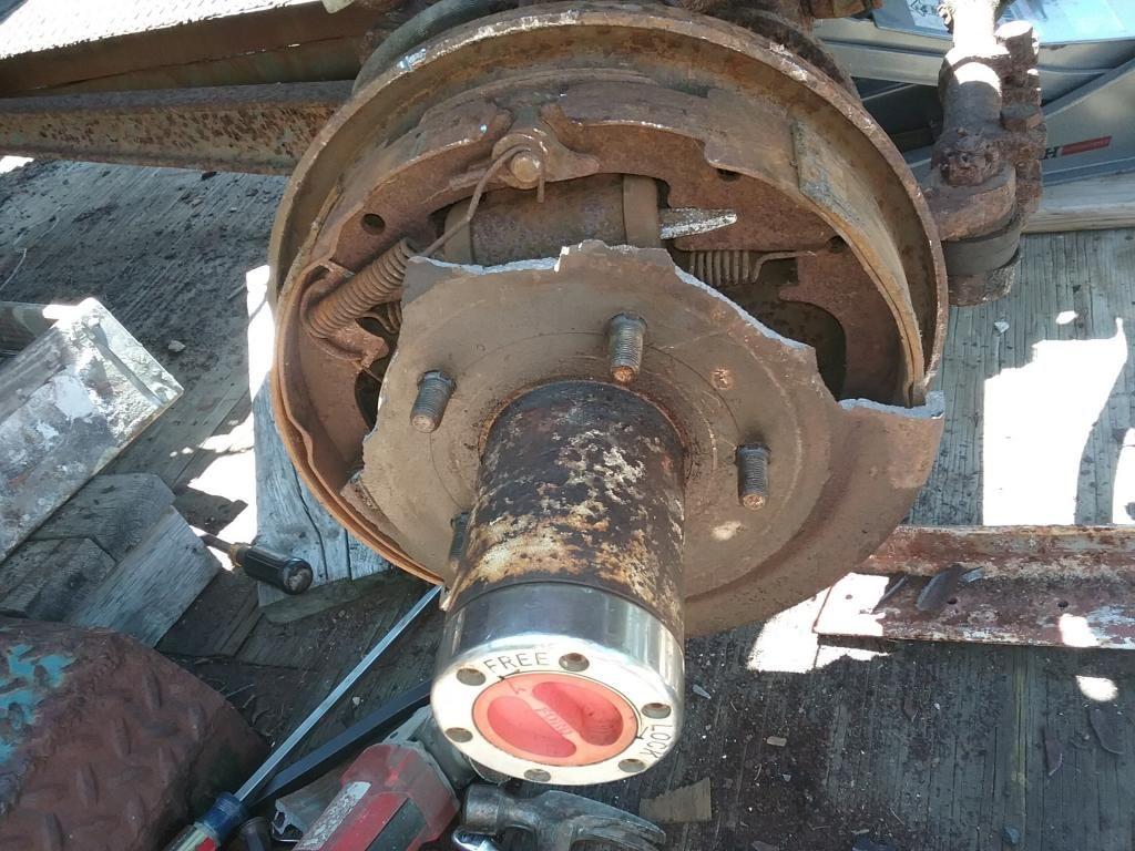

I had an issue once, truck was on a lift at a buddy's shop, drum would not come off. Buddy told me to hit it with a hammer, I did, made a lot of noise, but it stayed tight.
I could see that the hub hole where it's beveled out was a tight fit on the hub. Just a little surface rust and it was trying to dig in to the hub.
He came over, took the hammer, hit it twice, hard, drum was free. I had never had one do that before. I got the other side off the same way he did. Something about vibrations.
If pulled, the designed formed bevel at the hub will try to tighten it's grip on the hub.
This is the way!
I have hit a few hard enough they cracked but that’s probably 3 or 4 out of thousands.
