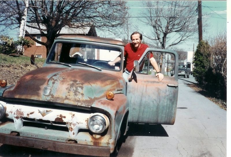

Here's what faded (and rusty) Meadow Green looks like:
