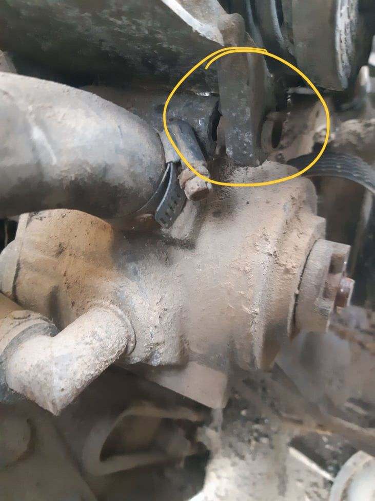

Hello.
I have a 1990 f150 lariat with a 302.
I also have a 3 g alternator on my bench but was told you need the bracket which I saw today in the junk yard on a 1995 f150 302
i undid 3 bolts and it ( along with the attached smog pump) were rocking back and forth. But I could not see what was holding it I.

Looks to me you removed one of the bolts holding the air pump. There should still be one more holding the bracket on. Probably hiding behind the tensioner..

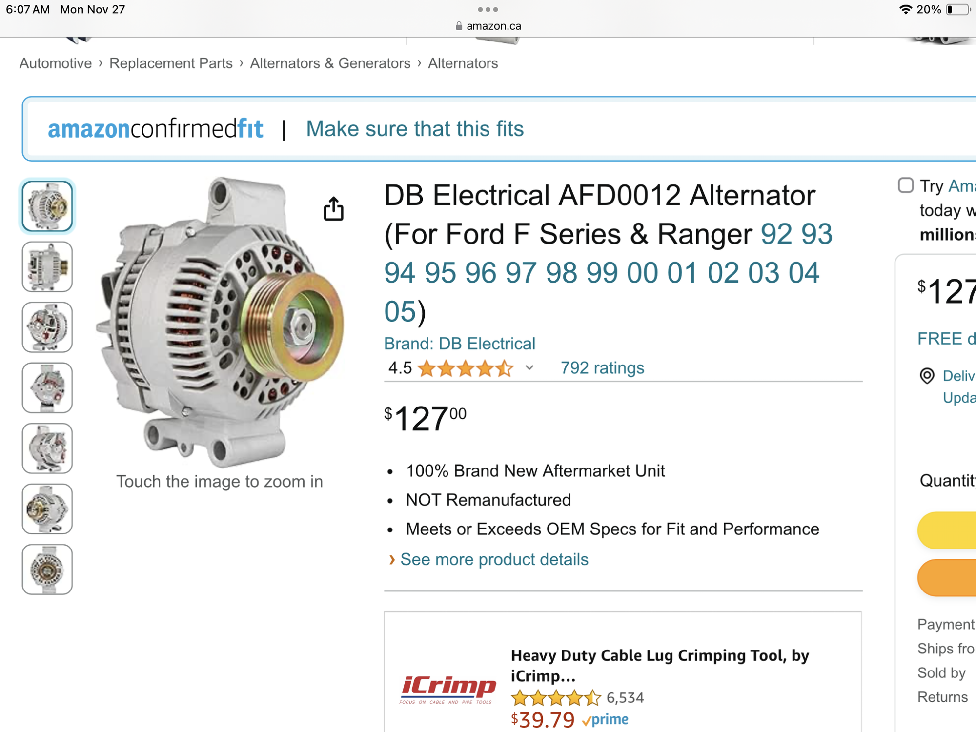

Ok so at some point a grabbed the wrong alternator and that what led me in the direction of the bracket.
even though I now know that.
imthink I should post a picture of both here just for reference to any other forum members that come searching.
