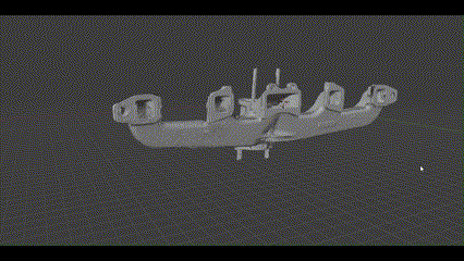

Following up, I did not use ez weld tig wire. I did try to tig braze with a regular Si Bronze wire. Didn't go well. I blew some small holes in it so I made myself stop. Brother-in-law torch brazed it for me. It took some messing around for him to get the braze to wet out since the cast was still pretty dirty even though I tried to clean it up. Cooled in ashes over night. Seems good, haven't installed it yet.
Brazed around the center heat riser area.
It appears to be marked EAA-9430-A which is = EAA-9426 A according to post #58 and the picture in post #55 here: Hard to find part - Page 4 - Ford Truck Enthusiasts Forums (ford-trucks.com) These are almost impossible to find now rather than just Hard to find like they were in the 2012 thread. Looks like on mine someone intentionally bent the end of the shaft for the flap in the heat riser. It was running fine and pretty much I only drive it in the summer. So, I'm not going down that rabbit hole.
Scanned it since it was off. The scan has some issues. Not terrible though for a cheap scanner and untrained and inexperienced operator.
