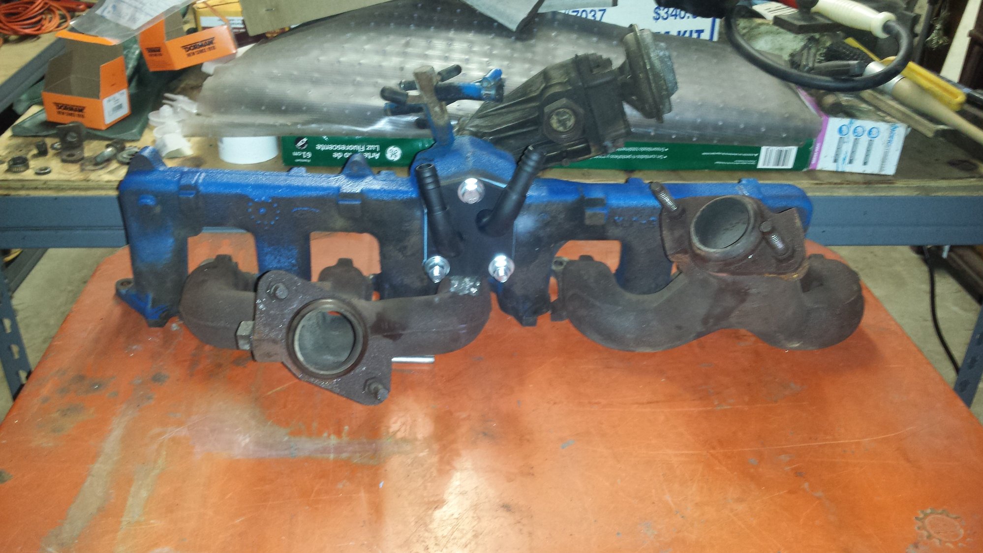

You can leave it open but as said the factory bolted the exh manifold to the intake and had a valve that would flow hot exh gas to the bottom of the intake.
This heat would keep air fuel mixed where if to cold the fuel would drop out of the air and cause poor running.

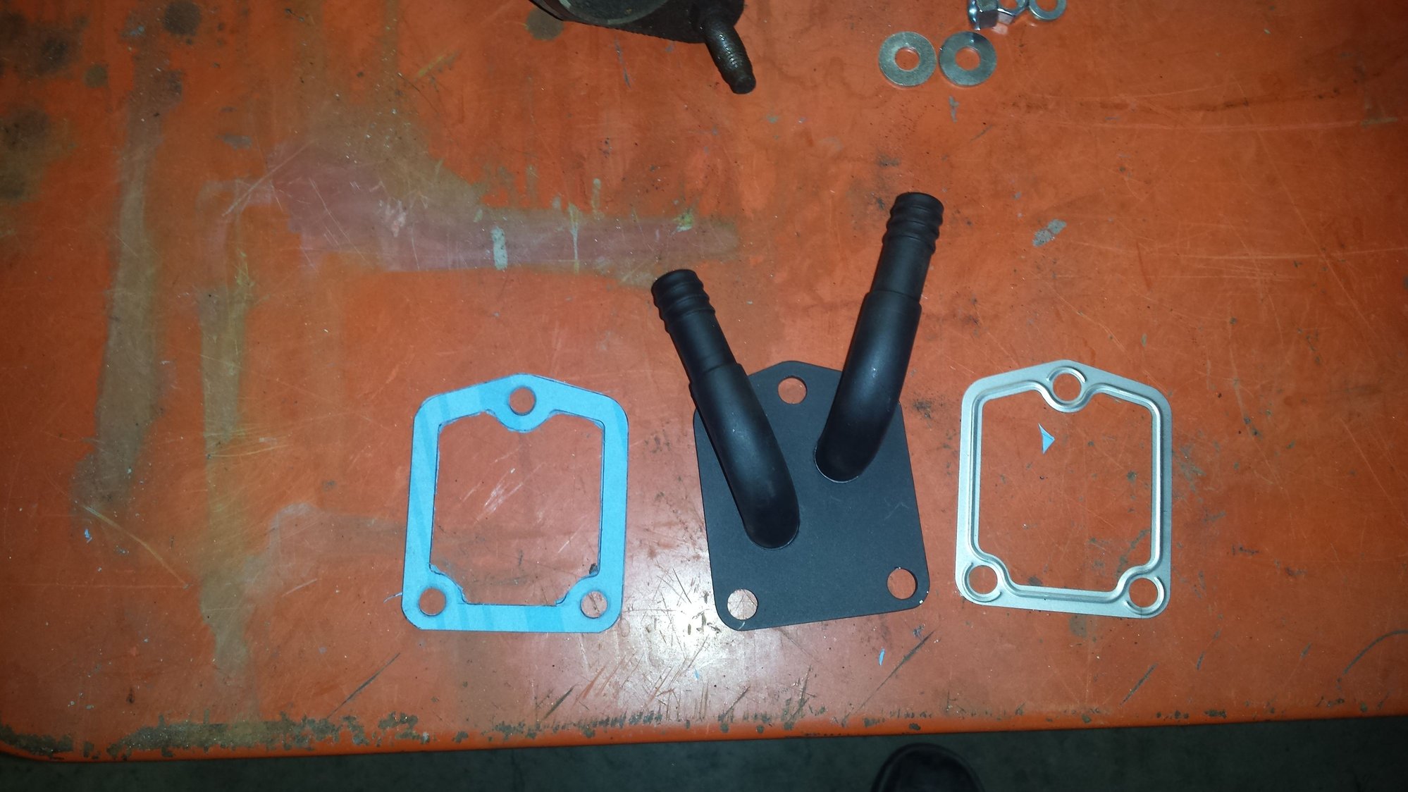

At one time you could buy a plate that had 2 pipe nipples that would bolt to the bottom of the intake but as of late I have not seen them.
It is not hard to make using the gasket as a pattern to cut the flat plate. I bought this plate years ago off Ebay.
You just need to watch where the holes come thru
Bolted to the intake manifold. Yes I am using EFI exh manifolds.
Now to tell the truth I think it would do vary little to stop carb icing as the air going into the carb is what would ice the carb so you need to heat the incoming air like the factory did with the factory air filter assy pulling hot air from the tin around the exh manifold.
Yes I am running the factory air filter and Carter v1 carb I do not have the tin on the EFI exh manifolds but so far on the road 4 years no icing issues.
I do have a trick for the factory hot air asst. choke on the carter carb when running EFI manifolds and can be used for headers also.
