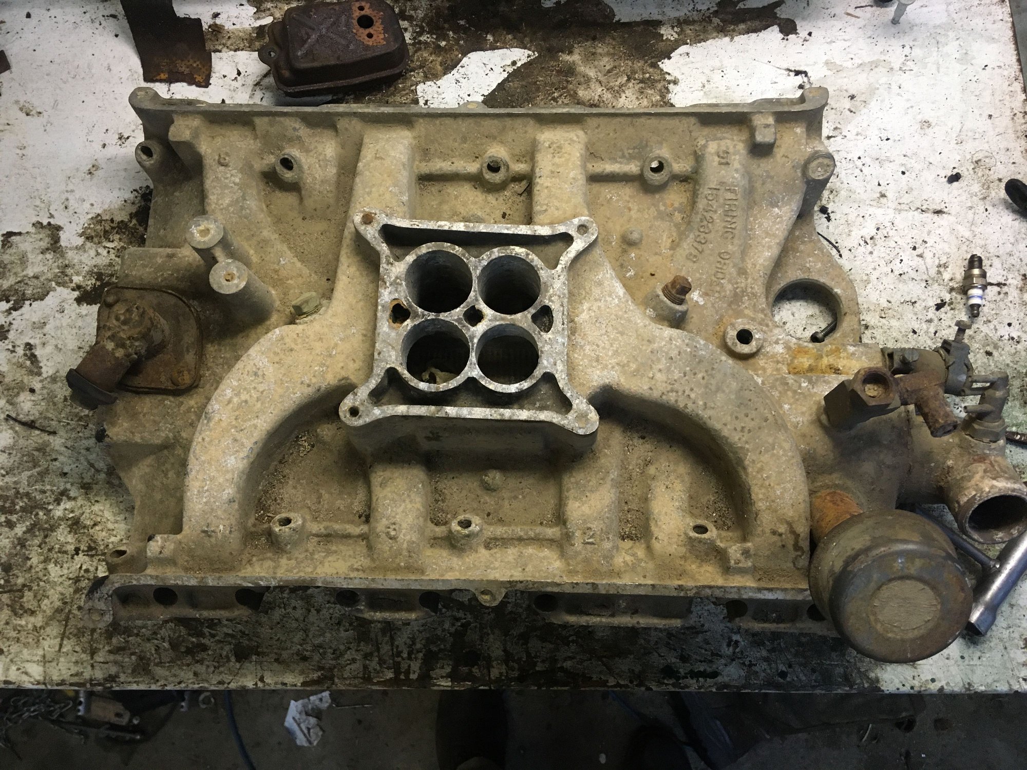

What is this intake for?
I’m looking for any info on this intake as far as what it is and what it fits. Any info will be appreciated. Thanks

Is there a casting number on it? Is it a Ford manifold?

I was on my phone, I can see it more clearly now. It has a factory appearance like this 1963 coded intake:
C3AE-9424-E
Measure the ports.
C3AE-9424-F

looks like a FT intake.

Rough guess; 61-62 Galaxie
I ran one similar to that until the exhaust cross over burned through. It was off a 1960 352 HP. It had no casting numbers and just a very small FOMOCO logo, I don't see that on yours so I'm not sure. It had large ports that matched my 428CJ heads,
The first years ALUM intakes (HP 352-390) were cast outside of FORD foundries. They had no CASTING ID NO.
PI also used this style.

It's definitely an FE intake (not FT, the exhaust crossover would be in the center). It's also definitely early, based on the crankcase ventilation setup.
It's also "tilted" - which means it was only used in certain cars I believe. T-bird? Galaxy?
that's all I got

I appreciate the info and was wondering if it was for 427 390 ? What would this be worth?
It's for a 390 and the value is between 500-1200 based on buyer. They don't show up much and have been bringing a premium at the swap meets.

Depends on the size of the ports. Probably not a 427 other than a low riser, If the smaller ports probably will fit any FE. If larger ports it may still fit if the port mismatch and gasket fitment can be made to seal.
Found a couple aluminum FE intakes on E-bay for around $300. Looked to be about the same vintage, maybe a little later.
Lots of 2x4 and 3x2 manifolds on there for far more.

That's a Low Riser 427 intake. And it will fit 390 heads
that's all I got
T-Birds had the flat carb pad on the 6V intake, the 4V intake was tilted, with a wedge carb spacer to put the carb flat
