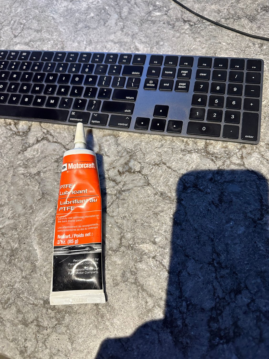

The internal splines of the slip yoke. This is what ford makes.
Awesome, thanks for the pic, I'll get some on the way.
