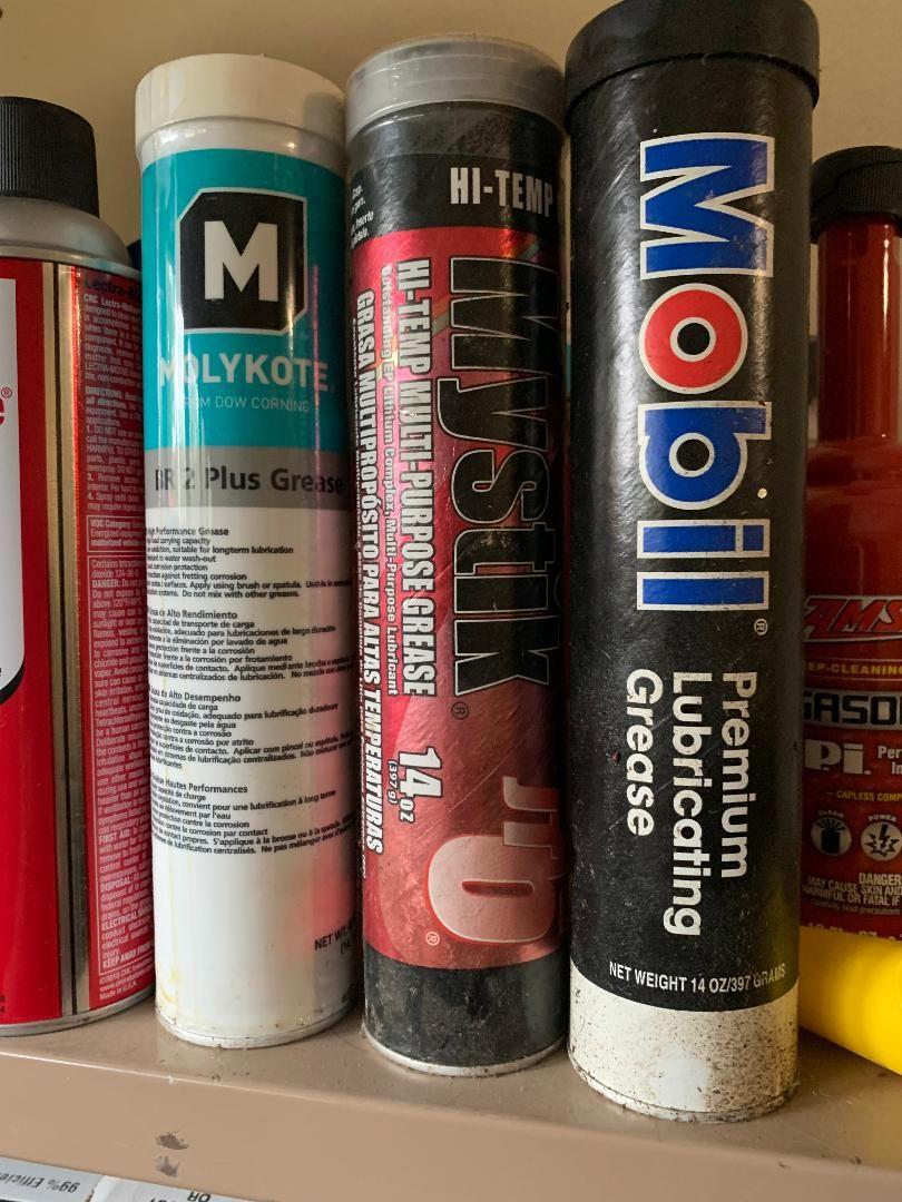

I am going to give this a go here shortly and these are the greases I already have on hand. I realize that the proper grease would be the Motorcraft XG-8 posted by ssls6 but I am anxious to find out if this is going to help my issue. I am leaning toward the Molykote since it has a molybdenum additive which would hopefully extend the interval at which I would have to reapply. Another option would be Super Lube Synthetic Grease I could get today from Harbor Freight which has a PTFE additive and might be closer to the Motorcraft PTFE Lubricant. I could always change it up in the future if this even works but cleaning the splines of any residual grease in the transfer case might be an issue of its own. Maybe I'm over thinking this and just need to get under the truck and get to work.

Honestly any moly grease is ok. I've said it before something is better than nothing. Now if your going to use Crisco from the kitchen it might not last long.

May want to check this grease compatibity chart before injecting just anything.
Good luck with your issue...
Grease Compatibility - LRT Lubricants LTD (lrt-lubricants.co.uk)

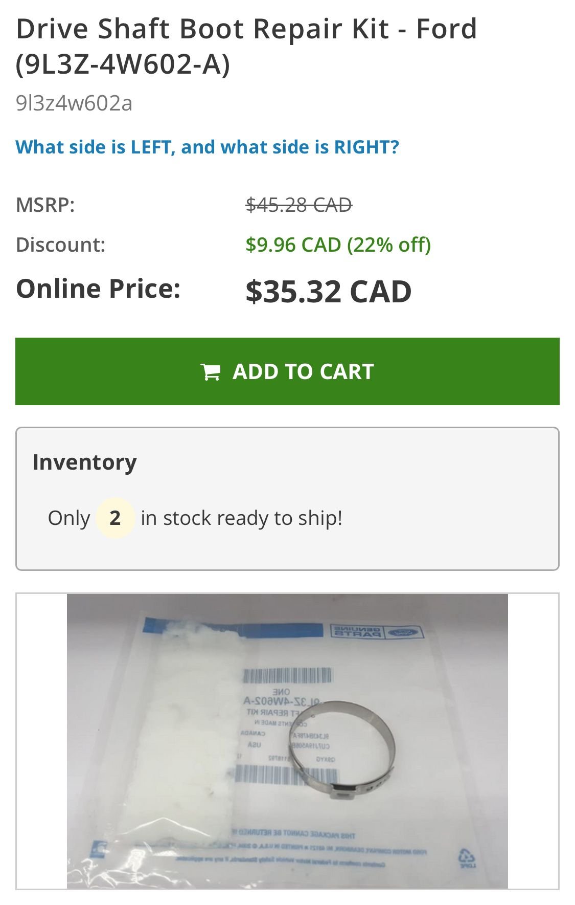

I watched this video in which the tech addresses the same problem but on a F150
He used a “kit” that contains the correct grease and a new clamp.
I think I will just get the kit, hopefully the clamp will fit the F350 driveshaft as that’s the main reason I will go with this kit over just getting the grease.

Yes, bacon grease wouldn't be compatible either.
Moly base is fine.

Just updating from my other post, I did this yesterday with the kit. The clamp is too small for the F350 drive shaft.
My truck had 62,000 miles on it. There was very little grease on the spline but what was there appeared to be in good shape and not dried up. Anyway, cleaned all the old stuff off and applied the while grease from the kit. The new stuff was on the thin side of what you would expect, will be interesting to see how it holds up. Reminded me of the white lubriplate grease if anyone is familar with that.
Is the stuff in the 3oz PTFE tube also kinda a thin grease?
I just put a zip tie on the the boot where the clamp was, I'll go looking for a Oetiker style clamp for next time. The OD of the rubber boot is 2.40" where the clamp goes.
Edit: forgot to mention, this did seem to clear up the clunk I had.
