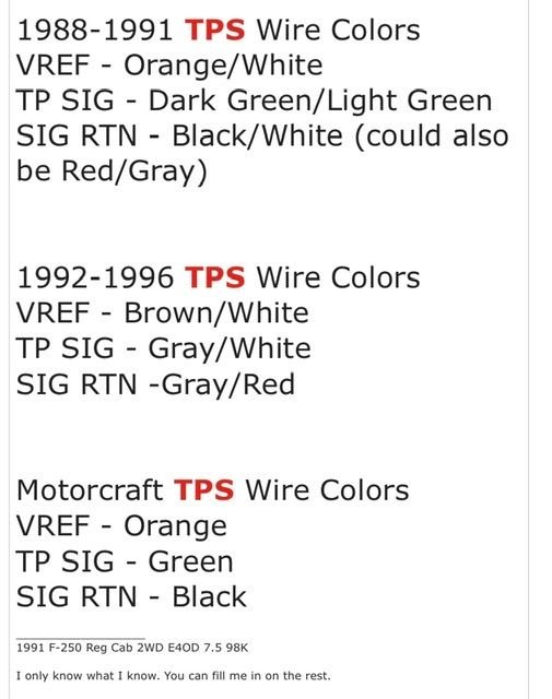

Thank you for the reply. How can I go about checking voltage and resetting the computer?

Posted by sandymane in another thread
There is no need to reset the computer. It relearns the tps sensor closed throttle voltage every time you start the truck.
