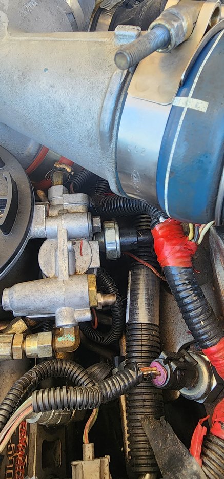

Old Oct 22, 2023 | 06:28 PM
helifixer's Avatar
helifixer
Joined: Dec 2005
Posts: 10,253
Likes: 7,683
From: Chino Valley, Arizona
Your engine bay won't look like mine, I have added the cac system and removed the cover. But that is the fuel vacuum sensor.
if the light goes away with it un plugged just leave it unplugged. Then when it starts leaking put a brass 1/8 inch pipe plug in the hole and be done with it.

Ok lead driver. I know that switch and shrader valve trick. I have a tire gauge just for that purpose. Did not know which swittch you were talking about until you mentioned leak and plug. No pic required. Did not realize it was vacuum since it has a wire. Thanks will unplug next chance i get. Not a daily driver so not an emergency. Thanks again
