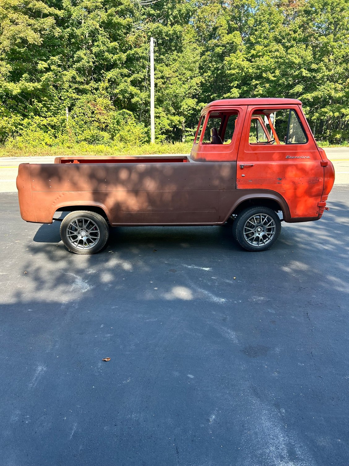

Progress update- she runs
Hit the road today on EV power , still lots to do and paint over the winter. Will check the rake when loaded to get the stance right. For those haters I have all the ice components but went EV as it was a challenge, 125 mile range top speed 65 will do just fine for me. Added front power disc brakes, EPS not that it will need it, new king pins and electric parking brake. This will be my wife’s Ride to take kayaks to the lake so next up is a hydraulic bed loader to make that process easier. Just keeping busy doing car guy things….

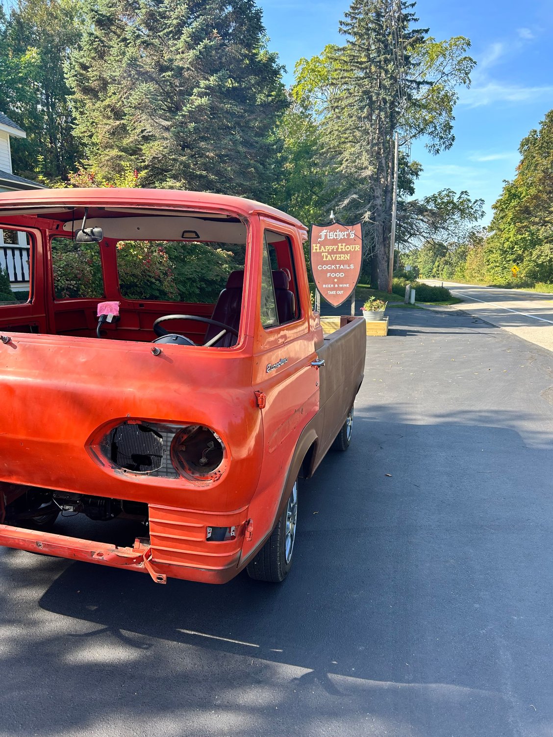

Looking good. Can you show us the mods you made. I've been considering doing what you have done.
PS. You might want to get that headlight fixed before you hit the road. :-)

thanks for your comment,
I have all the trim and headlights etc, all that’s in boxes in anticipation of paint. I just hit the road for a quick proof of concept drive to ensure everything was correct. Right now all the harness wiring is just layed out. Now that I know it works I will spend the time laying out things properly and mounting items , extending wires
as necessary and mounting the majority of the components in the dog house area. Once that’s done I can share some pics of that set up.

Happy for you on the first ride. I can’t imagine a more perfect vehicle for an electric conversion. Keep us posted on progress.
Did you remove the lead weight and fuel tank from under the bed and put batteries there?

Hi there,
yes, one of the first things I did as with the battery weight be more centrally located under the bed no chance of a nose stand.
now that I know it works , runs and drives I will spend time to extend the wire harness where needed so that it fits the Econoline layout
