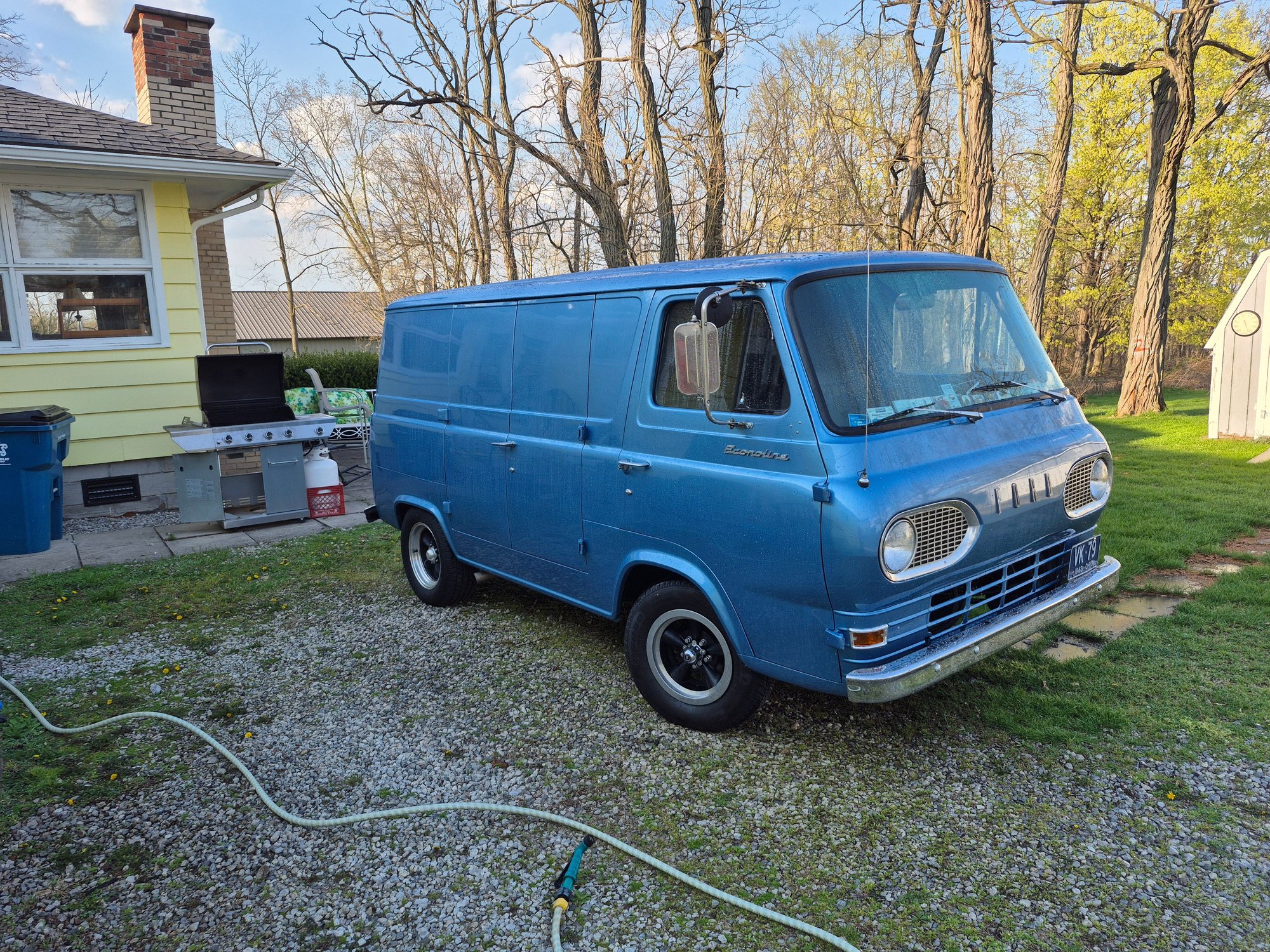

Mine is fine
I have a 63 with a transplanted 66 200. 3.55 gears it will do 65 no problem. Tinks to do to help are taller rear tires . I am running 235/60/15 . I have converted mine to power disc set up and a rebuild gear box. Drives great.
