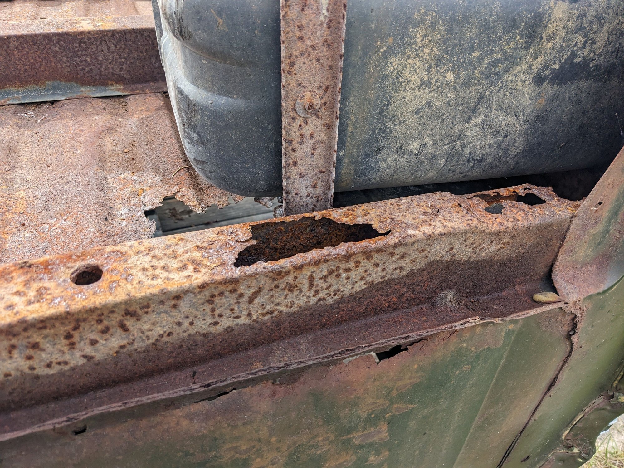

Got it in a garage bay to start working this winter. It's a little worse than I was thinking, but the rust seems to mostly be contained to the bed floor.

So, After doing some grinding to see what I've got, I really need the crossmembers too. It looks like the front and rear crossmembers are very similar to the ones I'm seeing online for cheap for a 99-16 super duty. Can anyone confirm that?

I would flip it over on some saw horses and 2x4s. Each side has around 52 spot welds plus the crossmembers and front bed panel. It's a fairly easy process, it's just time consuming. Buy at least 4 harbor freight spot weld cutters
