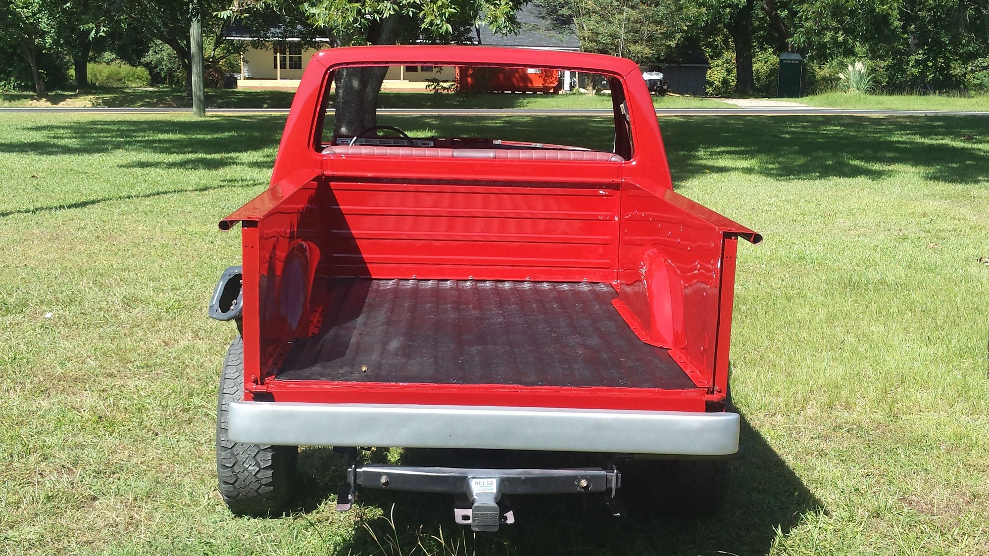

I am not sure of your years truck (67 - 72) as I was working with a 81 F100 (80 - 86) on how the 2 beds differ but I cant see it being that different from my years.
The style side cross members are spot welded to the floor with the U up where the flare cross members are not welded to anything and the U is turned down and wood block fit in the U to keep it from crushing when the bed bolts are tighten.
Also the bed side panels and front panel have a lip that bolts go down thru the panels & wood.
What happens over the years the wood stays wet and rots this metal lip so there is noting to put the bolts thru.
I had to weld strips to the panels for the bolts.
Again My 81 flare side has a wood floor. This would have still been planks, in 83 they then started using plywood from the factory.
When the front I rear sills and the cross members were $1000 not counting the wood, nuts & bolts and metal strips I went with my parts truck long bed style side. It was crushed on 1 side from a roll over and had some rust.
At the time no one could tell me if putting my sides on the metal ribbed floor if the body lines would line up or not?
If to low I could add shims but if to high I was stuck. Turned out it was just right.
I have pictures on my site starting here 1980 Ford F100
You may see some other things I was doing between the bed so keep looking.
Hope this helps you a little to go the other way, metal to wood LOL

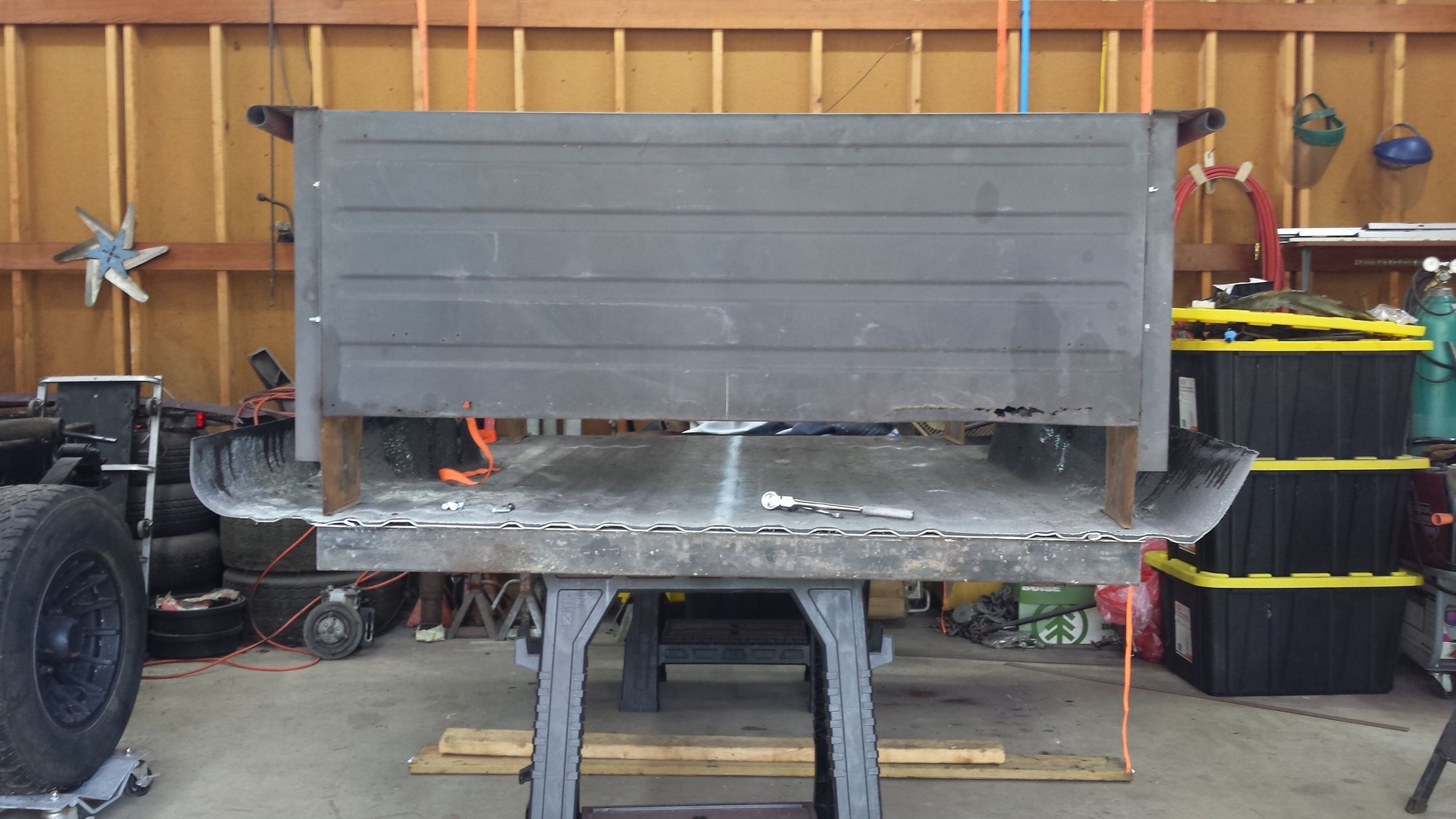

Metal floor painted ready to go on the truck frame and the panels bolts down.
Panels set on ready for bolts
Dave ----

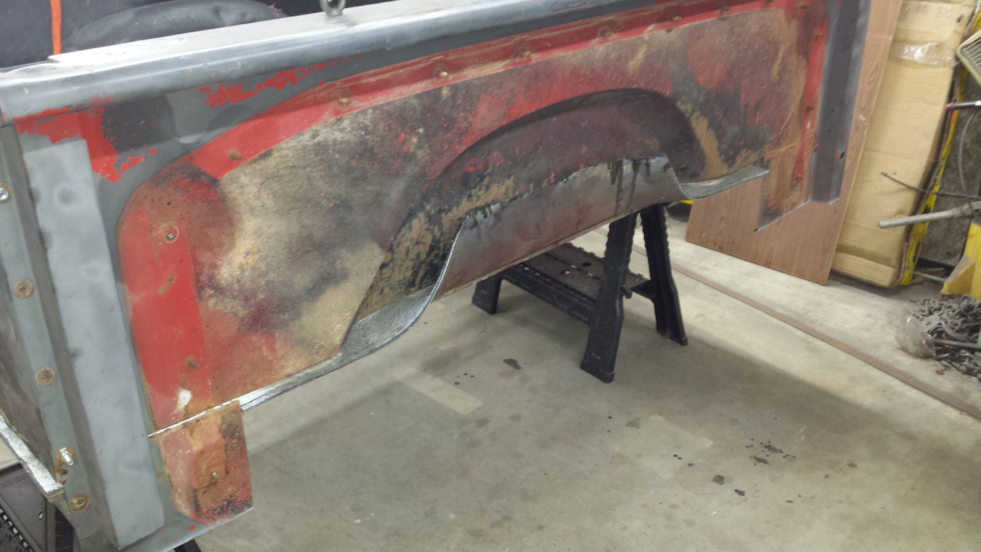

I just got thinking I dont think the flare side cross members and wood will be wide enough after looking at this picture.
The part that turns up is the inside walls of the style side bed and the wheel well goes in farther than what you see from the above picture.
Maybe if you used plywood it may support the bed sides with out the cross members going out that far?
But you cant go to thick on the wood or the body lines will not line up.
Dave ----
