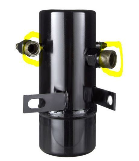

tool? I might be missing something here. I'm struggling with the big nut type connectors on the cooling lines coming out of the accumulator. I thought they were just a typical threaded twist off. I'm talking about the connections highlighted in this picture:

The pic is where the orifice tube is easily located. To remove the connection you need these available cheap at any auto parts store. Hope this is what you are talking about. Click the Amazon link for tool info

Orifice tube is where springlock is at that @sandymane pointed out. Red is what is needed for R134

Great,
Yours is old school for the accumulator fittings
Use some heat on those big accumulator nuts
That is not a 1996 factory accumulator, If that is on yours, it must be ARA air or a kit?
Either way, use some heat, throw the accumulator away, replace the o rings, the lines should be okay
Use the special tools on the rest of the system where the spring lock couplers are

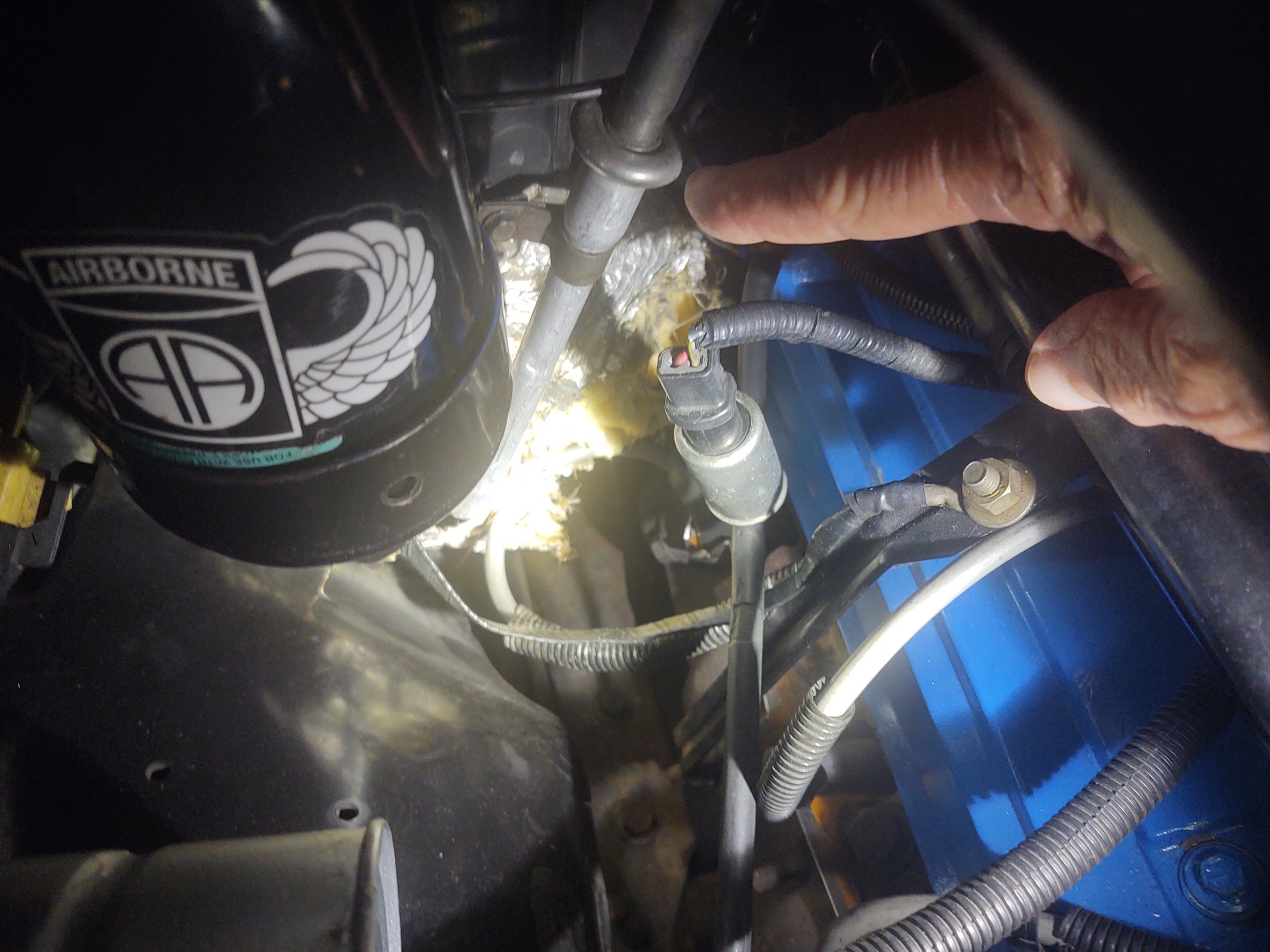

I used some cargo cinch straps and held the accumulator in place and finally broke loose those hose fittings. Then I got the special tool to removed the hose clamp at the orifice filter and got it replaced. now, I think i'll try to do AC system flush and see what happens after that.
