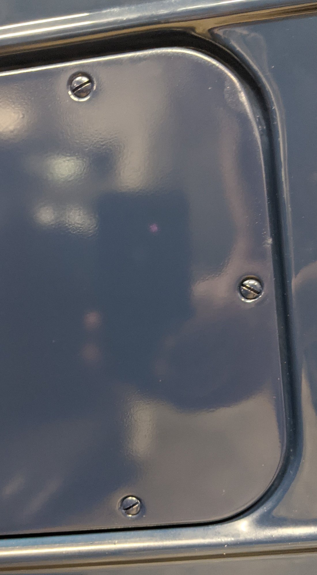

I finally got this finished up. The rivnuts must be installed pretty much dead perfect for where they need to be to line up with the holes on the door panel. I wound up grinding out 3 of the previously installed rivnuts and elongating the hole in the direction the hole needed to be in order to get all of the holes correctly lined up with the door panel holes. You pretty much have to install the rivnuts one at a time, checking the hole alignment and screw fit of the panel before installing the next rivnut. If the rivnuts are not pretty much dead perfectly lined up with the holes in the door panel, the head of the screw will not seat squarely in the presunk divet in the door panel hole, scrape the paint off, and basically look like hell. I used stainless steel rivnuts and 10/24 size stainless steel slotted oval head screws. The 10/24 slotted oval head screw style and size look factory correct for a Mercury from what I have seen. I purchased the screws from McMaster-Carr online. I like how solid the rivnuts hold the panel on without fear of ever stripping out, unlike the factory sheet metal screws which were falling out of the door panel and on to the running boards.
Door Panel Installed Using Rivnut Fasteners
Slotted_Oval_Head_Screw_Heads_10-24

Looks good!
So you painted the screw heads?

@abe Yes, Screw heads were first primed with a metal etch primer, and then painted with a custom mixed can of spray paint that matches the color of the door access panels.,
