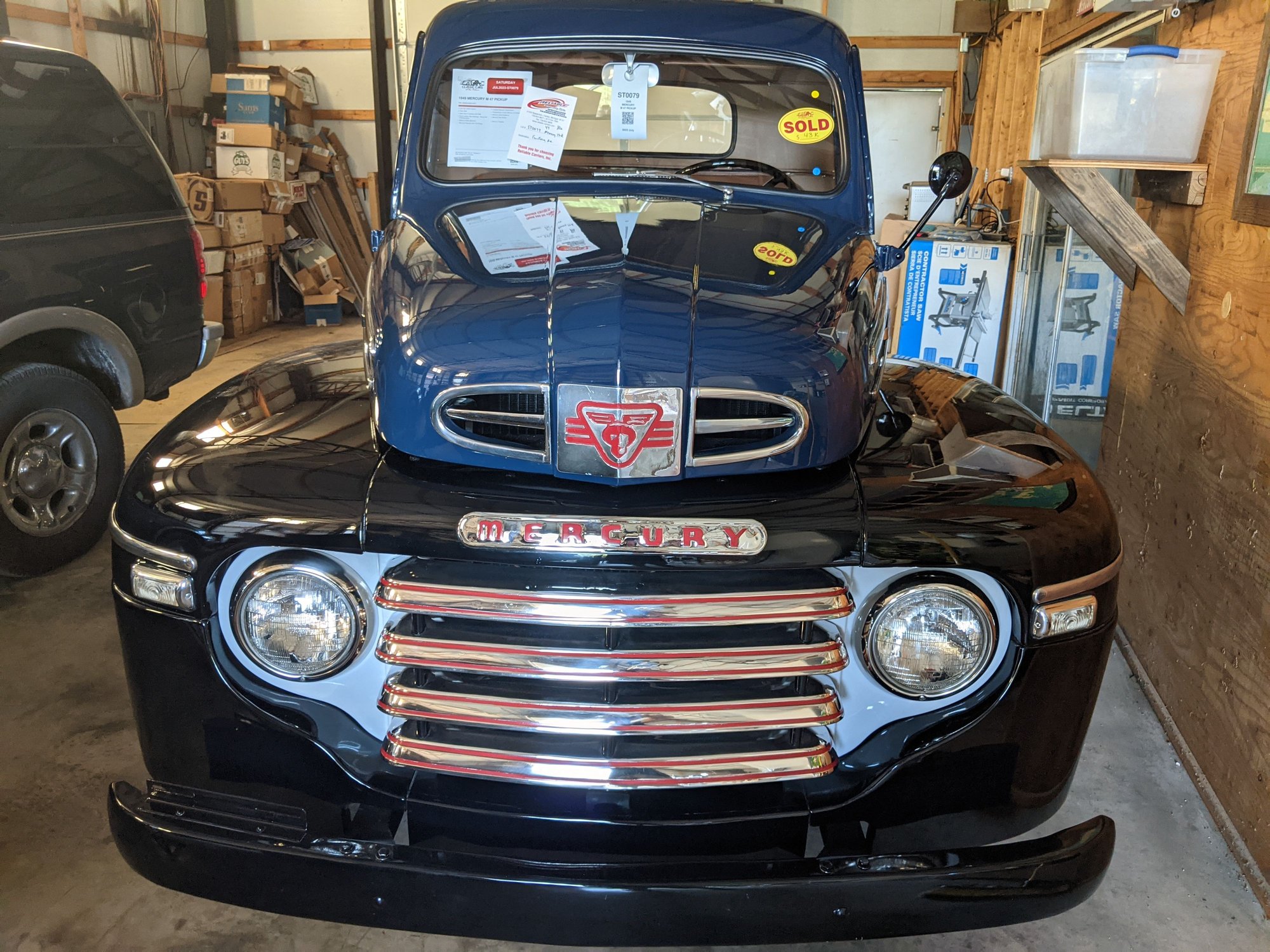

Thank you. I was thinking the flat blade screwdriver type were the ACTUAL correct ones, but it seems most builds use whatever they have on hand to get the immediate job done. That is not what I am after. I do want the correct LOOKING fasteners, just done better so as to not have to deal with the continual crappy screw thread issues that plague 74 year old sheet metal. This girl is beautiful. She has just had some horrible things done to her that give her a bad image.. I want to correct that. She is an awfully bad girl though, and she wants to do some awfully naughty things that a vintage Mercury shouldn't do...something her older cousins indulged in. :-)

She looks nice . I hope you find the factory correct screws. For my 54 I bought "the correct " door panel screws from Mid Fifty. They fit. They worked. But they didn't match the original ones.

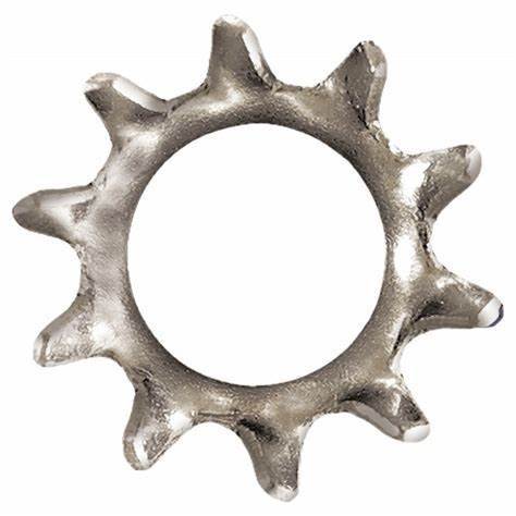

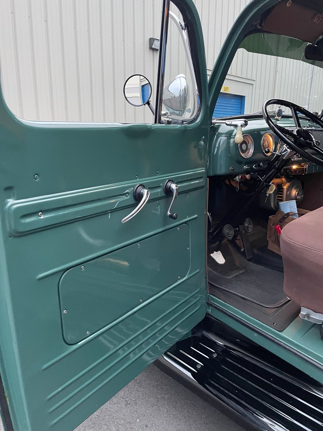

Are these the correct looking countersunk lock washer? For brevity, does anyone have a closeup pic of a 48,49,50 door panel fastened on the door with the correct hardware?

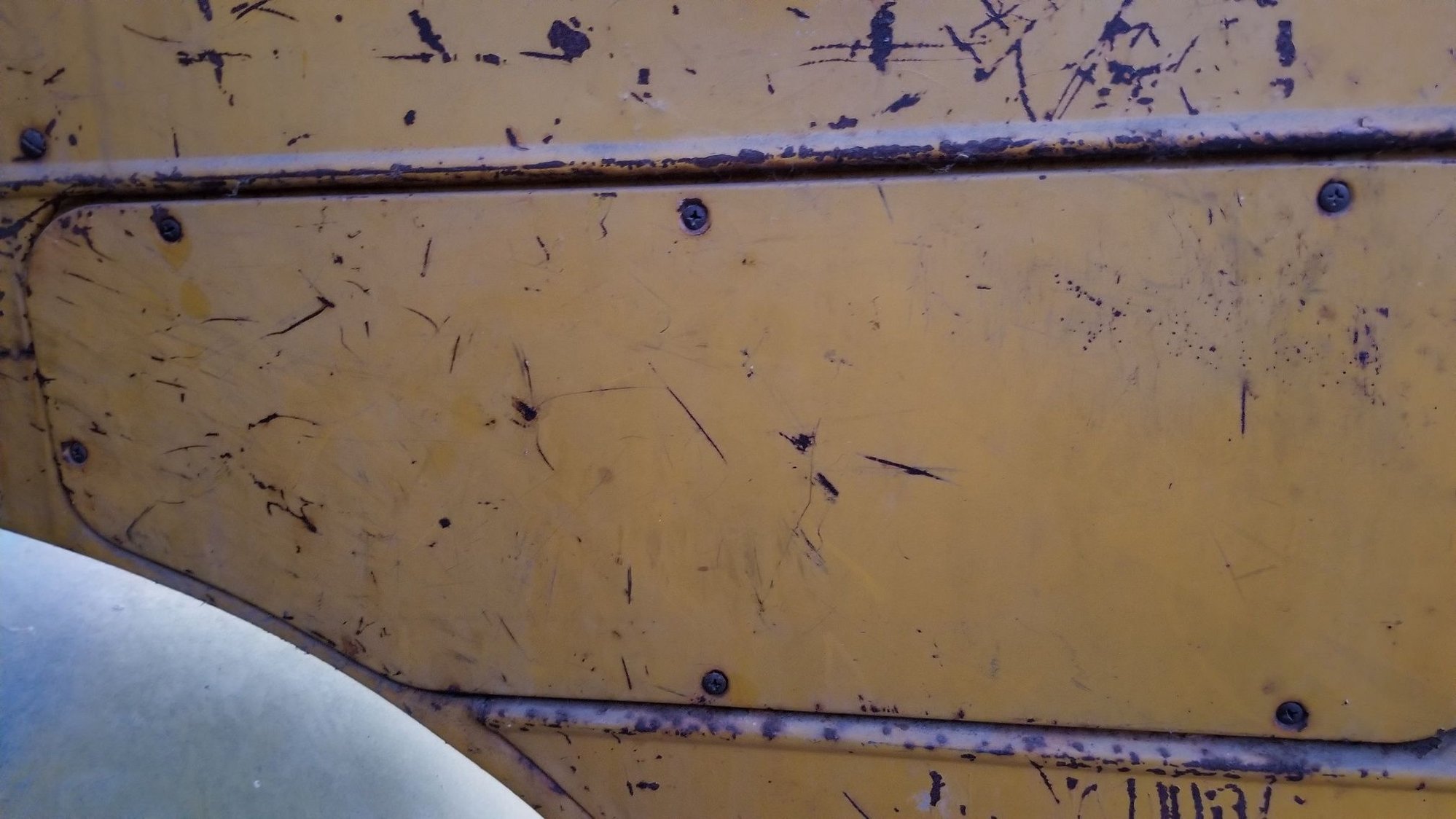

I think there may have been a running hardware change in 50. I seem to recall the access panel having the screws described above with the washers you show. I also have a 50 door in my stash that appears by all accounts to be original and untampered which shows a Phillips oval head screw with no washer.
I also believe that the panels were installed prior to painting, the panel removed for interior door assembly then reinstalled when complete. That way the doors, panels and screws would all be painted together. You can see there is no color behind the panel around the door hole.

Interesting, Wayne. So if so the screw heads would have paint on them?

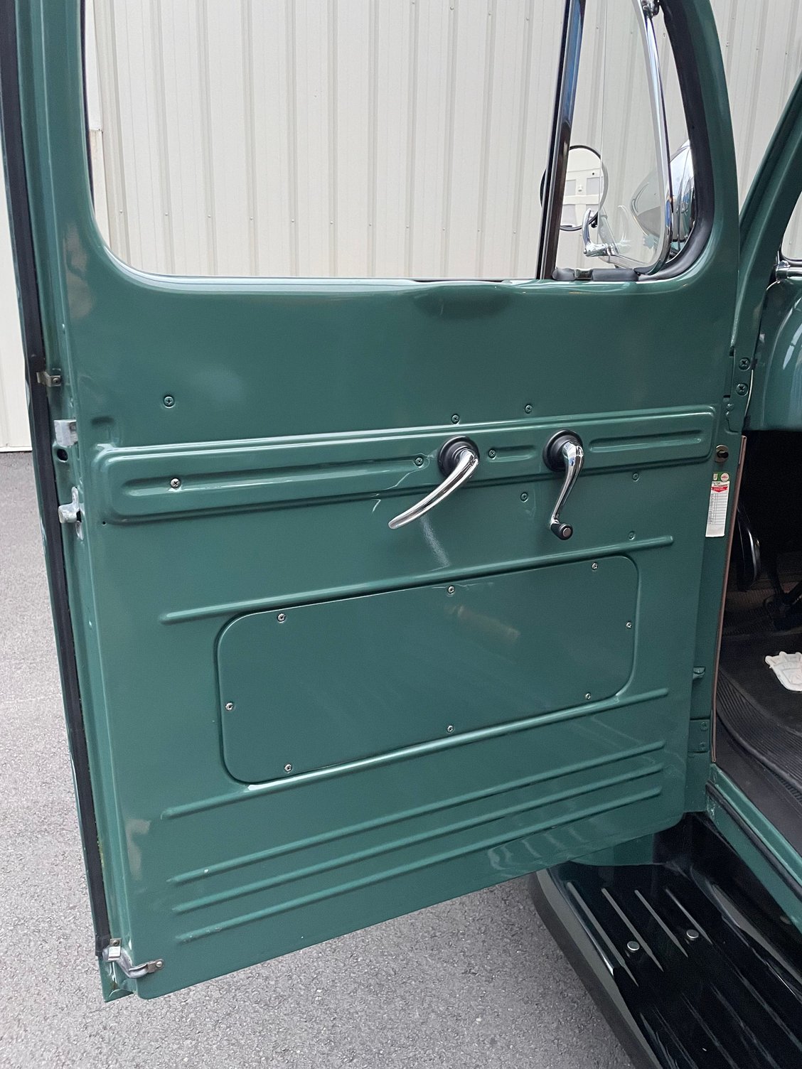

Those screw heads really seem to fill the indentations in the access panel way more than the oval head screws in my door access panels.

So I went out and checked the screws in my 48 COE. It has the same Phillips oval head screws and no washers as the 50 doors above. Maybe it was a plant thing, slotted vs. Phillips?
