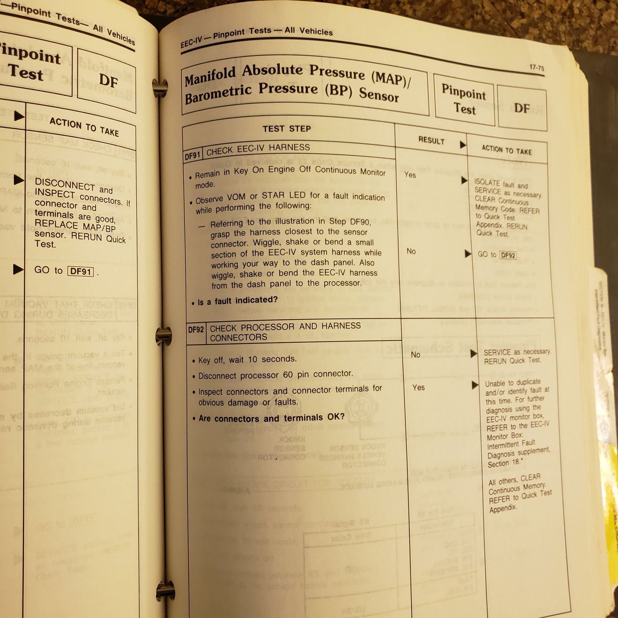

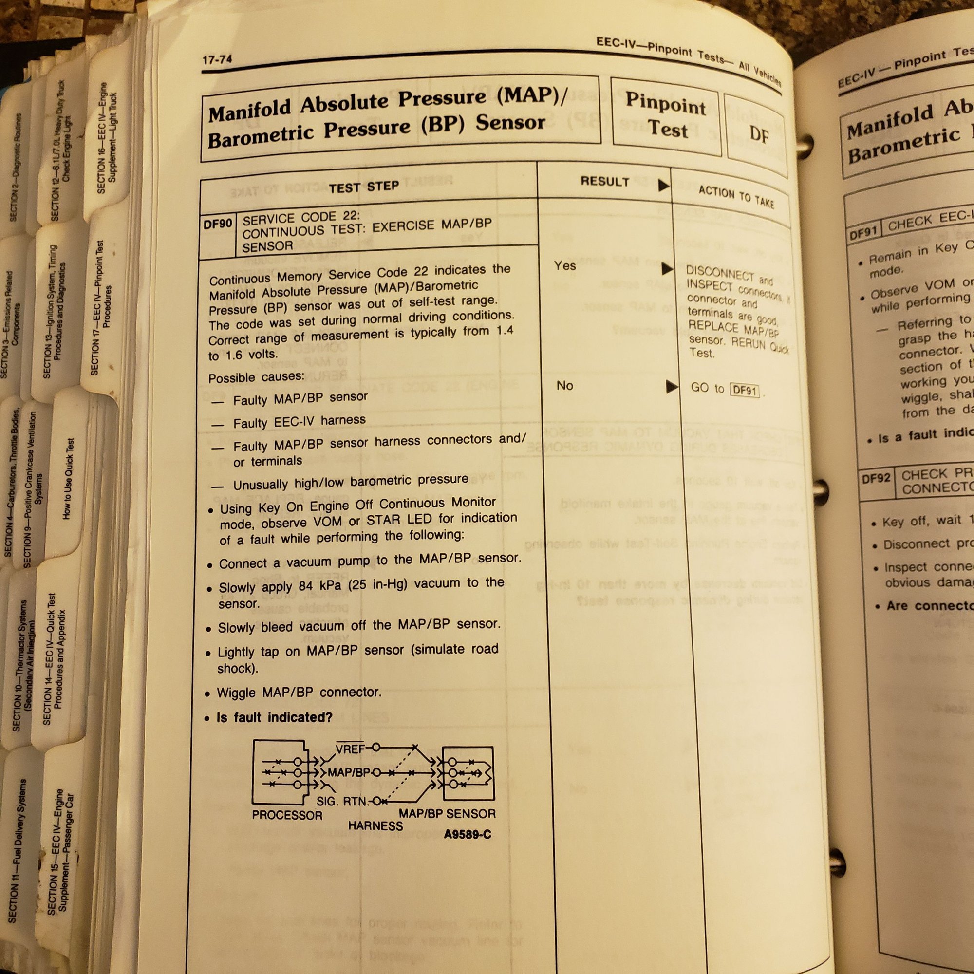

The pinpoint tests start at DF 90 for code 22.
I would start there.
Those pinpoint tests go through it all, so you do not replace the wrong part or chase your tail supposedly.
Here you are
Old Sep 20, 2023 | 08:43 AM

Old Sep 20, 2023 | 08:49 AM

Continuous monitor mode with a star tester is a way to wiggle test the wiring while watching the LED on the tester
You can painstakingly do the same thing back probing with a dvom
Good luck
