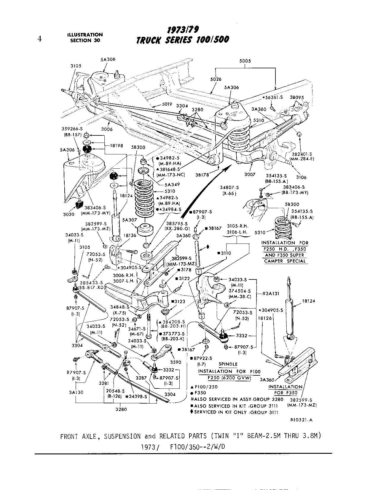

Bracket #18126 ? If so, it looks like it bolts on the radius arm?

Yes, that is the bracket. It is held on by large rivets so I cant take it off.

Rivet smivit, grind the head and knock'm out. Then grade 8 bolt it back on.
