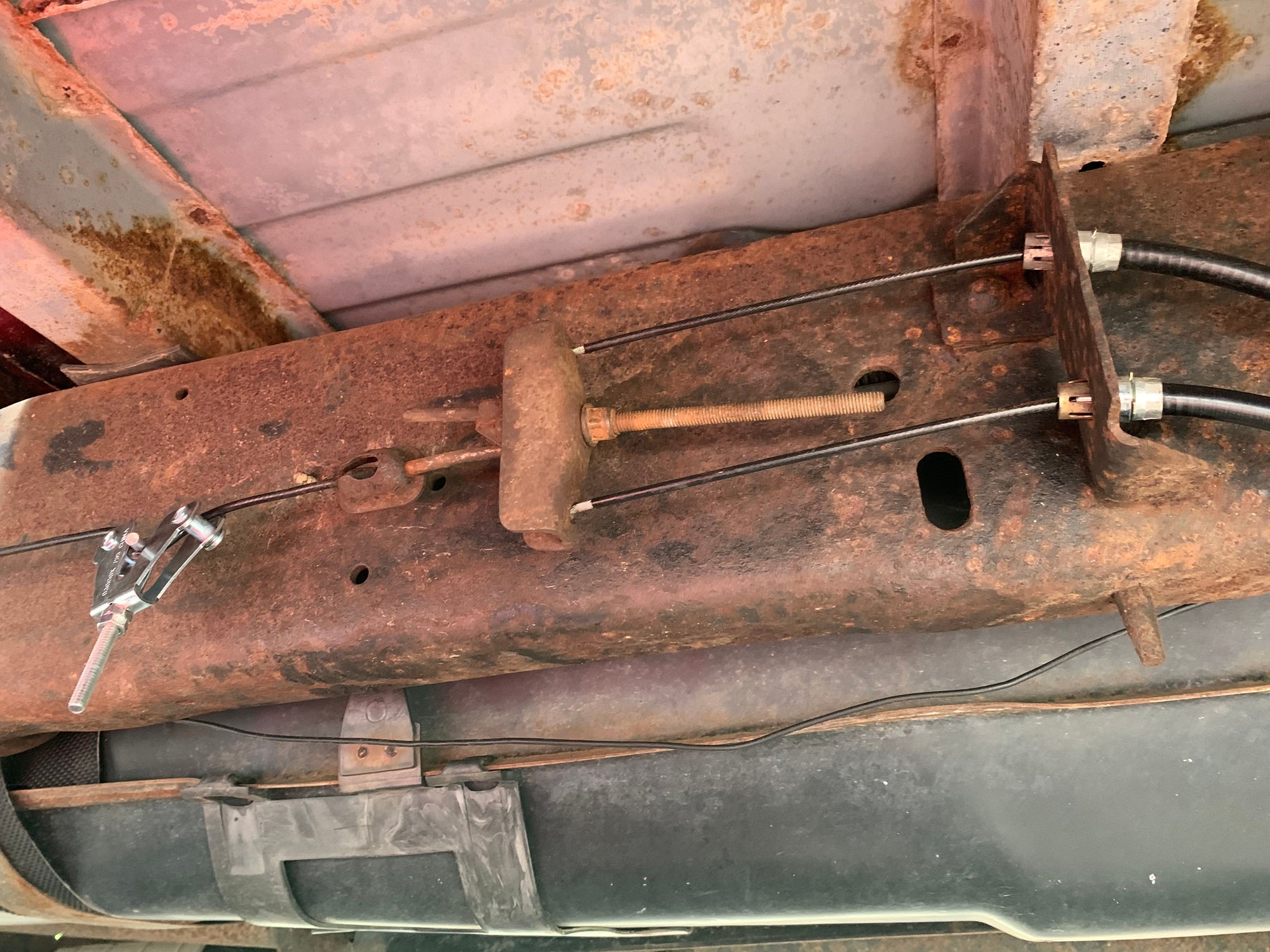

92 f250 extended cab 155 inch wheelbase
hi
trying to get ready for inspection but I’m having trouble with the parking brake.
I can press the parking brake lever effortlessly to the floorboard. I think one of the cables has stretched, but I don’t just want to go buy a bunch of cables. I bought a doorman brake cable adjuster to try and take up the slack in the intermediate cable, but it’s not enough.On my truck, there is a metal rod shaped like a J connected to the equalizer. Apparently it’s made of malleable metal made to stretch. I think it’s all stretched out. I went to the Ford dealer and they can’t find the part for me.Would anyone know where I could find this piece or is there a workaround to bypass it?Thanks in advance for any help.
Ken

Are the rear brakes adjusted correctly?

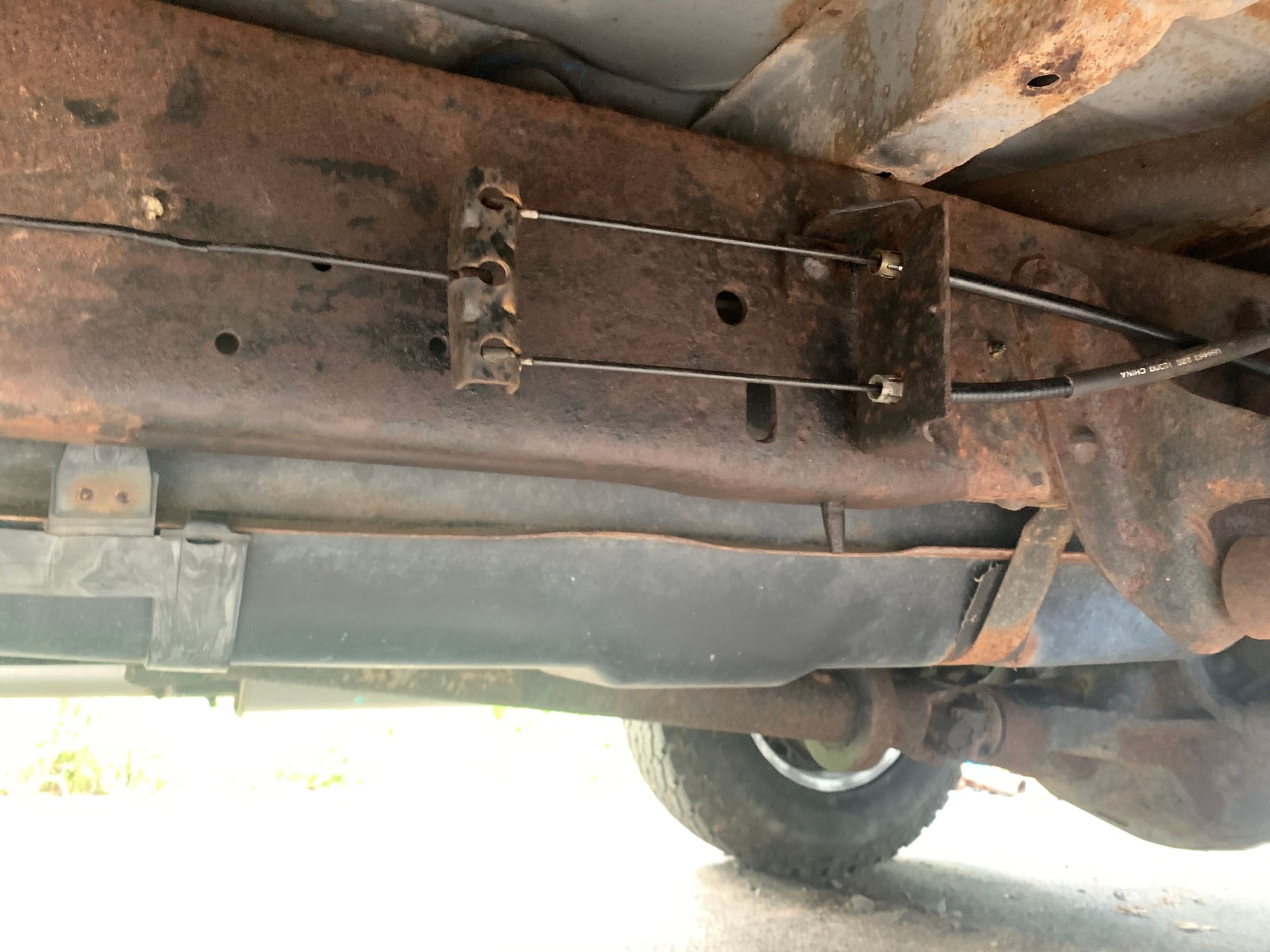

So I eliminated the funky piece and found a different equalizer that accepted three cables and now I have parking brakes.
Not sure what the long term effects will be concerning cable stretching...but we are going to find out 8^)

Hi wwhite,
Yes I had them adjusted...which added to the frustration.
I got the parking brakes working.it was all about getting rid of that slack in the cables.
Thanks for replying.
