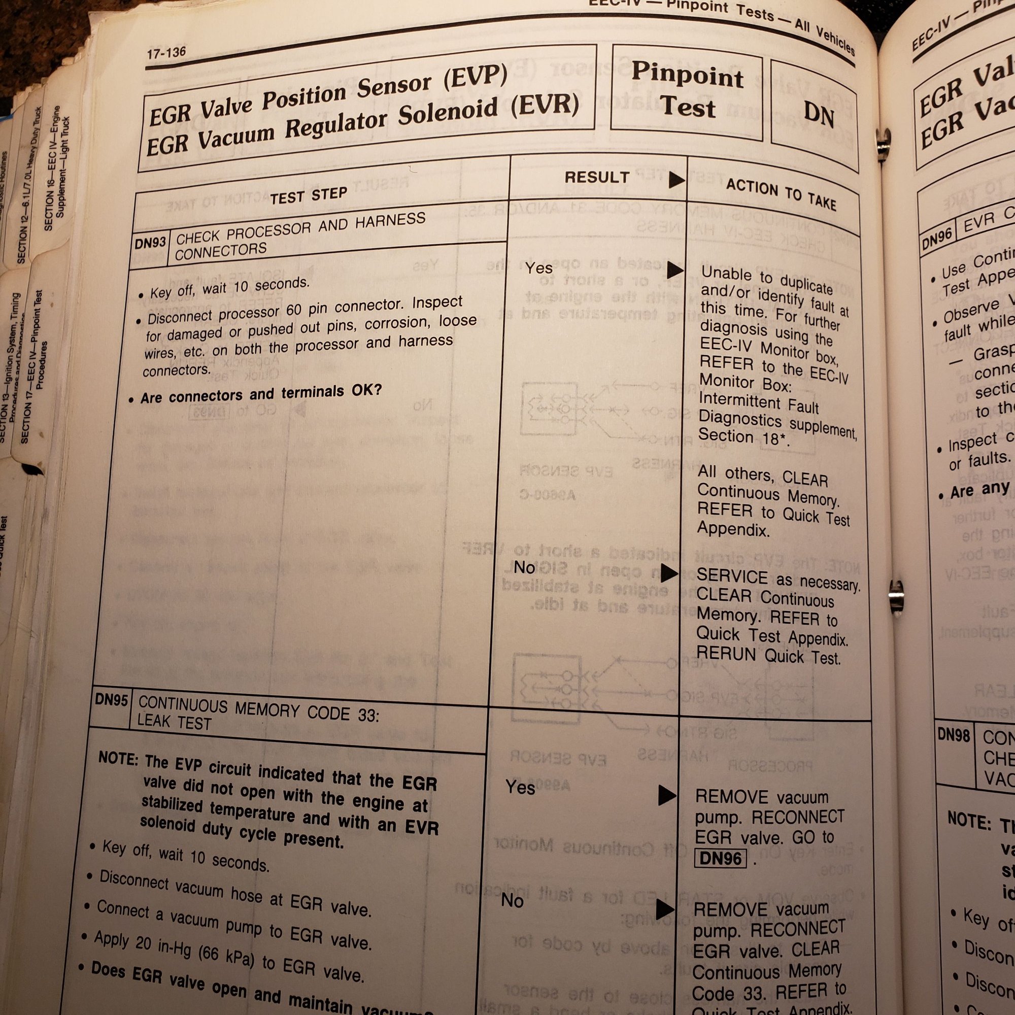

I would use the actual Ford pinpoint test steps for code 31
In the PCED
Did you replace the EVP with a Ford one?
The pinpoint tests start at DN 92 for code 31
There are only two pinpoint tests related to that code and the new EVP fixes most of them (all but the ones with wiring problems)
Here are the pinpoint tests
Old Aug 29, 2023 | 07:12 AM
manicmechanic007's Avatar
manicmechanic007
Joined: Jul 2020
Posts: 10,456
Likes: 2,630
From: Near Salt Lake City

The star tester sounds an alarm as you are wiggling wires if it finds a fault
The part where you are moving wires around in small sections all the way to the processor is impossible
Without a Start tester in continuous monitor mode
You can ohm out those wires to the processor and watch your DVOM
I think you might have a bad EVP sensor with a open circuit within
