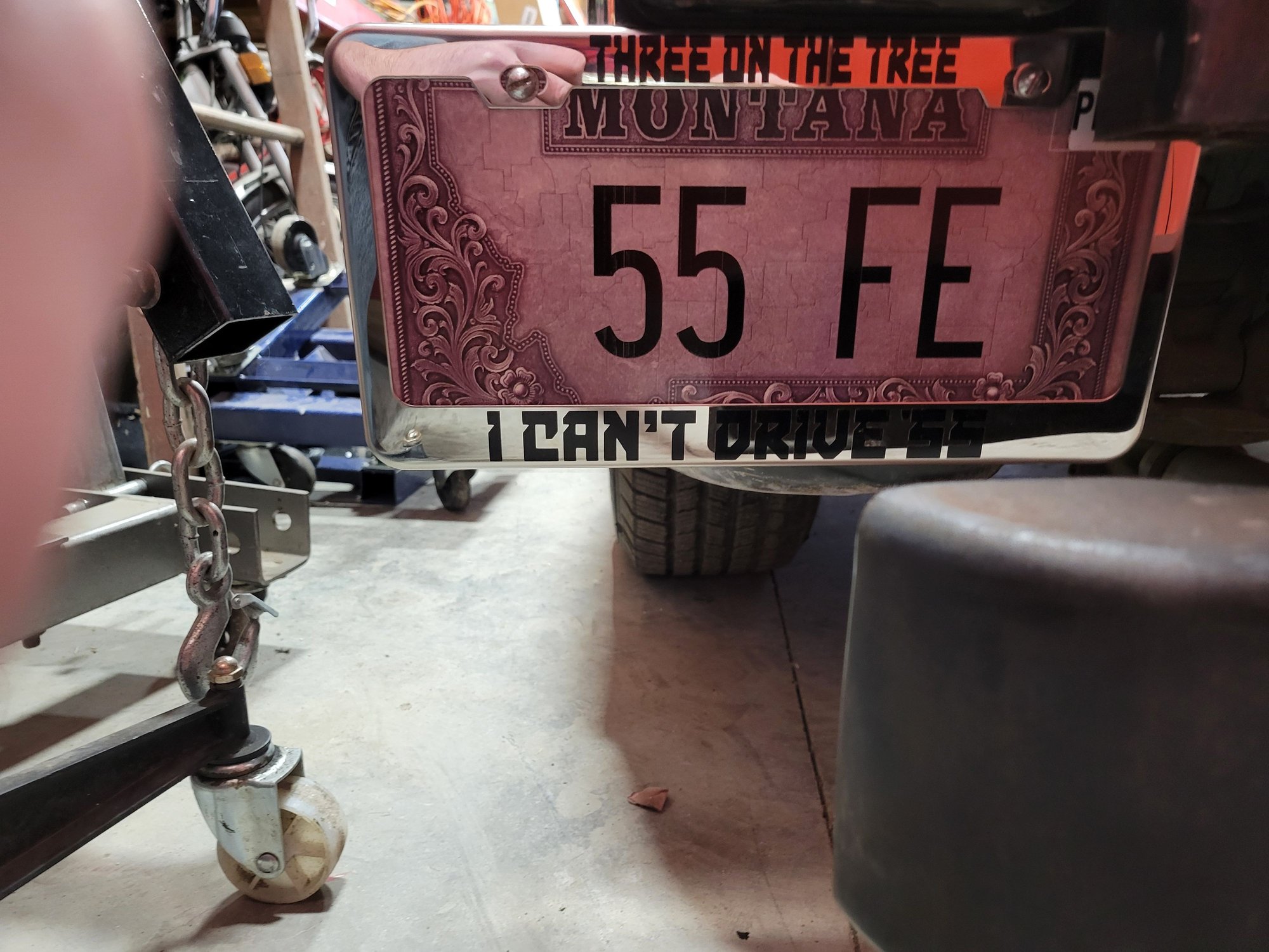

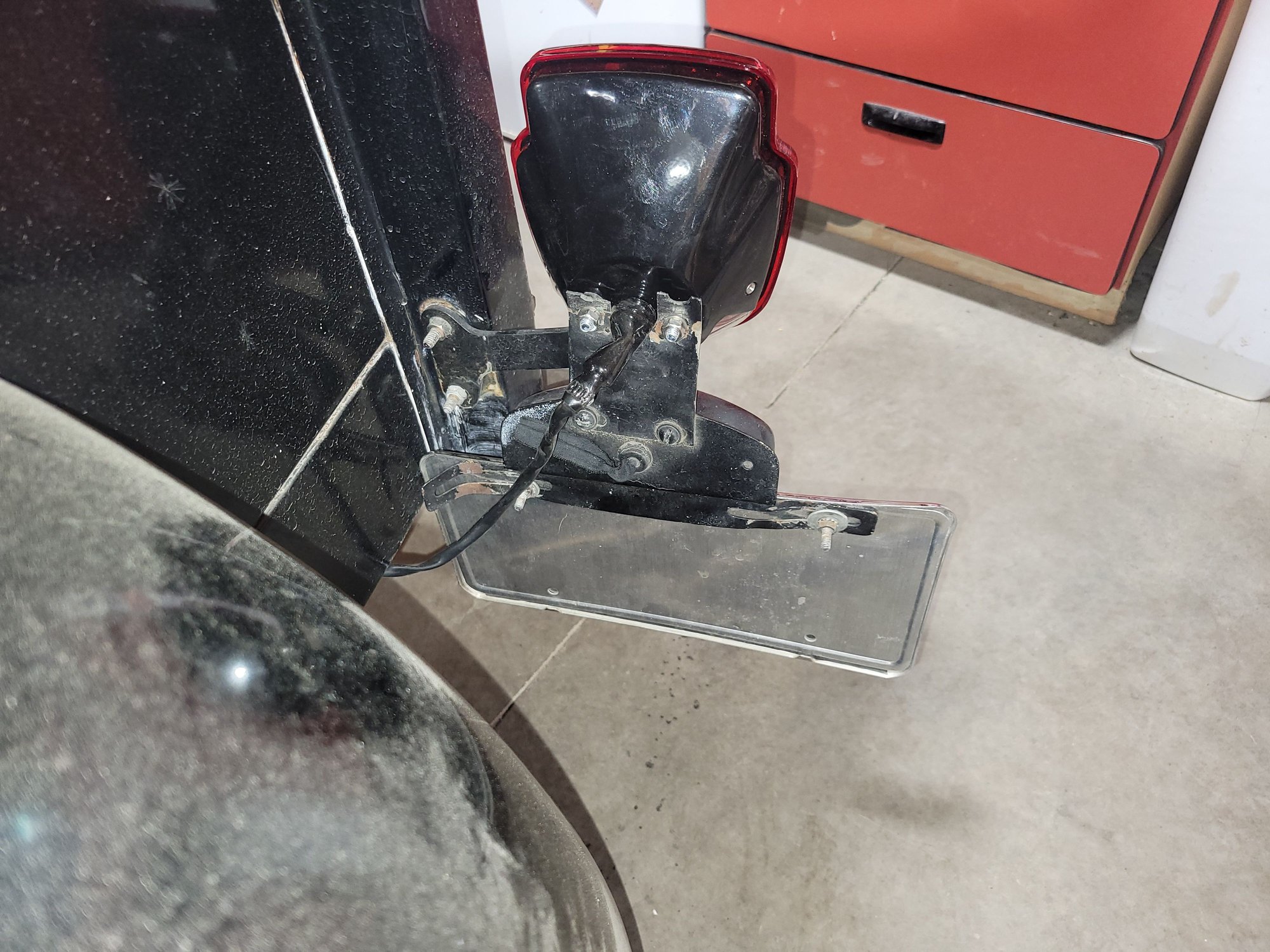

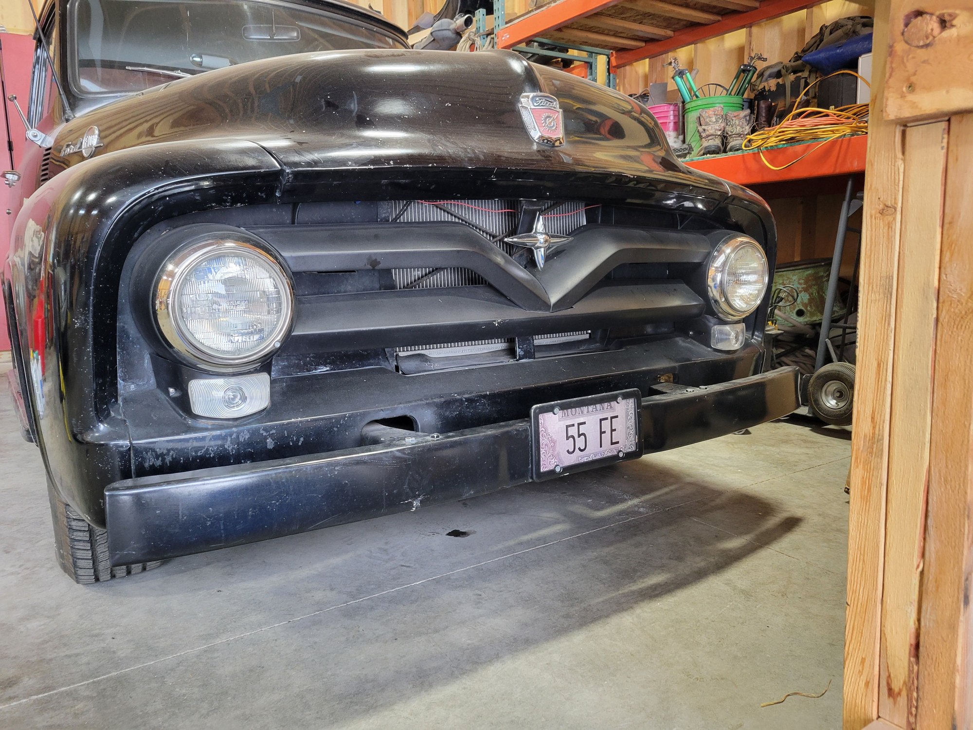

It's been a while since I've posted during the "winter wait" on car projects, but happy new year to everyone and I hope it's going well on purpose for everyone! Here are the plates...kind of a dual meaning with the FE...I also needed to swap the taillight brackets to roll upwards to clear the license plate frame..I hope it isn't cumbersome while driving or a hand hold for non-owners... I'll dress up and re-powdercoat the brackets this spring. I'm still acquiring parts, some for maintenance and some for updating, like weather seals, etc. I'm looking forward to driving this and working on it soon!
