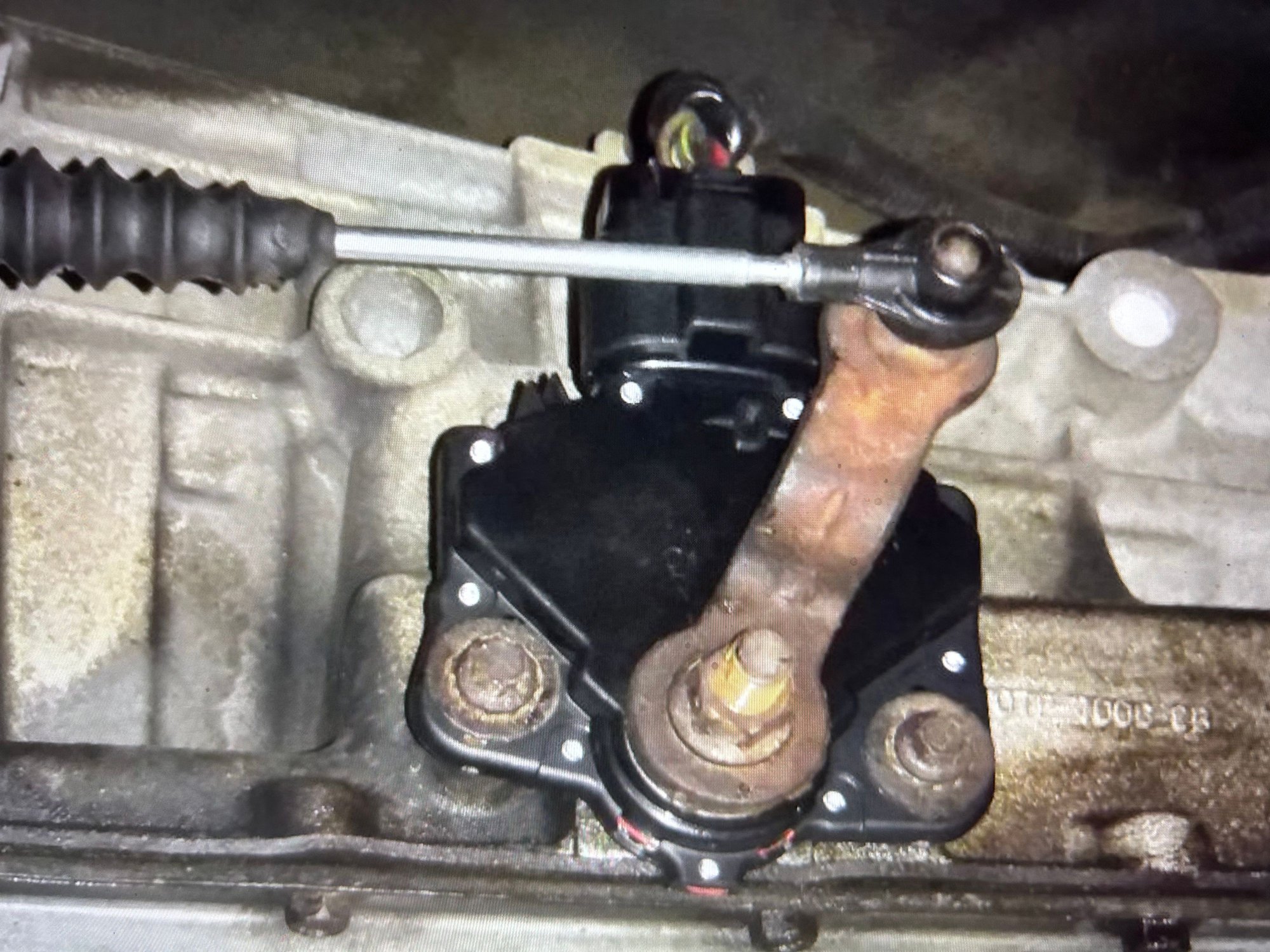

Ok, didn’t think about this, but when I put gauges in I didn’t hook uo the OEM, and the tech said it created a small issue but he replaced two sensors, one on the tranny and one near the pcm.
Bottom line shifts like butter again and the tech said that he thinks my computer the EEC is probably on its way out
The sensor he replaced on the transmission almost had to be the MLPS as we suspected.
they are pretty good at what they do and send photos of the work done.
I am assuming this is the MLPS sensor

Yes it is. That's nice of them to send you pictures.
