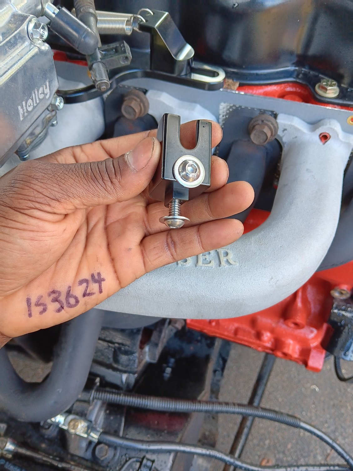

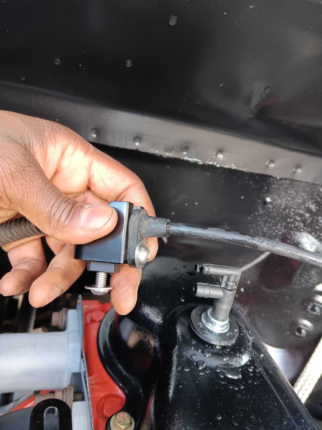

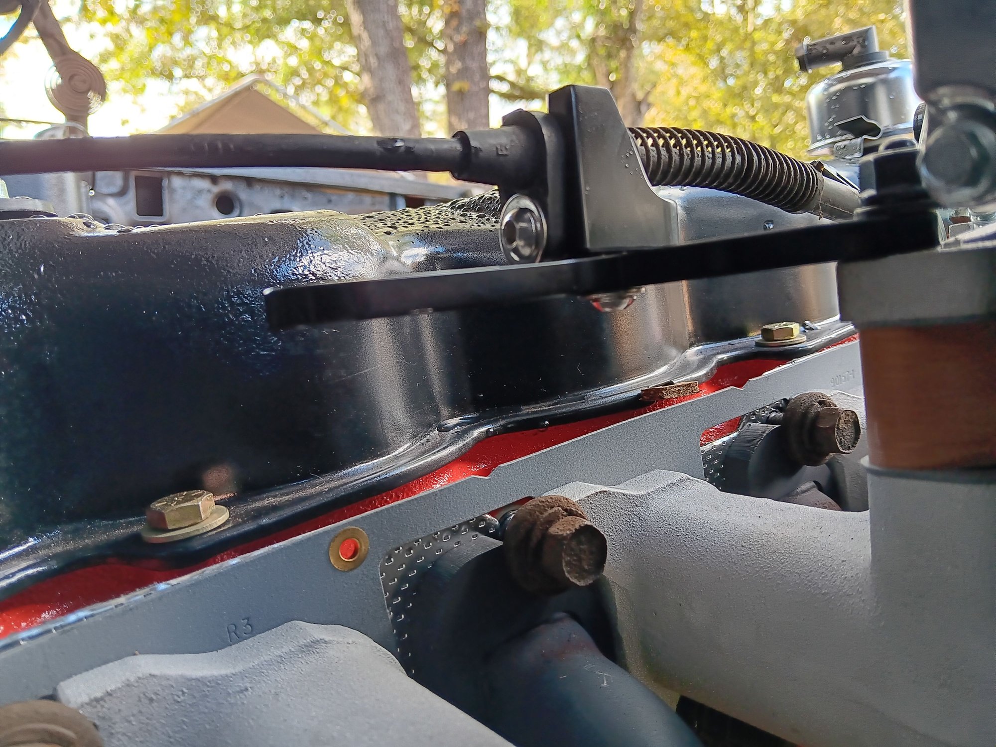

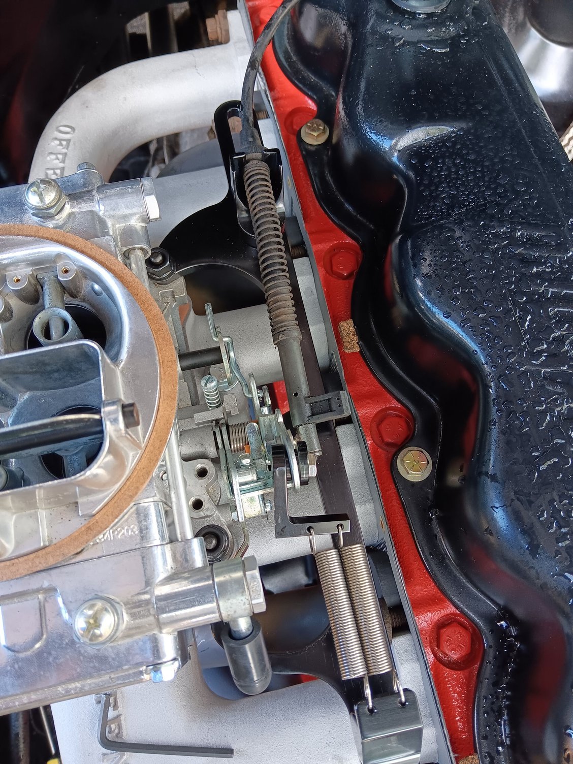

Just posting this in case somebody searches it on the future. The carb is installed. There were four things I had to buy to use it with the factory accelerator cable.
1. 1 inch carb spacer
2. Summit Racing™ Billet Aluminum Throttle Cable Brackets SUM-210239BLK
https://www.summitracing.com/parts/sum-210239blk
3. Summit Racing™ Billet Aluminum Throttle Cable Bracket Adapters SUM-210242BLK
https://www.summitracing.com/parts/sum-210242blk
4. Edelbrock Throttle Ball Assortment - 12413
this assortment works with holley carburetors. Picked up at local parts store. https://www.summitracing.com/parts/edl-12413
Ford throttle attachment
Throttle attached
Showing slot on throttle bracket
Bolted in place
Side view
Side view
Top view
