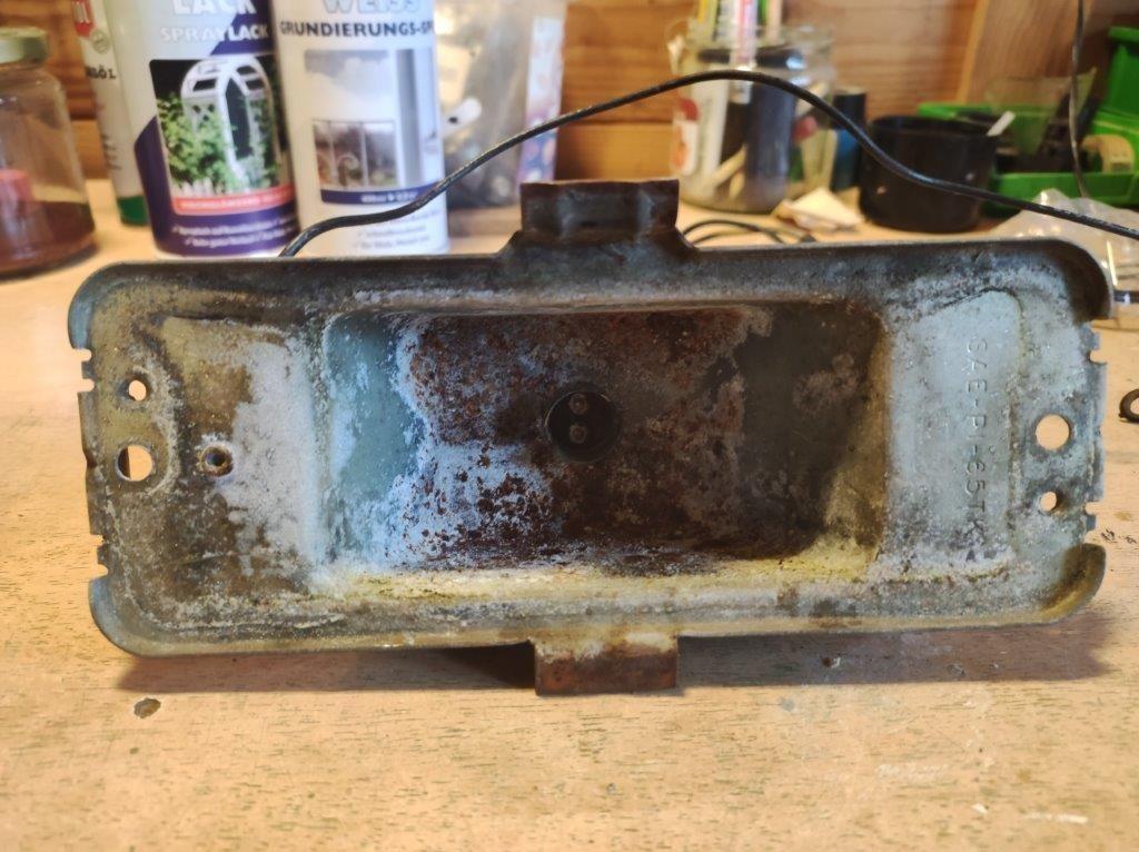

So here is the first issue accrued when removing front parking light housings. They are quite rusty and even have rust holes, so I just thought to buy new. But for what I saw here and also at Dennis Carpenter, LMC and Rockauto, there seems to be NO after marked rebuild or sub, but only some used units on ebay!? Which will become difficult to ship to Germany.....
But now I found this one on ebay: 1965-1967 FORD F100 F250 F350 Turn Signal Light Set Left & Right NEW #1086AB | eBay Has anybody any experience with this supplier/this set?
Just wonder, whether it make sense to solder the originals somehow and to repaint it, or if this set is so good, that rate + shipping ex US + tax is "better" than repair?

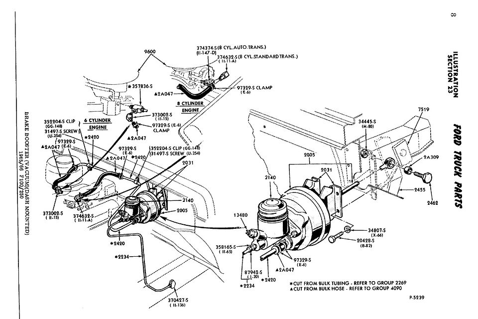

Second one: Bought a brake booster + 2 circuit master cylinder from summit racing. But carburetor has obviously rebuild in the past and it has no add. vacuum connection.
Has anybody an idea whether I can simply add. a T-fitting to the existing intake manifold fitting, so I can connect both (automatic transmission + brake booster) to this single access T-fitting?
Or do I have other, simple options I can use?

I have no experience with those lights but just looking at them I don't believe they will work very well.
What engine and manifold do you have? If it is a stock 352 there is a 3/8 NPT pipe plug behind the carburetor that you could install a vacuum tree in.

I think what you are probably asking about is this connector.
374374-S101 - Tee - 3/8" - 18 street

Hi there, many thanks for your reply. Re. parking light housing it was also my thinking, that it is worth to repair and seal the originals, instead of order these ebay stuff. Will try my best . Yes sir it is a origin 352! Your comment sounds good to me, especially as I can get adequate spare parts/fittings over here as well. Will keep you posted . Guess many answer I can also get within thousands of other threads within FTE, but just wanted to say 'hello'. See you and best regards.

Yes, something like this! So, I assume using both ports for a) transmission and b) Brake Booster should BE okay...!?

You should be able to find a vacuum tree locally. They come in a gazillion different styles and most auto makers used 3/8 NPT. even some Japanese cars. Just go on e-bay and type in "vacuum tree". And you can connect all the stuff you want to one of them.

I agree with Crop Duster. The drawing below shows what Ford did, which is what you are wanting to do so should be very okay. Upper middle of drawing.

Yes, check the intake manifold for vacuum ports, you should find one and a T fitting will work.
Not sure about the lights you posted. What exactly is the issue right now, can you post a picture? Is the housing/reflector rusted? If it is not too bad you should be able to fix it, might be some work, but can be done. Paint the inside bright white to increase the reflection. I would also go LED, but you will need a different relay which works with LEDs.

@the Dude: Ah, I see! Okay, guess I'm on the safe side then. Saw it on different pictures, but in most cases they linked it to carburetor, but as said, mine seems to be not origin anymore.... By the way: drawing you've sent is from Truck Master Parts catalog? Gues I also need to order it at LMC.... or ask you guys again .

Re. light housing: Yes there are holes inside due to rust. But I will try to fix it now. I do not trust these ebay units, I've mentioned.... Yes I already bought primer and paint. So I will try to solder it, prime it, and paint it. Below some pictures of current look....
No, LED unfortunately will not work for German authorities! The lights to the front end need to have European Union conformity and a so called "E" mark, so the "TÜV" can give his okay,and I can finally drive it on German/European roads..... (Same problem as with US headlights! Also need to swap to "E" conformity headlights). You know EVERYTHING is regulated here.... )
