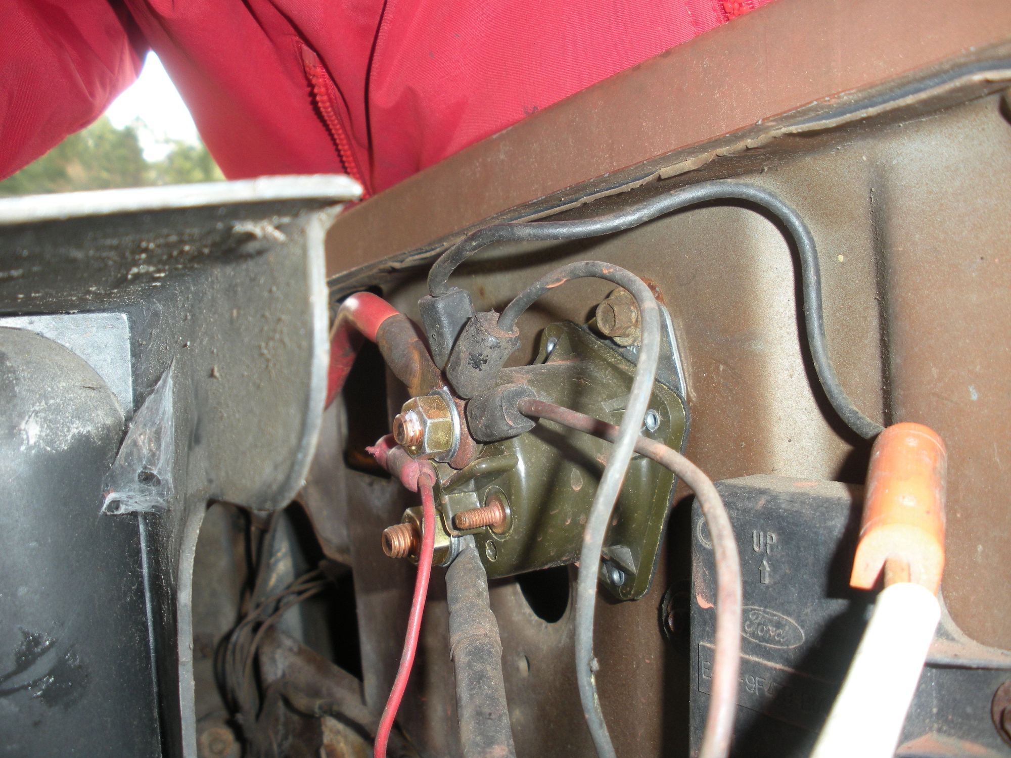

Terminal
Somebody said there is no "I" terminal on an '85 as it was changed with the electronic ignition.
Mine looks like the old Ford standby solenoid with 2 large terminals and 2 small. 2 small ones disappear into a wire bundle
Old Aug 4, 2023 | 01:30 PM
Max Capacity's Avatar
Max Capacity
Joined: Jun 2013
Posts: 5,667
Likes: 1,159
From: Tolland, CT
I think the lower stud is the I terminal. Based on my 86' 302EFI. It's not used on my truck. But I seem to recall reading that was the I terminal.
You can see the I below the stud.
Your solenoid (start relay) can have it depending on what model relay someone used. None of these trucks used the I terminal unless you have a truck originally equipped with a 460 and the hot fuel handling option.
