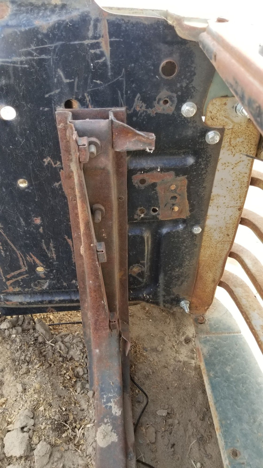

There are a lot of extra holes on both inner fender panels since the one part was used for many different applications. There are 3 sets of radiator support location holes, horn mount holes, grille mounting holes, plus the upper and lower panels, and probably a few others I don't remember. Trying to fill them may be a fools errand, as the heat from welding may warp the panels and make them look worse than leaving the holes. Be careful.

Thank you for the great picture !!!! The holes I'm talking about are the ones to the right of the radiator/support mounts Thanks again.

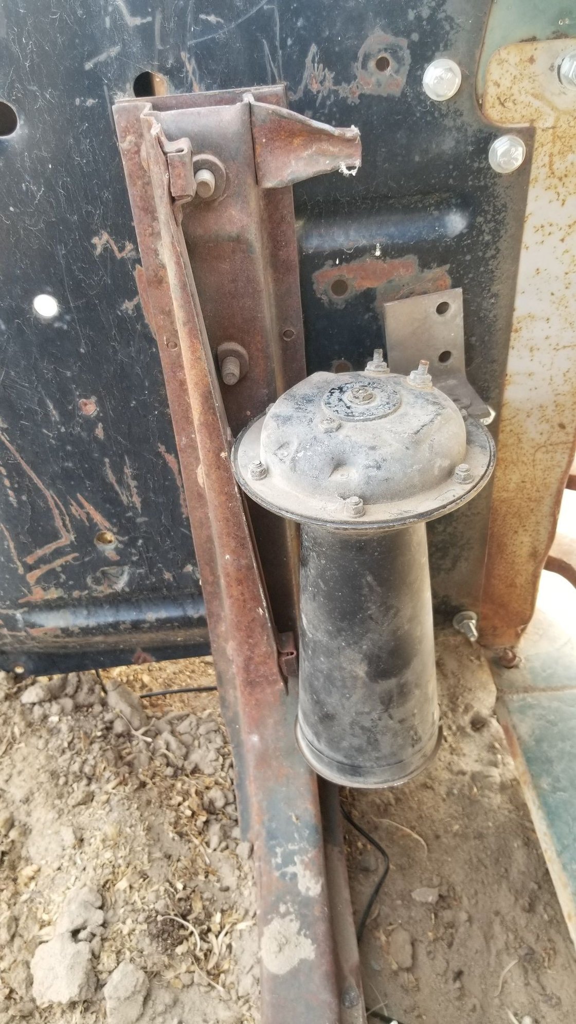

Those are horn mount holes. I think they are used dependent on which position the rad support is in. You really can't see them once the horn and radiator is in the way. Here's what it looks like, for effect, on my yard art.

Thanks again for some great pictures !
