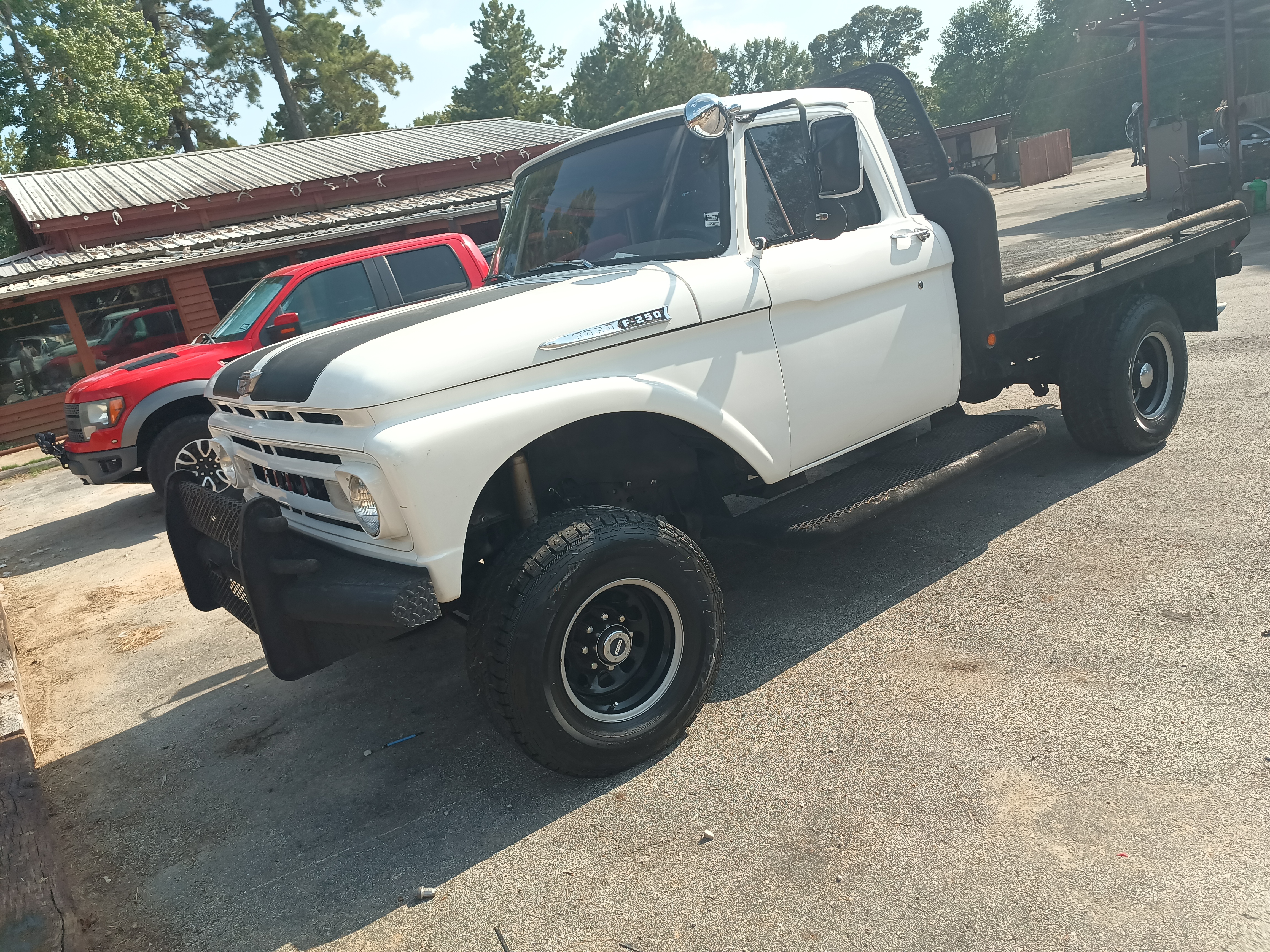

Pic of one of my grandpa's rides in return for your wisdom below:
https://files.catbox.moe/qy8bow.jpg

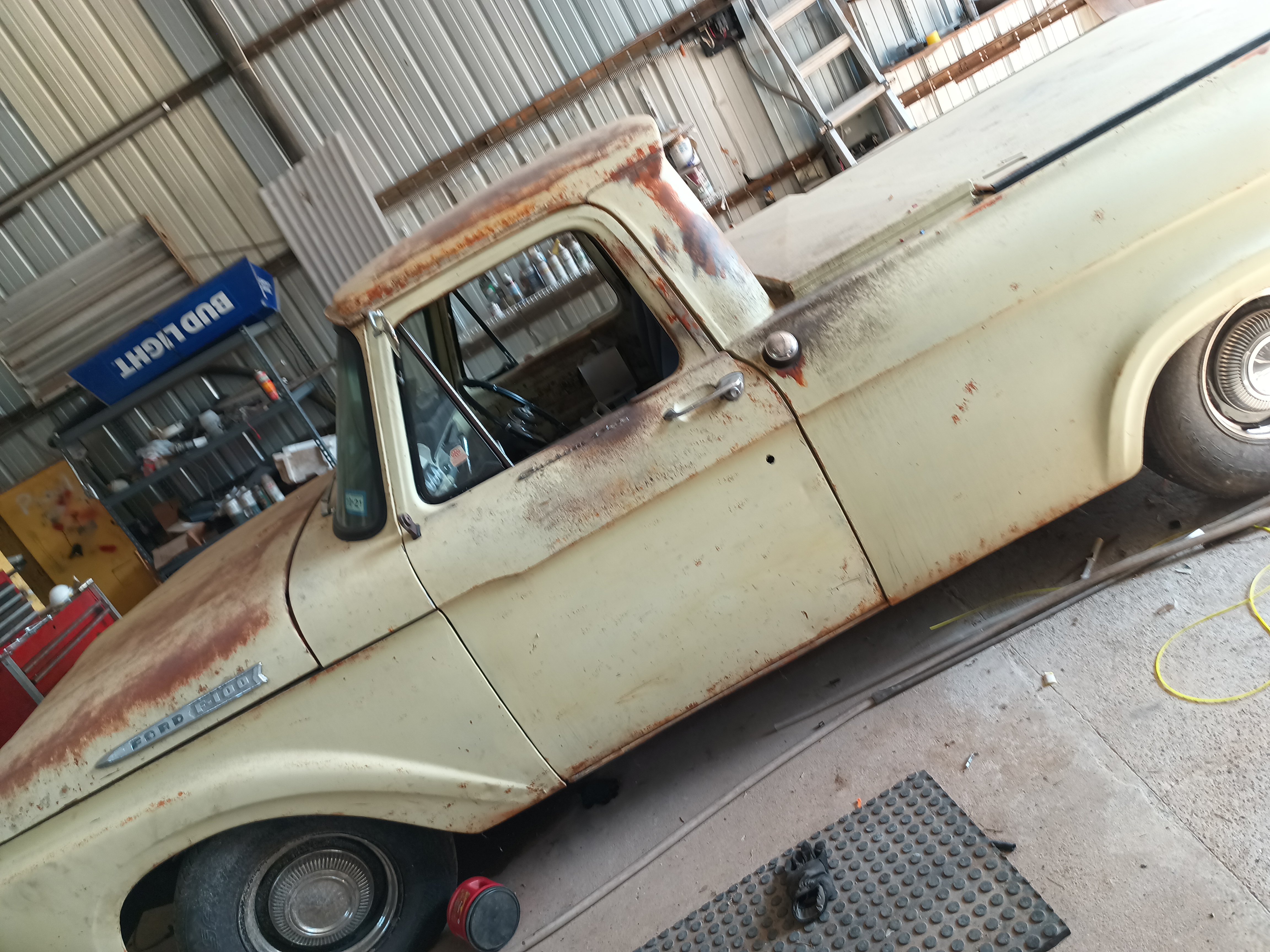

https://files.catbox.moe/hm1wao.jpg is a picture of my grandpa's 97 7.3L 4x4 as consideration for the forums collective wisdoms
