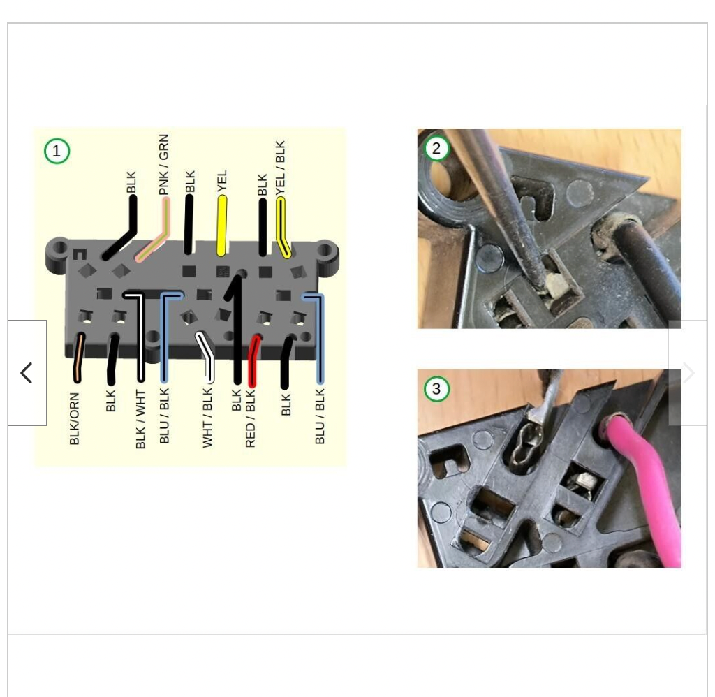

I found this pic on the connector block from a seller on eBay...this explains how to remove the wires...

got the replacement electrical block for the drivers side door. brought over all the wires from the broken one and soldered the replacement wire for the door lock that had
been foobarred. door will lock on drivers side but will not unlock. passengers side works properly. so...progress but not there yet. is the switch something that can
be repaired but is that a fruitless exercise?

Here is the new electrical block with wire fixed. JB-weld is applied to top portion of block...overnight.
wire fixed was one in top left...
