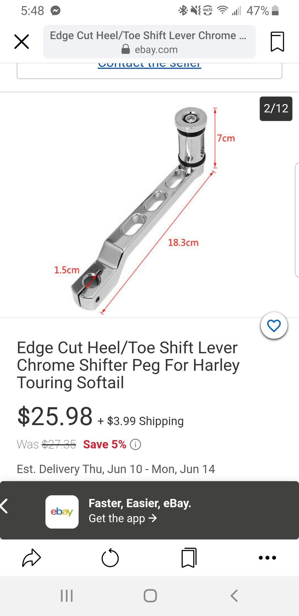

Originally Posted by F100supercrew
Wish someone would repo this type mirror would be very SUCCESSFUL and a GREAT seller. I would buy them in a heart beat and so would lot of others. If you hear anyone doing this I would be a BUYER .
Let me know anyone doing this or have compete directions and part #'s and VIDEO needed to do this mirror set-up.-- Thanks
F100supercrew see the mirror and gearshift that combined can be mounted on a 53-56'.
