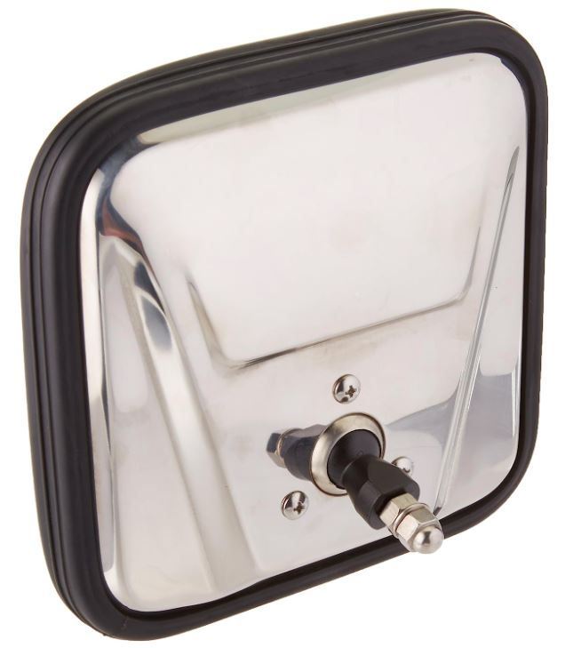

Does anyone know what this mirror is?
is it a newer mirror head adapted to the 56 arm ?

Yes it is and I had the info somewhere ... that I can't find now. I tried re-searching for it with no luck.
I think the mirror head is off a mid 70's Mustang and the threads require a insert to fit the chrome '56 arm.
I will also be doing this project someday.

Found it: 67 to 69 Bronco mirror head.
link: https://www.facebook.com/groups/1400283750234256/search/?q=67%20to%2069%20bronco
QUOTE: "if you take the stock mirror off of the arm it'll have a D shape where the set screw goes holding it in place. You make a piece to replace that on the new mirror and push onto the mirror"

I forgot to say that because my '56 is a panel truck and my old eyes need help I am going to use a bit bigger mirror head. 4.5 x 6 or a 5 x 7.

Thank you for researching this. I'm thinking about going this way because the round mirrors are terrible. The driver's mirror is usable but the passenger side is useless.

I know what I am about to show is "blasphemic" but here goes. I saw these on a 56' panel at a show Memorial day weekend here in Middle Tennessee. I actually liked them. You definitely can see more using them which is EXTREMELY helpful in a panel.
Installed with minimal modifications
1967 Chevy C10 mirror

Thanks Don, that is exactly what I am going to do, maybe a bit smaller mirror head. I think I might order two each of the above to try. Thanks for posting.

Took a vacation day and was messing around with the 55'. Ran over to the local NAPA in town and after some trial and error search with the cool counter guy located a 5×7. Added an additional nut for the set screw and tried it. What does everyone think? Visibility in the blind spot is better.
Napa part # 730-5788
