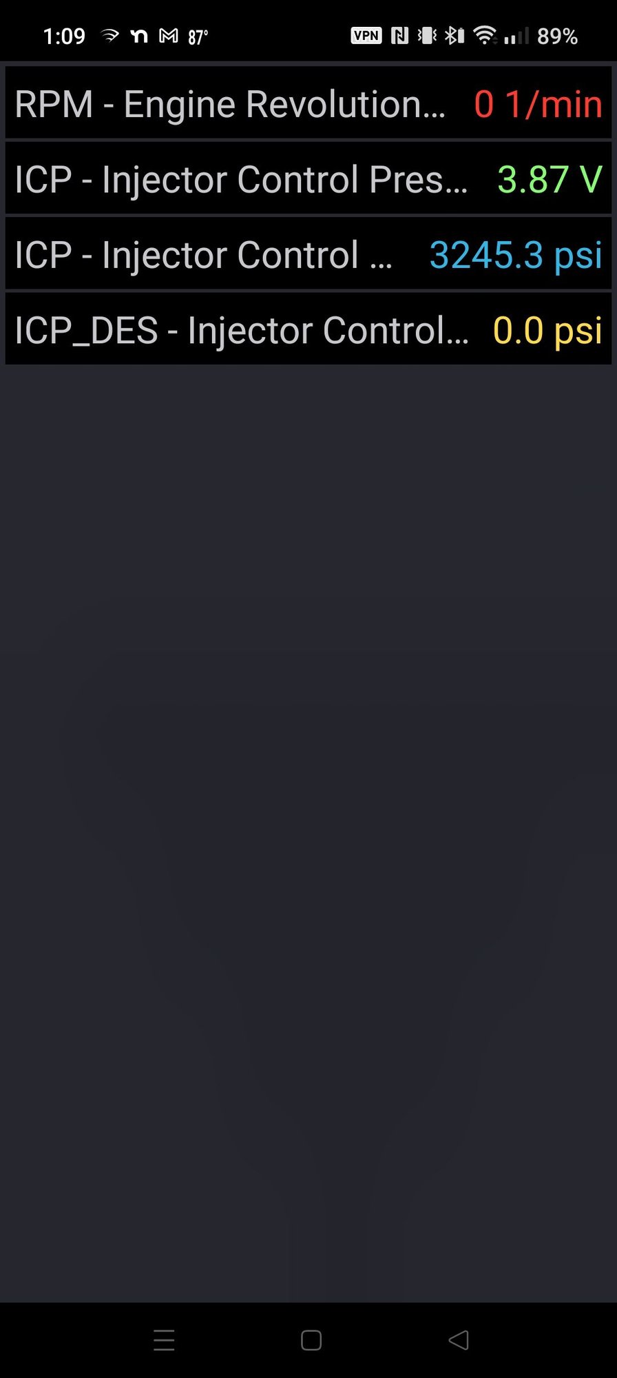

Originally Posted by Jokester00
Do you have any codes? What are those values above @ KOEO?
With those numbers, I'm in the camp of "something is wrong" as well!
-jokester

I think he is aware of the symptoms and the data. Question is - what are YOUR plans?
You have been given a couple of directions to explore. We aren't able to identify the specific issue unless we get lucky with a guess. You, on the other hand can do some testing and inspection.

KOEO?? Just what I expected...something's wrong alright LOL
UNFORTUNATELY, your ICP sensor is kind of a pain because it's behind the turbo on the HPOP with your IPR. FORTUNATELY, that is where you're headed anyway, so...
If I were you, I'd pull the necessary crap out of the way to get to the IPR & ICP. First, disconnect the ICP sensor and see what the above PIDs read KOEO (ICP, ICPDes, and ICPv should all be 0). If they are, try to start the truck. If it starts, i'd replace the ICP sensor and pigtail. If it DOESN'T start or the above values AREN'T 0, you might have to change the ICP pigtail anyway to get there first. However, I would also pull & inspect the IPR (you're gonna need a special socket). Suspecting a short in the ICP sensor or pigtail like @bismic mentioned earlier (03 & 04's are known for this).
Another thread as a good reminder to have a known good IPR on hand for troubleshooting...
-jokester

Well, I'm going with option one...Electrical short...Squirrels is my guess...
I swear I've been driving it every week or two...
They chewed up the wire loom and some of the sheathing around the power wire.
Then I noticed one of the little ****s made their way back here. This is where the harness branches off to the ICP sensor...

This is why the ICP sensor volt request was made so early in the thread!
