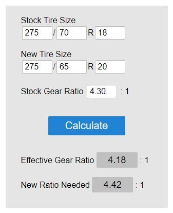

@GAZZILLA thanks for sharing that tire.com link. I agree with others that actual tire OD might vary some from one 20" tire to the next, but those calculators do easily give you an educated guess. I never actually calculated what my 20" tires did to my 4.30, but their calculator suggests I have a 4.18 if I plugged the right numbers in.
