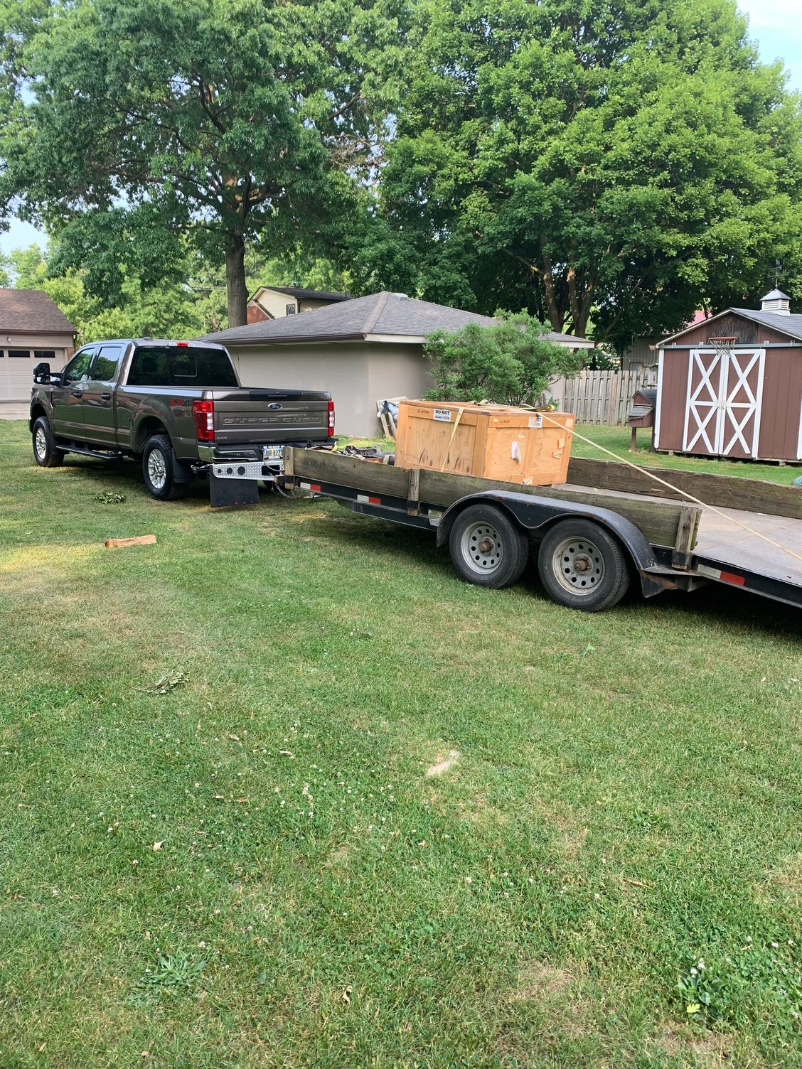

12,000# in the trailer and 2,000# camper in the bed. 3.55 with 10th locked out. 9.7mpg at 65mph and then 9.3 mpg at 65 mph up over the rocky top pass in Tennessee.
now running no camper and an empty trailer. 12.4 mpg running 75 mph and it holds that 10th gear just fine
