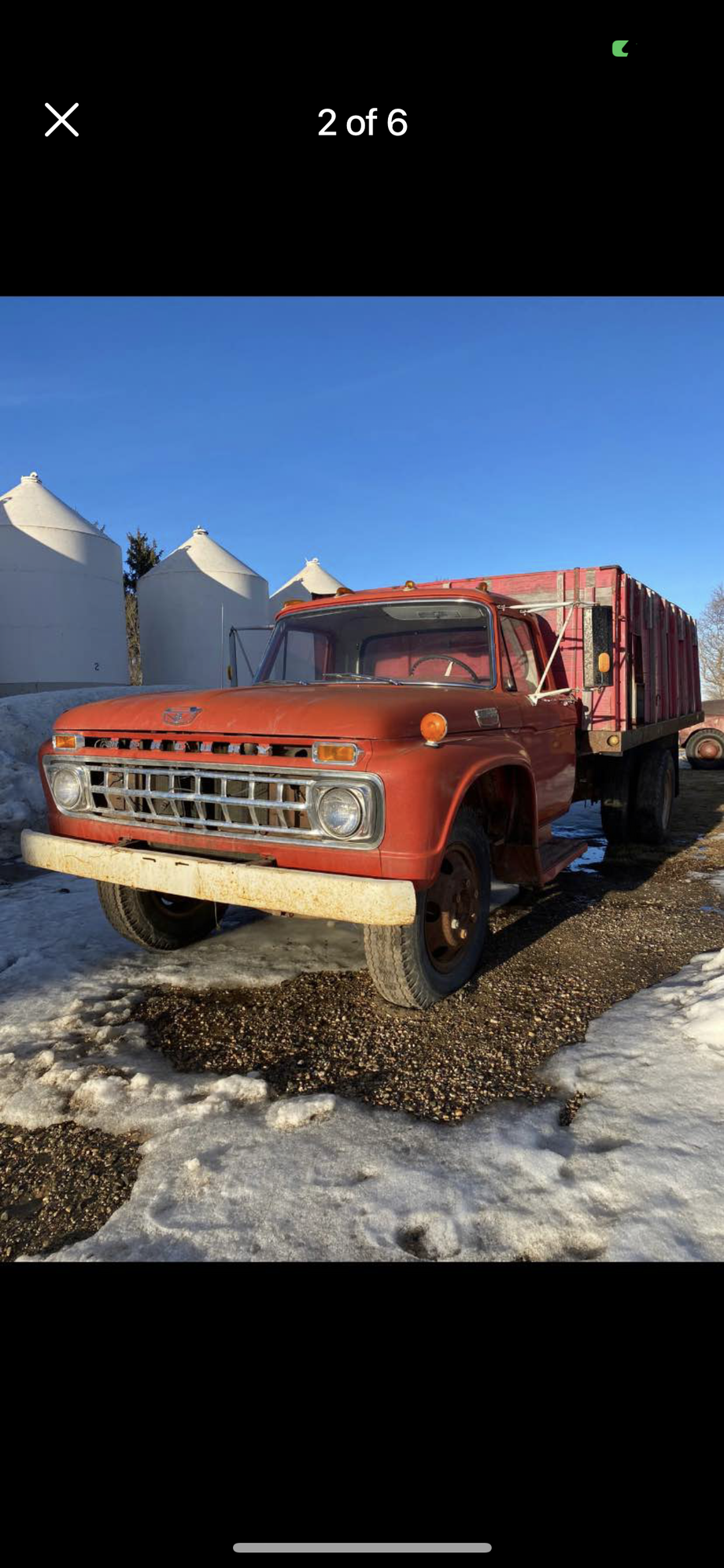

Found a real nice 3 ton and wondering if the cab is the same as the 1 ton. I have a 1965 M250 4x4 and would like to use the cab and doors and hood off of it if I could. The fenders are different obviously. Did they come with a 352 or just with the 330 FT.

So the cab will not fit then?
here is a pic and the warranty tag. It’s a mercury so engine code is sn which is 330 medium duty ft

It will fit, the '61-'66 F500-F600-F700 cab is essentially a '61--'66 F 350 ;61-'66 F 250 4x4 cab,'61-'65 F 100 4x4 cab, similar steering column, high floor inner step and battery box location ('61-'63's do have a lower roof line though) Super clean grain truck! Hate to see it parted, but anything goes when they get sold. IMO, the 330 was a great engine for light -medium truck service, should have been an option on the '64-'66 F 250 4x4's and F 350's. U Haul special ordered 330's in mid to late 70's F 350's for extra durability instead of the 360's and 351M's ( 360 almost identical in construction to 352's.) The grain truck should have the same 4 spd as your F 250 4x4 , the NP 435. U Haul F 350's with 330's also came with NP 435, a very durable trans.

Here is the Warranty Plate.. It’s a Mercury so engine code is SN which is 330 2V Medium Duty FT
1965 Canadian VIN & Warranty Plate
1 = V8 engine
81 = Conventional Cab
60 = M600
74 = 174" Wheelbase
L = Left Hand Drive
225496 = 1965 Canadian Numerical Sequence of Assembly, the trucks specific serial number
F = 19,500 - 26,000 lbs. Gross Vehicle Weight Rating range
05 = Red Crush Vinyl & Red Wicker Pattern Vinyl - 81A Standard Conventional Cab
RR = Rangoon Red
Eaton model 13802 Two Speed Rear Axle / 6.33/8.81 / 15,000 lbs. Rear Axle Capacity
M600
174" Wheelbase
20,000 lbs. Gross Vehicle Weight Rating
SN = 330 2V Medium Duty FT engine
New Process 435 4 Speed Manual Transmission ~ Reverse is down - towards the seat
1965 Canadian Auxiliary Identification Plate
C4TA-7004-AA = Ford Transmission Part Number = New Process 435 4 Speed Manual Transmission
89 code = Ford Front Axle with 5,000 lbs. Capacity
C5TA-4006-C = Ford Rear Axle Part Number = Eaton Model 13802 Two Speed Rear Axle / 6.33/8.81 / 15,000 lbs. Rear Axle Capacity
