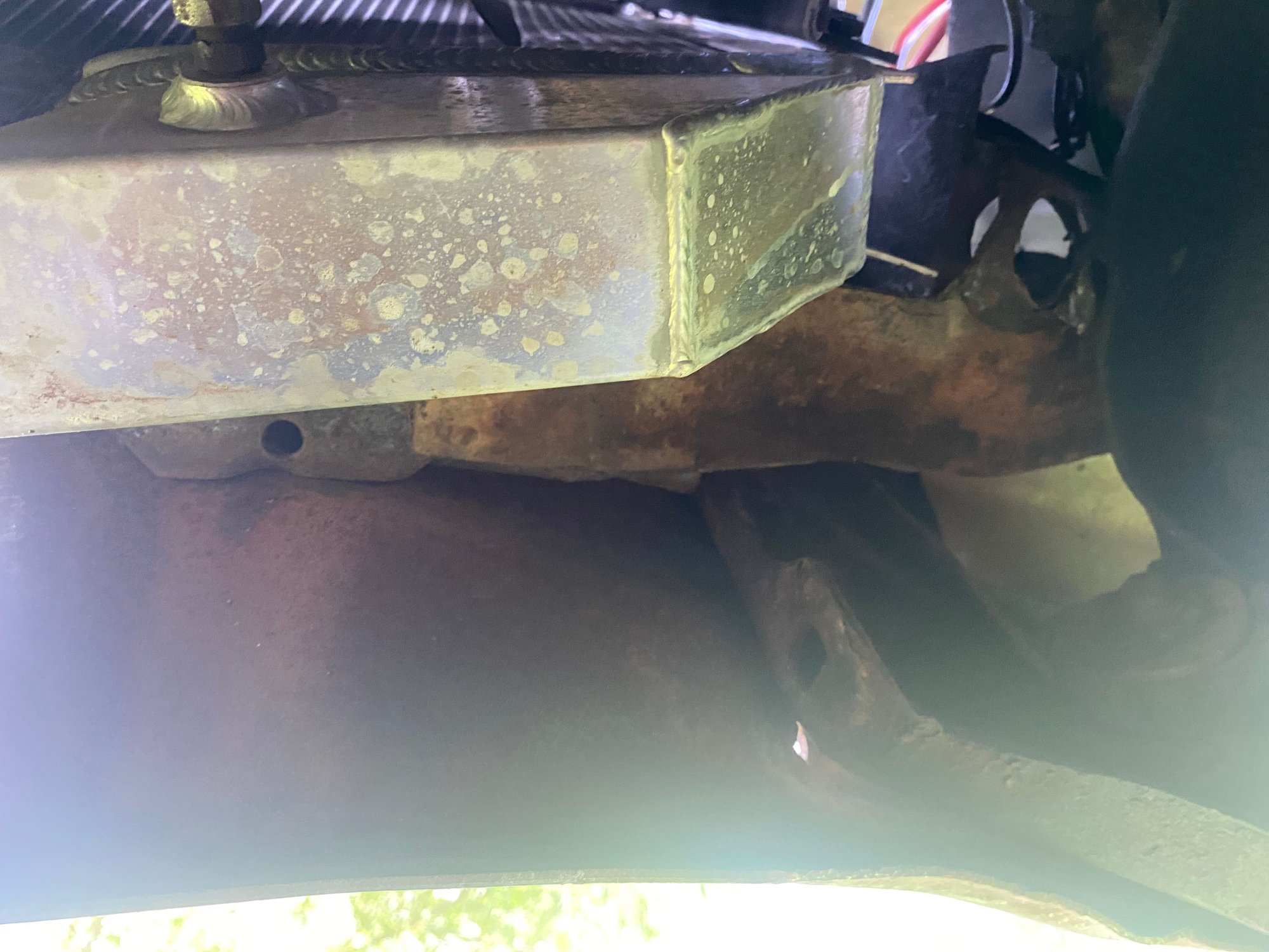

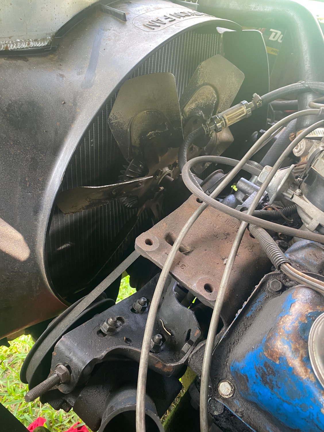

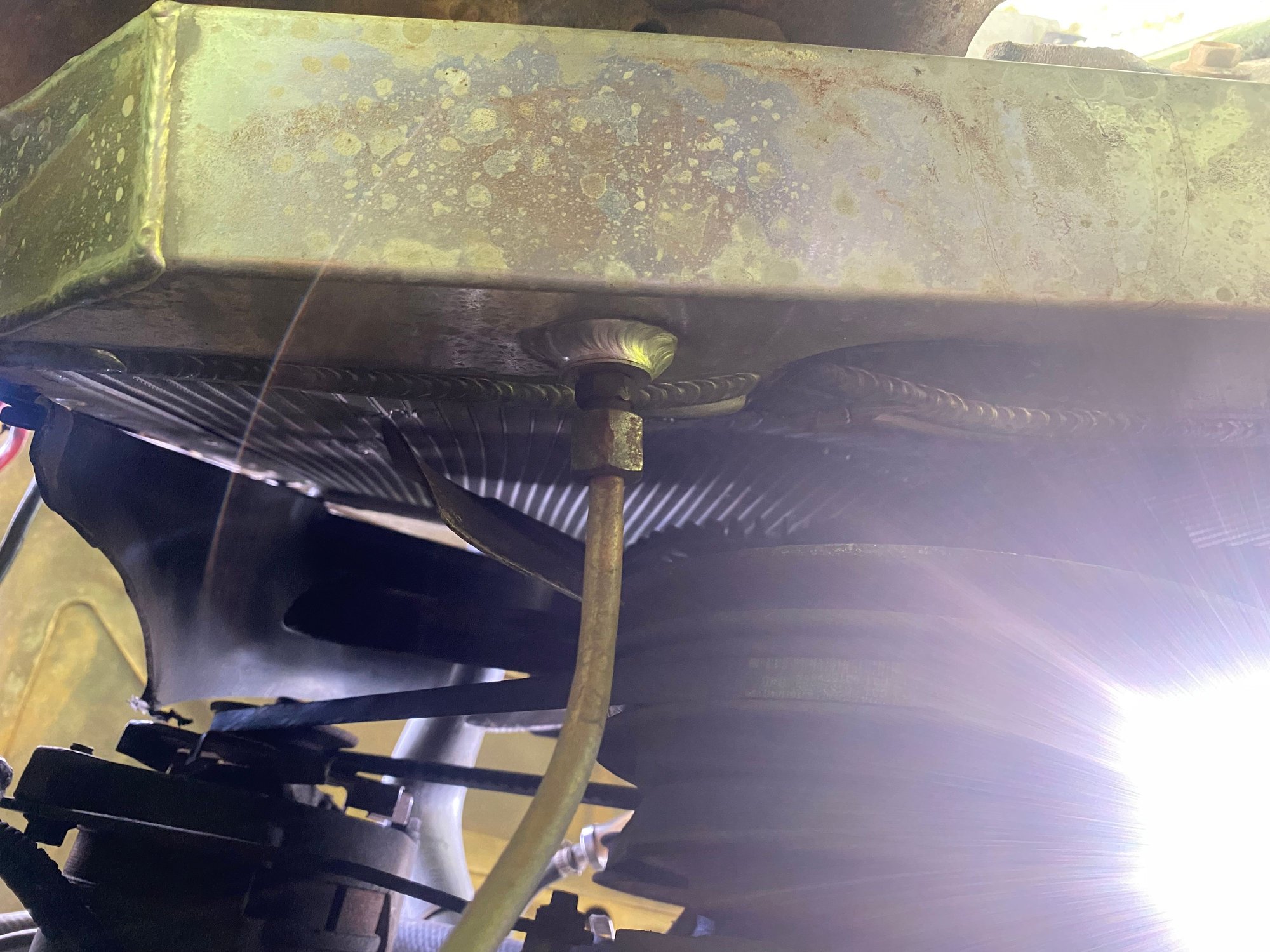

I don’t know how well you guys can see it but this is a photo of the passenger side frame horn it is bent in all the way I’m getting ready to have it towed to a body shop to get a quote

It looks like the bumper and frame horn absorbed most of the force. The radiator was not pushed into the fan as mine was. Both of my frame horns were mangled, especially the driver side. How much of that force was transmitted to the frame further back can be hard to detect. There are also confounding variables such as the effect of power steering in the frame. The PS can cause warps and tears in the frame w/o having an accident.
We all hope that you luck out with readily fixable damage.

If the fan clears the radiator, pull the belt and spin the fan, you and the shop can drive it.
I think you said the tire hits the fender and if so can you pull it a way so it clears.
This will save you some money on the tow to & from the shop.
