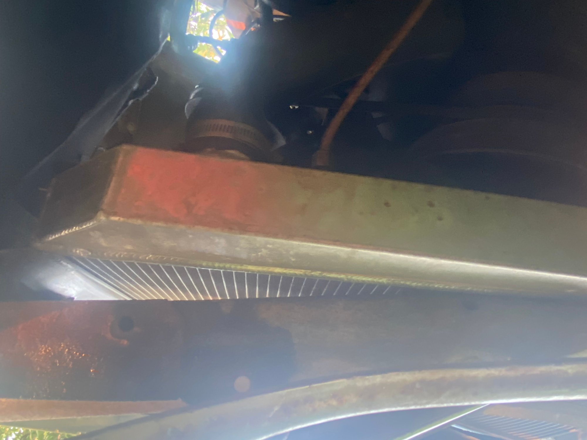

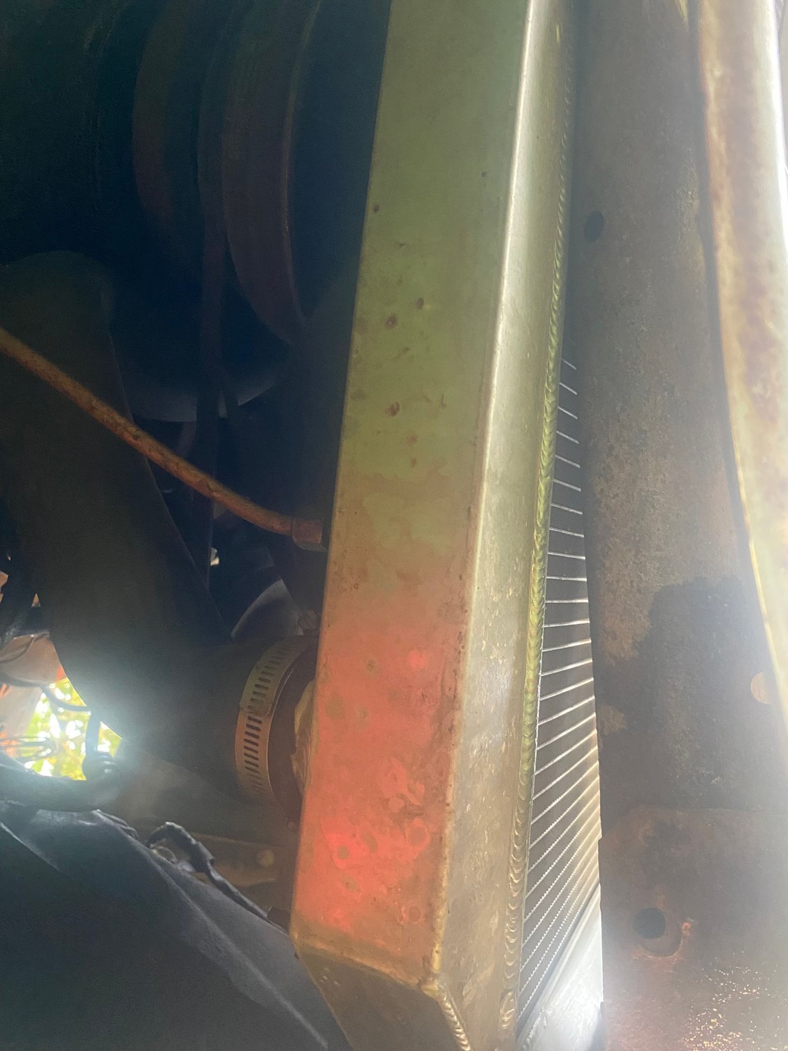

This is where the radiator support is pushed back ,the passenger side frame horn is also folded

I bought a wrecked F-150 years ago knowing that the frame was damaged (see my build for details). Fixing a bent up frame is a royal PITA so check this aspect of your truck before making any major decisions. Remove the bumper, fender and anything else that prevents you from thoroughly evaluating the frame. Inspect the radiator core support closely. If the frame looks OK, measure for squareness because some issues are beyond what the naked eye can perceive. If the frame isn't w/i specs, nothing else will matter.
