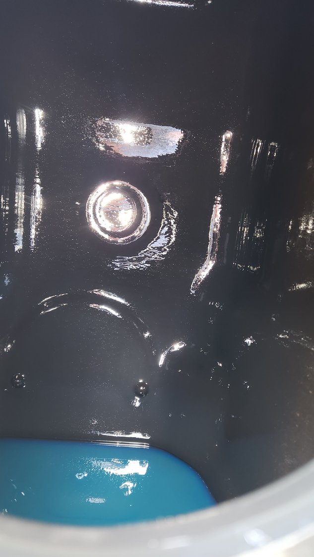

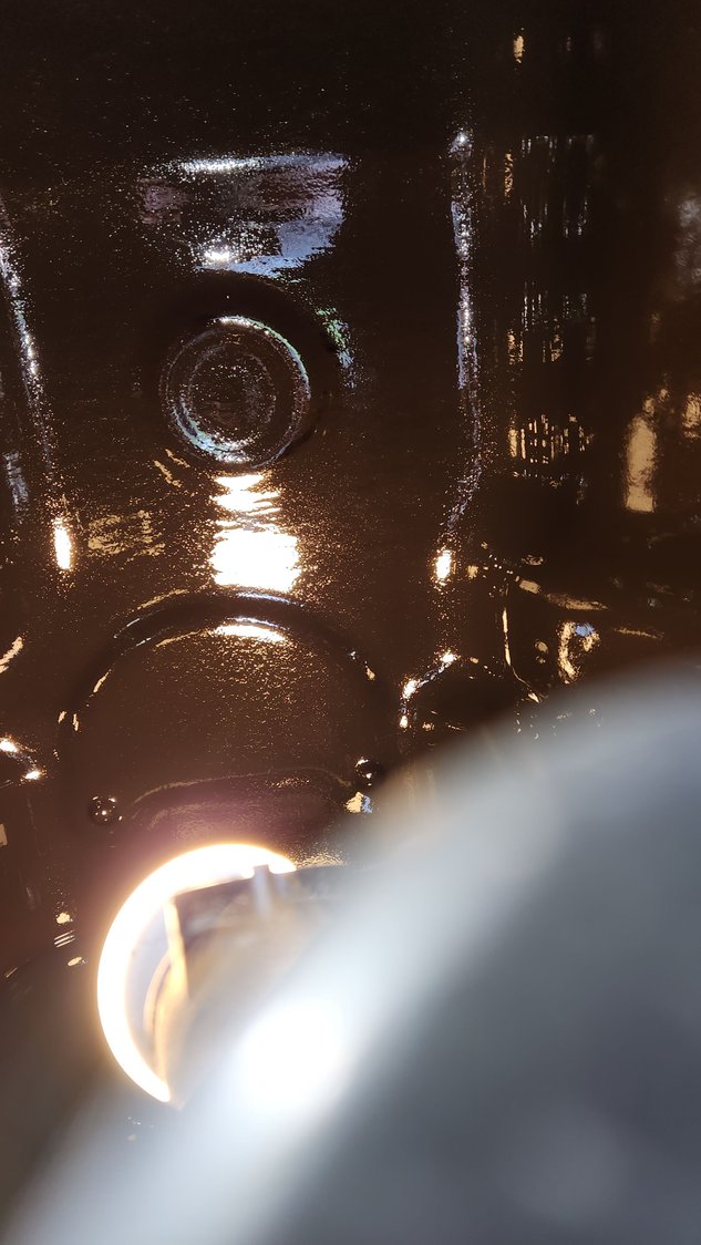

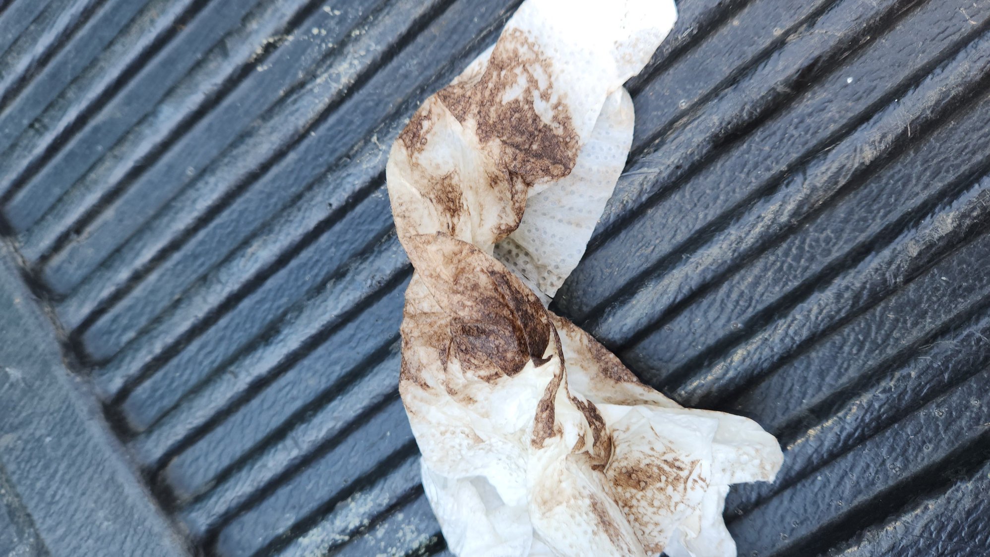

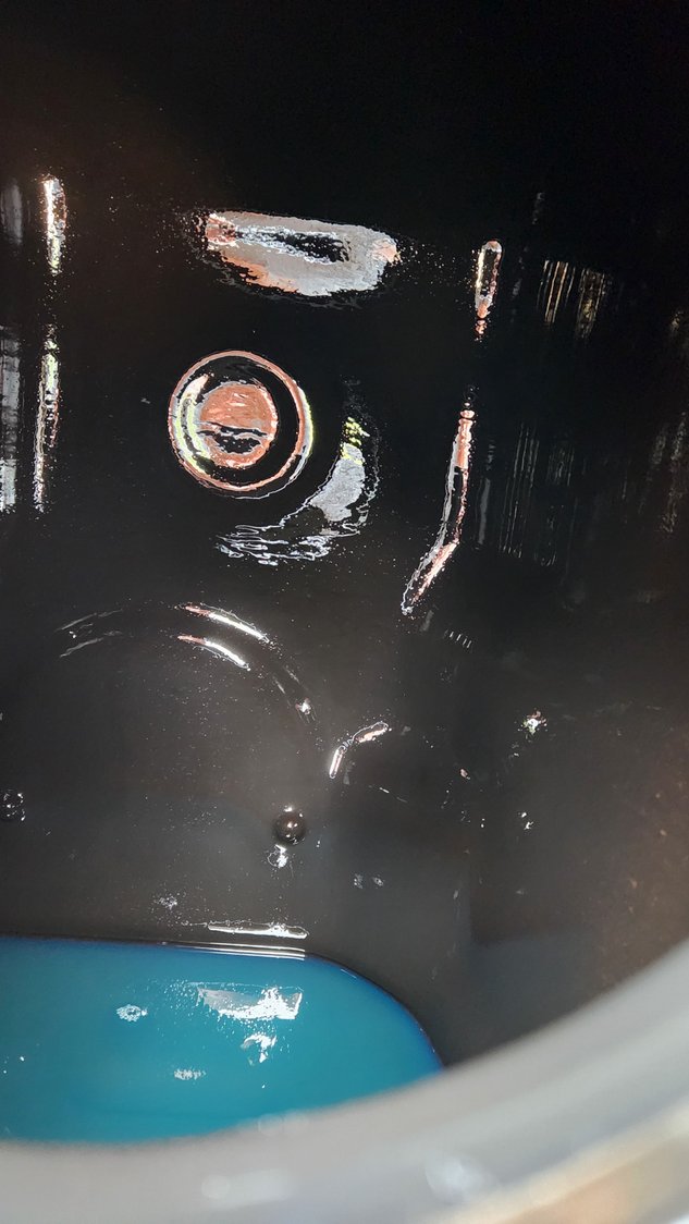

So same problem I've been having. Idle fuel pressure is 60 psi give the skinny pedal a little love and pressure drops. Every time i find a problem it resolves the issue for about a month then slowly returns. Usually find a different source each time. So started at the back droped the tank to check connections on top of tank and my compression fittings in the tank. I noticed what looked like metal flakes lightly spread through the tank. Tired it on its side.and didn't see anything nothing stuck to my magnet.
what I did find looks like rust oil algae? Truck doesnt burn oil or smoke topside filter looks clean noticed some sediment in my pre pump filter but nothing crazy.
any ideas?

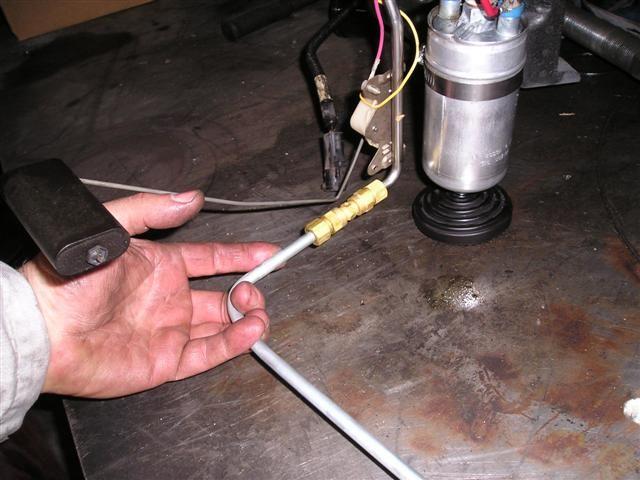

15 years ago, I ELIMINATED any fuel pressure/supply/volume issues by doing this. Still running the same pump. Naysay it all you want, but it's the most effective way to supply fuel to your engine. It's much easier to push a fluid to it's destination than to pull it towards the fuel pump inlet and then try to deliver it.

You always get fuel from a good clean source? That almost looks like burnt oil. I've read that injectors can have some type of internal issue that allows combustion gasses back feed but can't say much more than that. Never actually heard from anyone that's had it happen.
Edit: Oh, and I too let my pump swim in the deep end. It can't suck air if it's in the drink.

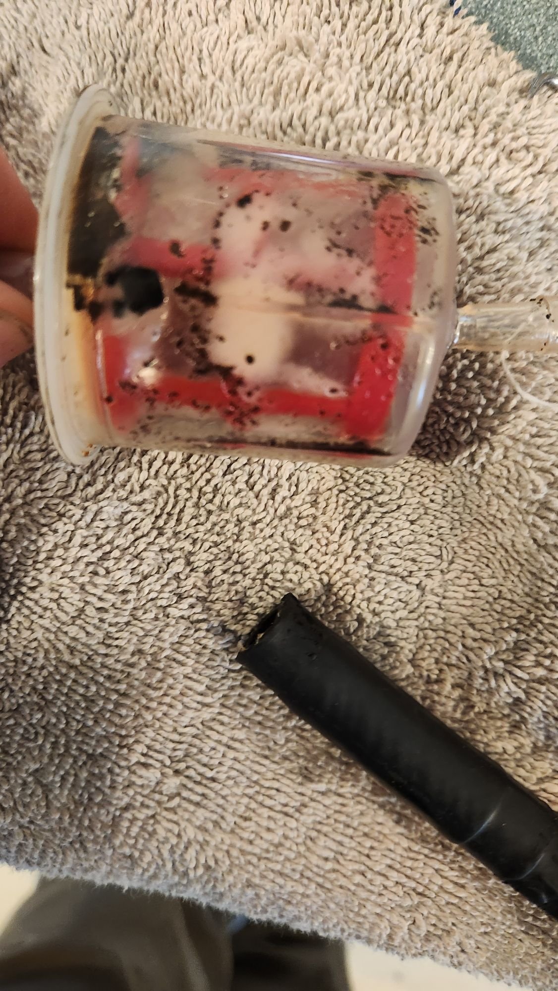

cleaned it up truck ran better , but still has a pressure drop at wot. Checked my pumps flow rate found it lacking and ordered a new bosch pump from clay. Finaly started to look good still had a small pressure drop at wot but only 5 psi from what I understand that is considered normal so I was content. A week later the problem started to slowly return. Getting to the point to where I had to be careful when getting on the freeway to not drop below 45 psi. So at this point frustration is kicking in and I began searching for all the knowledge I could find on trouble shooting our fuel systems. Bought a new inline filter hooked it to about 10ft of fuel line ran it in the tank then plugged it into my fuel pump. Ran down the road no change. Moved to the pressure side. Istuffed paper towels around my fuel bowl and valley then went for a ride. Found a few leaks at the fuel bowl so ordered a kit from clay rebuilt fuel bowl and were good again. Then same thing runs good for a week and then the pressure starts dropping under a load getting worse over time. At this point im scratching my head. I decided to inspect everything from back to front. And when I droped my tank and found it was coated in whatever that is it did not help my confusion. Here is a link to my pre filter mechanical guage on startup and hitting the gas.
this is post filter

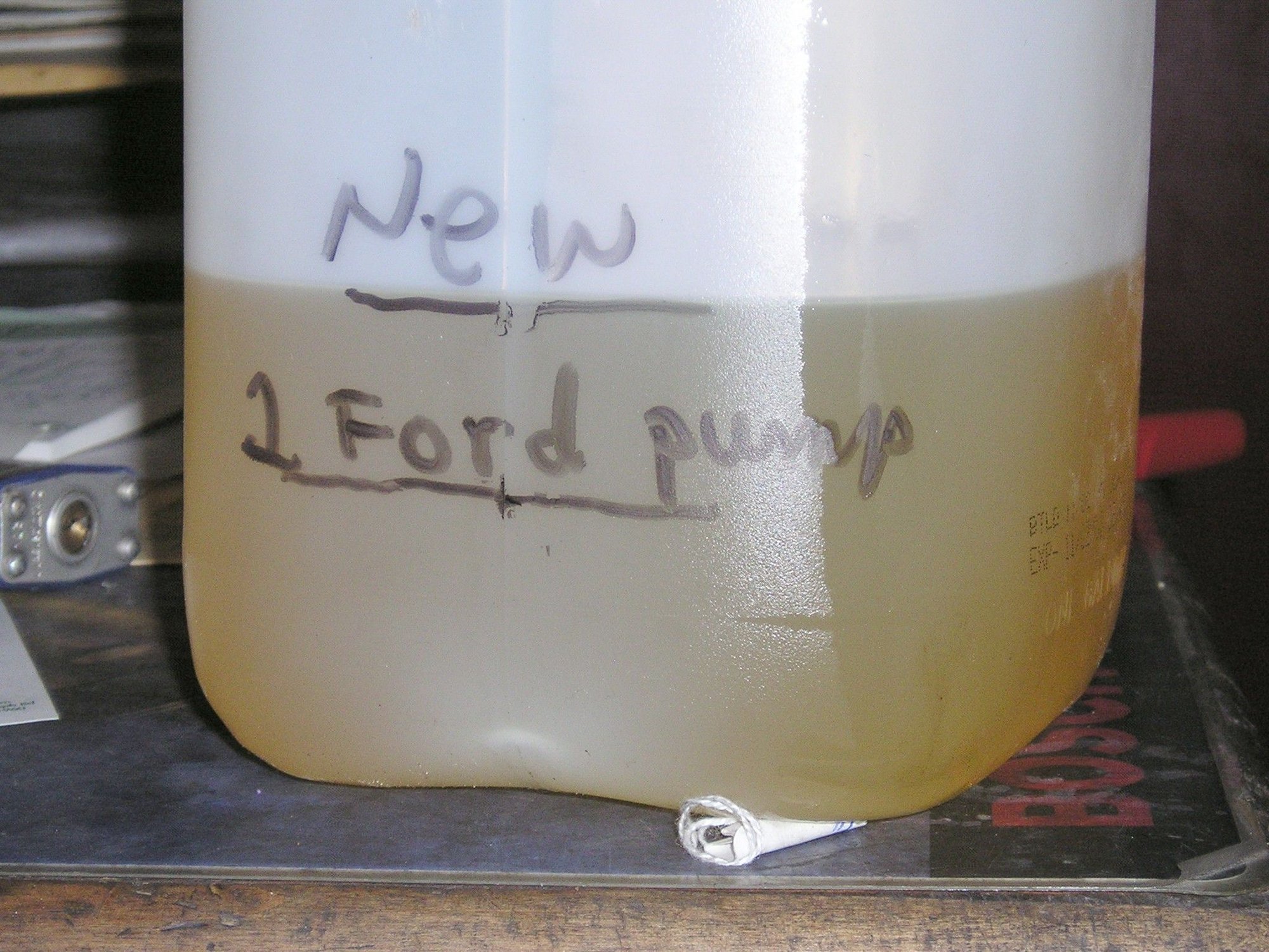

This is what resulted with a 30 second test run back when I did it. One gallon jug in the picture. The "new" pump is the Bosch that I ended up putting in the tank at the bottom of the fuel pickup.
