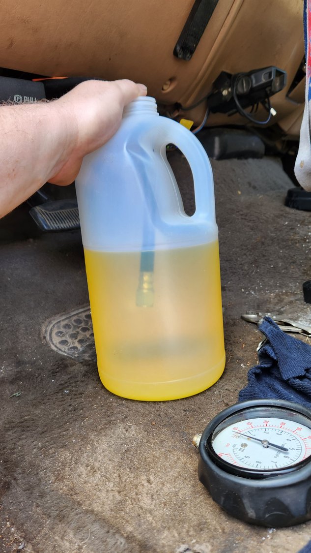

Can you get a pic of a glass jar of fuel? Or what is in the fuel bowl? Just so we can see what the fuel looks like.

I'll have to get a picture of the fuel in the am. This is the best I have for now I know my jug doesn't help much

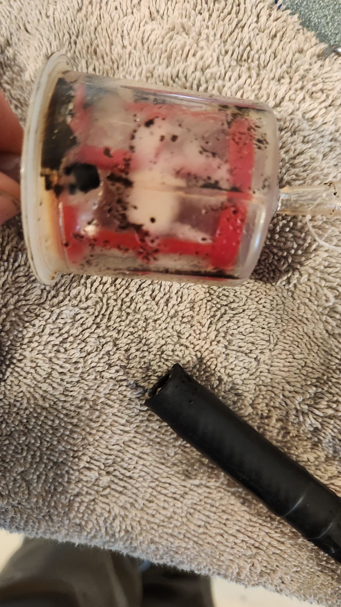

I'd say it's cloudy for sure. Don't see any particulate in it. I left a jar out a while back in a Mason jar and it has since turned dark brown and sealed itself really well. I have some biocide I was thinking about getting an inline fuel filter and hooking my hold pump it and some fuel line and circulating it to clean the fuel in my tank. I'll have to run it down to pressure wash the tank. There is a picture above of how my fuel bowl looked a few months back. I cleaned it and have kept it clean since, I'd say I'm in it atleast every 500 miles or so and a new dark ring has returned at the bottom of the threads. I've been debating piecing together a bowl delete and regulated return kit.

And your are right about me going through alot of fuel filters . This was from when i forst bought the truck and did the hutch mod
then i went through a few inline filters
bought a new fuel pump then noticed the same gunk in my fuel bowl
Then when starting at square one. I found my tank had a nice coating and I'm sure my new pump and fuel lines do aswell
when I do upgrade my fuel system if that is indeed algae I would like to have it undercontrol before hand

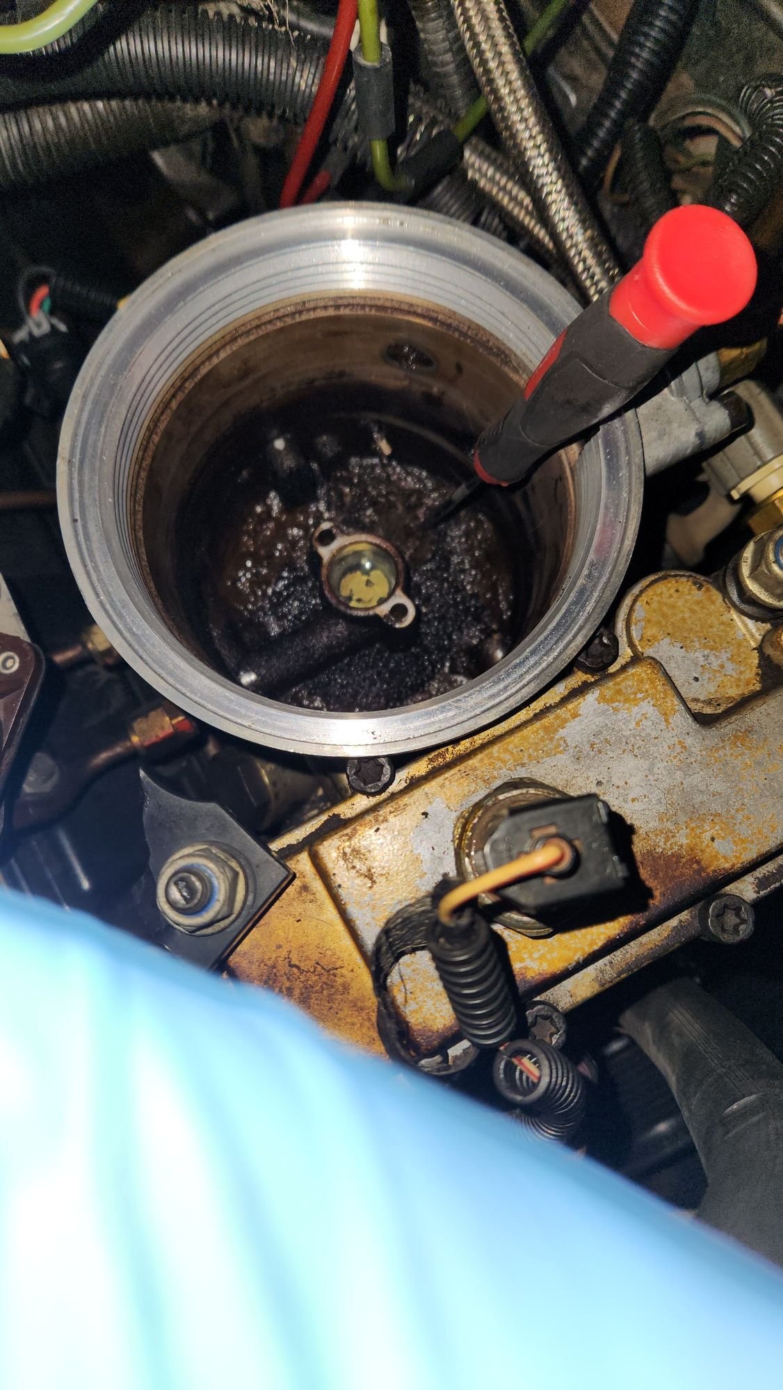

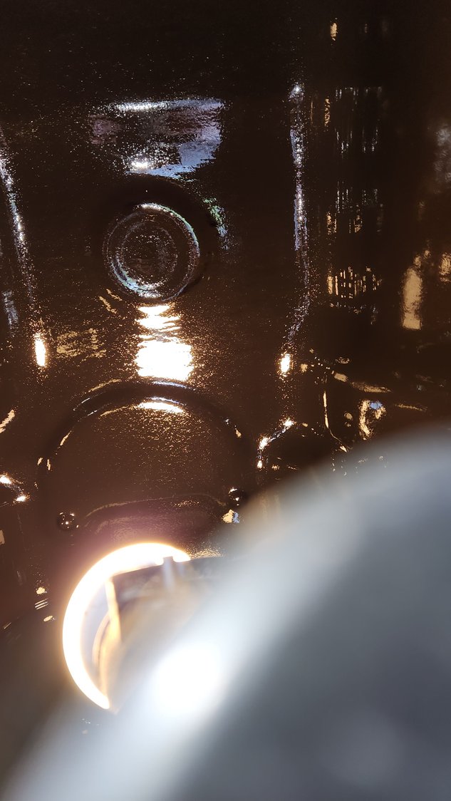

I filled up the other day and put some diesel clear in. Hoping to clean out whatever that Is in my tank.I'm thinking of getting a clear inline filter putting it post pump then hooking into my return so I can circulate my fuel and see what is coming out of my pump. I have another brand new bosch pump but don't want to put it on till my tank gets cleaner
After removing my "leak detectors" I found that my hpop fittings are slightly leaking. I think my rear passenger fuel line could be the source of my leak. I'm not sure if it was wet fluid that was dried by my down pipe or if the blue shop towel just got a little warm. Will attach better and check frequently. I also learned my up pipes have started leaking had some suit on my towel so looks like that will be another project in the near future. I also noticed today that my fuel pressure is also dropping in park and neutral when I rev the engine quickly. It will hold steady if I slowly let it climb. .
