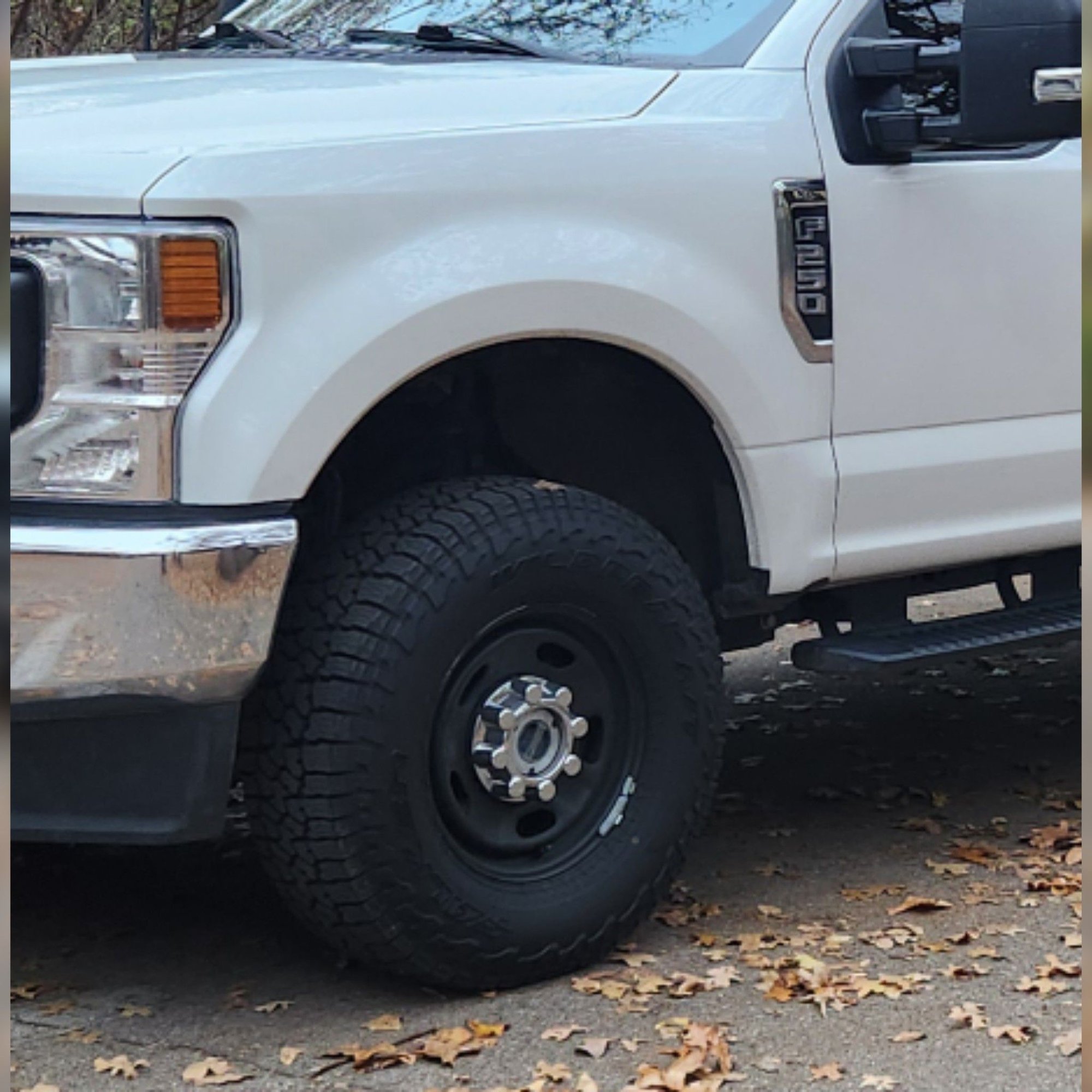

Old Apr 13, 2025 | 10:35 PM
senecagreen's Avatar
senecagreen
Joined: Dec 2024
Posts: 122
Likes: 57
These are 285/75-17 on stock steel wheels. Roughly 34.1 x 11.5 wide
no rubbing
