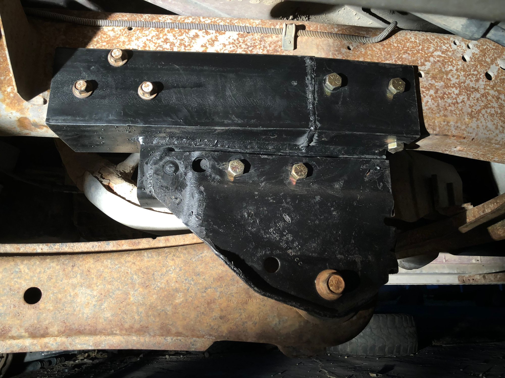

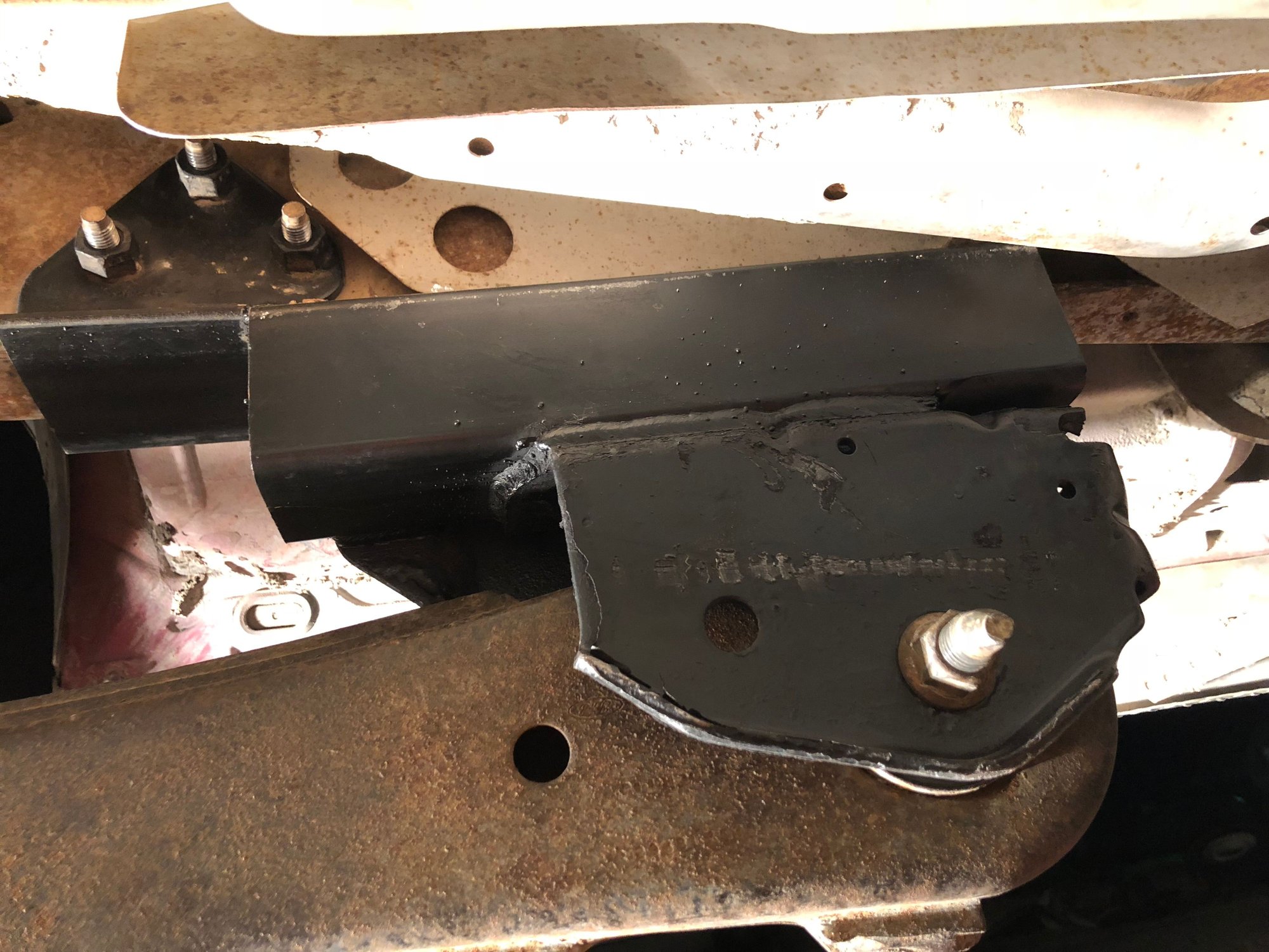

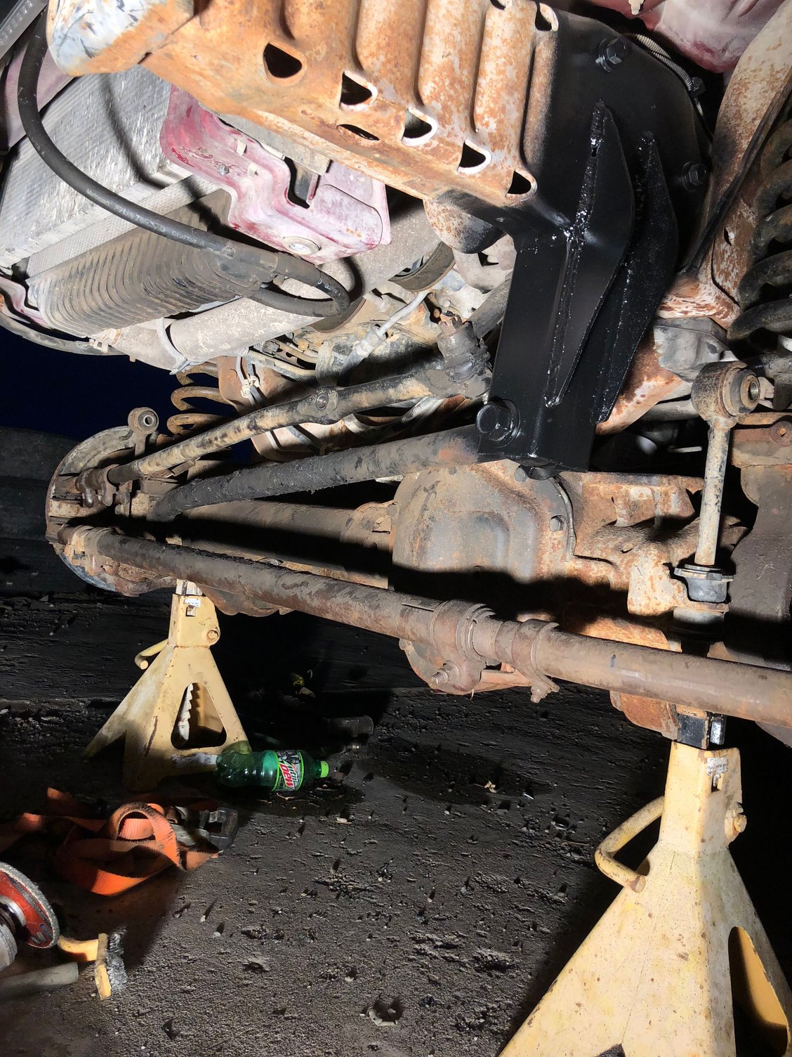

Have to made brackets to bolt the radius arms on, and a track bar bracket.
Thanks for the pictures! I was hoping there was a radius arm swap. I was thinking that would be the easiest, but guess not. Lol
